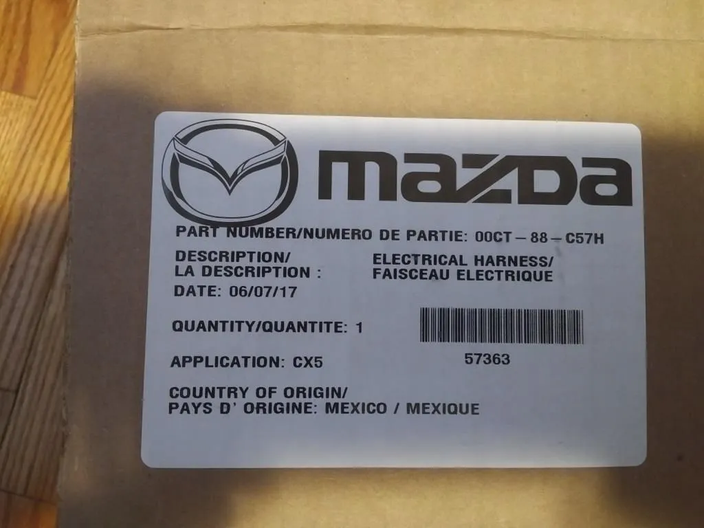

Just spoke to the dealer. There is now a Canadian part number for the OEM harness.
00CT-88-C57H
MSRP $100CAN
I get it for $89, or $180 + tax for it installed (the install also discounted a little because of the wait).

I picked it up today. Dealer helped me out a little more on cost which was nice. Nothing earth shattering but the gesture was appreciated.

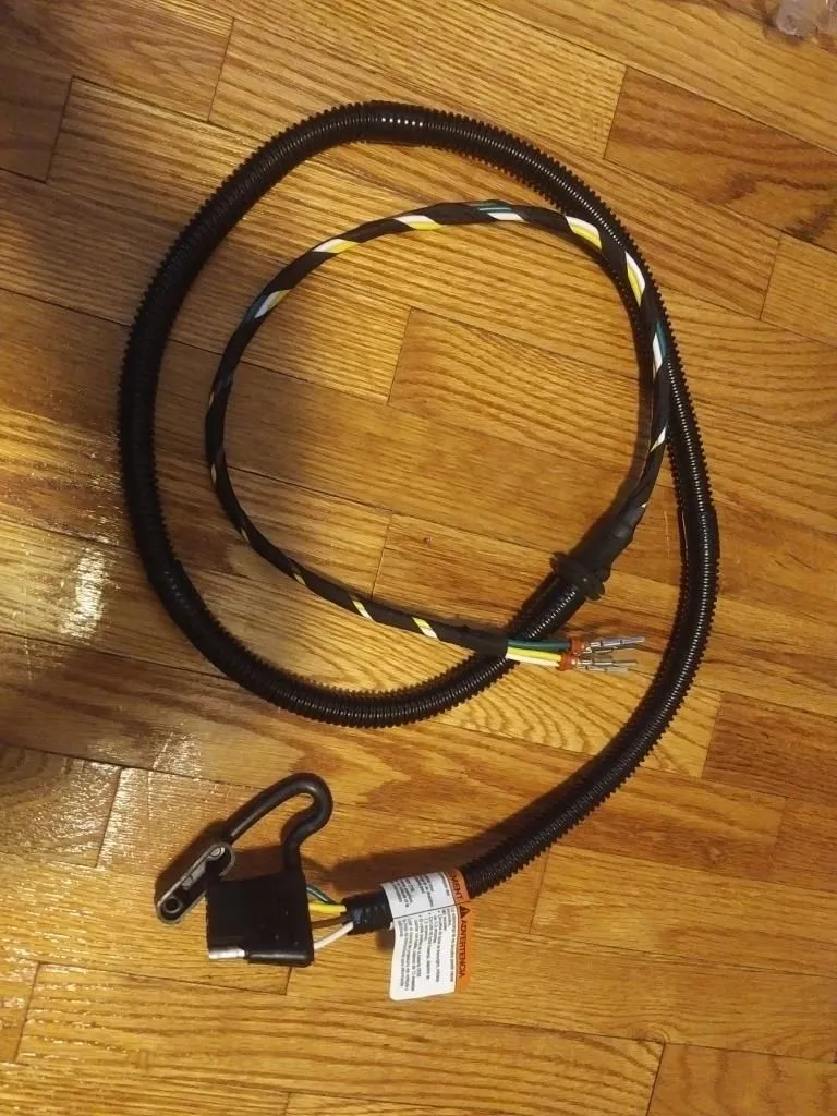

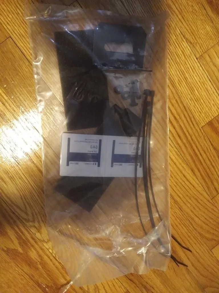

It was a pleasant surprise when I opened the box... It's plug and play except for 1 wire that needs to tap into a harness at the rear and a ground. Nothing to do up front under the hood at all. The harness is very nicely made / OEM quality. Definitely happy I held out for this and well worth the extra couple $.
2 hardest parts will be: getting into the side panels behind the tail lights and tapping into the existing harness connector. That's really the only scary part for me.
Will see how it goes. Going to attempt myself and if I lose confidence will take it back in, they will honor the slight discount on install as well as long as I don't screw anything up and make their job more difficult.
Photos attached because photobucket doesn't work anymore and I haven't signed up anywhere else yet

I almost left the harness inside the left cubby to pull out the hatch when needed but instead I used the harness mount that was included with the kit. Instead of mounting it to the hitch (bracket doesn't exist on the curt hitch like it does the OEM hitch) there are 2 holes in the bottom of the rear bumper support that lined up perfectly with the mounting bracket. I removed 1 plastic push-pin fastener and the bracket bolted right up under the bumper. Pretty happy with how it turned out.
