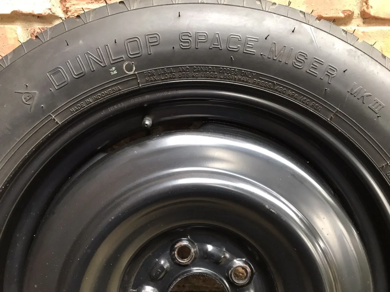

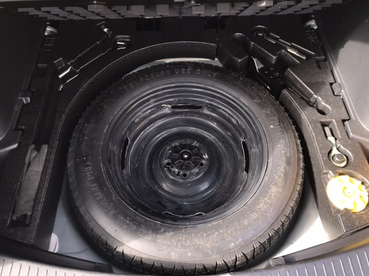

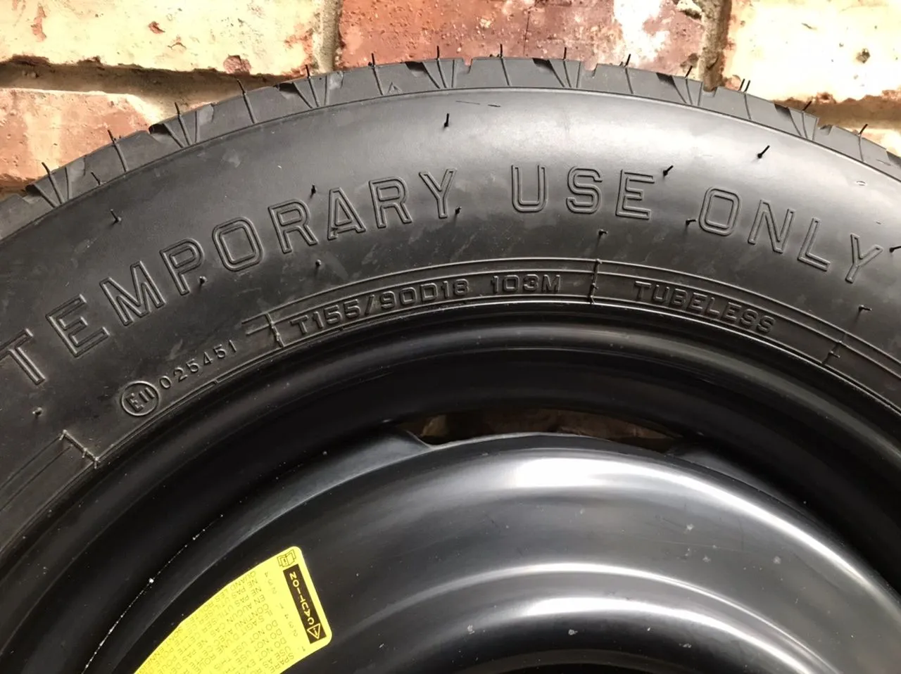

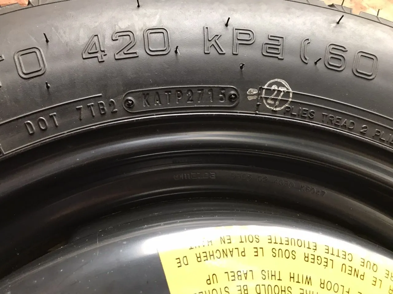

I noticed by accident a 18X4 compact spare steel wheel which is supposed to have Dunlop Space Miser MKIII T155/90D18 103M tire from a 2015 Mazda CX-9 is available on LKQ North Texas website. I immediately located and verified the spare tire and model year, and placed an order. It costs $78 but I have to go and get it by myself. It’s at LKQ Kennedale which is 50 miles away from my house. But I’ve been wanting to have a correct-sized compact spare for my 2016 CX-5 AWD, so that I have no worries damaging my AWD system when I actually have to use it. Hence I decided to drive about 3 hours to get a spare from a newest possible Mazda vehicles for the size. I was a little disappointed when I picked it up as the spare had been used for unknown miles instead of “never been used” claimed by the salesman. It’s dirty apparently it’s been exposed to the elements for a while. The date code is “KATP2715” so it’s newer than the date code “ADT4614” on my current Yokohama Y870B T145/90D16 106M compact spare. Like tomcat1446 said earlier, the size difference is huge. And the 18X4 steel wheel with T155/90D18 103M compact tire is a perfect fit in the trunk for our CX-5.Calculation aside, here's the spec of overall diameter from all OE tires used on Mazda CX-5 and supposed T155/90D18 spare for CX-5 AWD. Dunlop Space Miser T155/90D18 113M tire is the spare found in CX-7 AWD and 1st-gen CX-9 AWD. They're all within reasonable 0.4" tolerance on overall tire diameter.

Good to know that the spare tire on gen-1 CX-9 is mounted under the floor pan. That explains why it’s so dirty. I washed it and waxed it and that’s how it looks right now in the pictures.I thought my old CX9 (1st gen) had the spare mounted under the cargo area floor pan. So it would of been exposed to some dirt and road grime. Not sure if 2015 was different. Sorry, I no longer remember how it was hung (only needed it once in 11 yrs). The rust and cosmetic blems I see on your 18" might be caused by the hanger's friction. So it is entirely possible it has never been driven on.
Yes the mold sprues are on the tread surface, but mostly are on the side tread, not on the center tread. Of course there’re scratches and rusts developed around 5 bolt holes of the steel wheel, that’s the hard evidence that this spare had been mounted and used as a road tire.Yeah - from your pic in the trunk, it looks like the tire mold sprues are still there. They'd be worn off pretty quickly if the tire was used on the road.

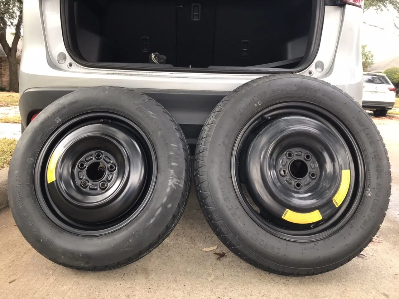

You can't get the 185/70R17 tire available in other countries anywhere in the US. I tried a lot of places and you can't. But I did find a 165/90R17 from Tire Rack that also has the perfect diameter of 28.7". This picture shows the factory tire, the new spare from Tire Rack, and the original spare for comparison. Which spare would you rather use if you were in the middle of nowhere?
Now the best part is that even though it is a much wider and larger diameter tire tire, it will fit in the spare storage area and still keep your floor perfectly flat. Here are pics of the original spare first, and the new, correct size spare second. Bose subwoofer will still fit perfectly.
The only real "mod" you have to do, besides ordering a new spare wheel and tire, is to remove the foam blocks that Mazda installs in the floor board to make up the space created by giving us this incorrect sized tire. So you simply pull off these 2" thick foam pieces in the picture and the rear floor will rest perfectly on the new wider spare.
One final pic of new spare vs original spare.

Unfortunately the link does not work forYou can't get the 185/70R17 tire available in other countries anywhere in the US. I tried a lot of places and you can't. But I did find a 165/90R17 from Tire Rack that also has the perfect diameter of 28.7". This picture shows the factory tire, the new spare from Tire Rack, and the original spare for comparison. Which spare would you rather use if you were in the middle of nowhere?

The factory mini spare size from gen-2 CX-9 is T155/90D17 101M which has <28.0” diameter. It’s still a bit smaller than the CX-5’s 17” / 19” road tires which has 28.5” / 28.9” diameter. I’d find a Dunlop Space Miser MKIII T155/90D18 103M mini spare from a gen-1 CX-9 which has 28.5” diameter. T155/90D18 is also the factory mini spare size for CX-5 AWD once Mazda posted on its website in specification.Unfortunately the link does not work for
