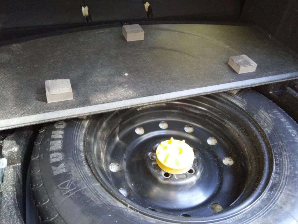

It is just a touch too big for the wheel well even with the blocks removed. I also took out the pad underneath the tire and that got it pretty flush. I have the OEM rigid rubber mat in the back so that stiffened things up too, so all is good. Also, I was able to reuse the regular hold-down spinner, but I had to remove the metal gasket/washer thing that was underneath it. Tire felt snug. Need to drive a bit and see if anything rattles.

Now the best part is that even though it is a much wider and larger diameter tire tire, it will fit in the spare storage area and still keep your floor perfectly flat. Here are pics of the original spare first, and the new, correct size spare second. Bose subwoofer will still fit perfectly.
The only real "mod" you have to do, besides ordering a new spare wheel and tire, is to remove the foam blocks that Mazda installs in the floor board to make up the space created by giving us this incorrect sized tire. So you simply pull off these 2" thick foam pieces in the picture and the rear floor will rest perfectly on the new wider spare.

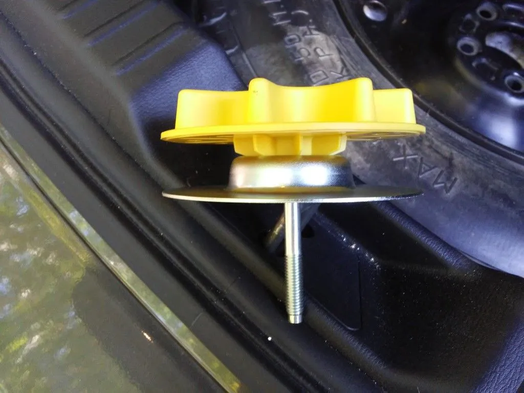

I ended up purchasing a Kia spare as well. Actually, it is off a 2012 Hyundai Santa Fe but it has the Kumho 165/90r17 tire. I did a test mount and verified that the Kia/Hyundai spare fits perfectly on the 2017 CX-5. To store the spare in the well required a couple of mods. First, the hold down bolt was too short (no Bose) so I used the yellow hold down bolt for the alloy rim combined with metal plate from the original hold down as a spacer. See pic. Also, instead of removing the foam blocks, I trimmed 3/4" off the blocks and the cargo floor lies flat and feels supported. See pic with trimmed blocks. Thanks to minnesotaart for coming up with the idea of using a Kia spare and thanks to bigtex for bringing up the issue with the small Mazda spare.

Sorry to drag up an old(ish) thread, but with these pictures, its perfect for my needs. I am looking for the part numbers please for the 2 x rigid foam packing pieces either side of the spare wheel. I am also looking for the part numbers for the bolt that secures thru the Bose subwoofer and the second bolt that is fitted in the righthand packing piece. I am guessing that this second bolt is longer to secure a standard wheel after a puncture? I have searched the usual parts websites online for a 2017 CX-5 but cannot find a schematic for the spare wheel trunk area anywhere. I have noticed that some posters on here have access to the Mazda US parts schematics and am hoping that somebody can post a schematic of this area with part numbers please. Finally, what size are the foam blocks glued to the underside of the floorboard, 2" x 2" x 2"?
Thank you in advance.
Answering my own query here, I got the relevant part numbers; KB7W-68-8MX, KB8A-68-8MX for the packing and 9YA3-00-803, 9YA3-00-805 for the bolts. But there is also an “insulator TK48-56-135A” and I don’t know what it is, suspect it either goes between the sub and the rim or under the wheel itself? Any chance someone with a Grand Touring could take a photo with their sub lifted out of the rim and post it please?
