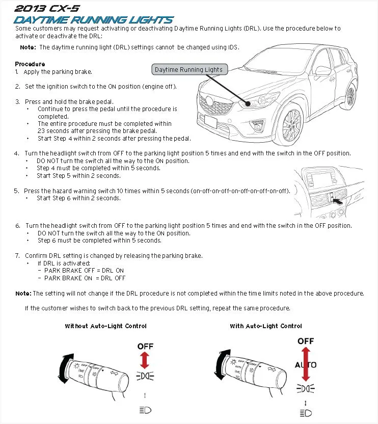

This likely won't help as I believe it turns off both the DRLs and halos. And I'm not even sure if it will work on the 17 CX-5. This procedure works for several Mazda models produced over the past few years.
Yes, it works.
So I experimented a bit, and most of this has been covered already, but I did see one difference compared to other post(s) on this thread:
DRL disabled:
Neither halos or headlights illuminated when switch is OFF or Auto during daylight.
Switch in Parking position turns on tail lights and side marker lights (EDIT: along with halos).
DRL enabled: Both halos and headlights illuminated at all times when moving, even if switch is OFF.
When DRLs are on and switch is OFF or Auto during daylight, switching to On (going "through" Parking, obviously) does make the headlights a little brighter (someone else on this thread reported that they didn't think the brightness changed).
While testing these things, I noticed another "aesthetic annoyance" when DRLs are enabled: If you stop but leave the transmission in gear (stop sign/light, etc.), and move the switch from anything else to OFF, or from On to Auto during daylight, the DRLs (halos and headlights) go off. When you start moving again, they turn on. I realize you normally won't do this, but it seems like if you are going to have DRLs, they should stay on as long as the transmission is not shifted to Park, no matter what you do with the switch. When I had DRLs enabled and was messing with the switch while following another vehicle, they (and the people stopped facing us) probably wondered why I turned my headlights off when I stopped and turned them back on when I started moving ;).
