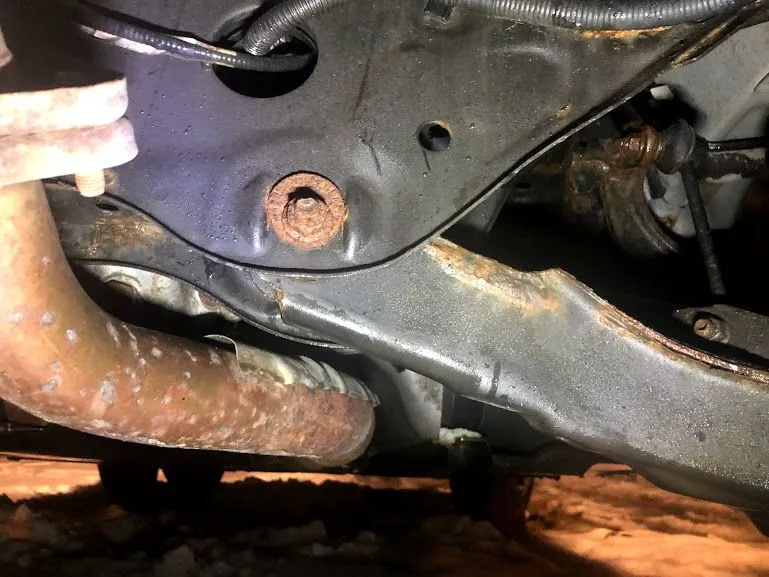

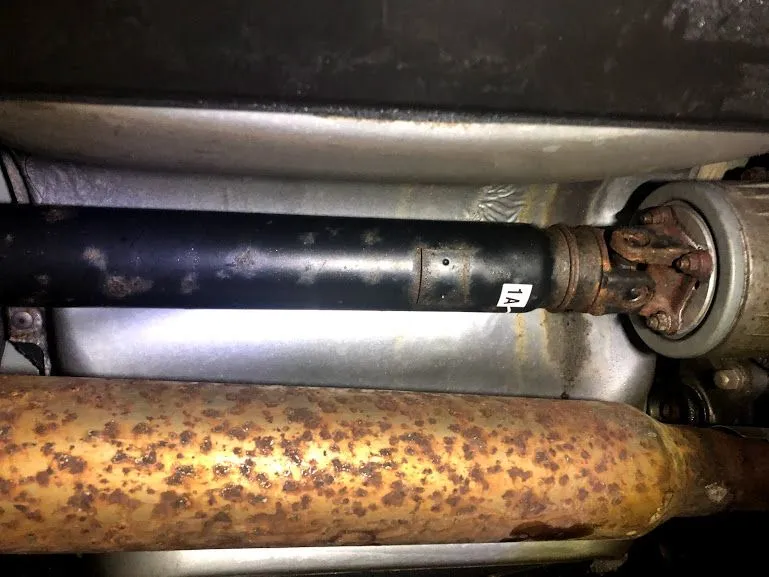

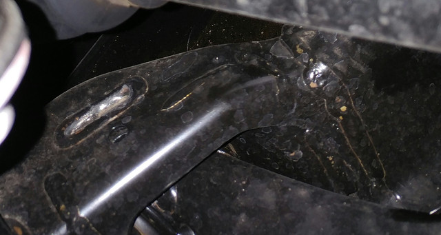

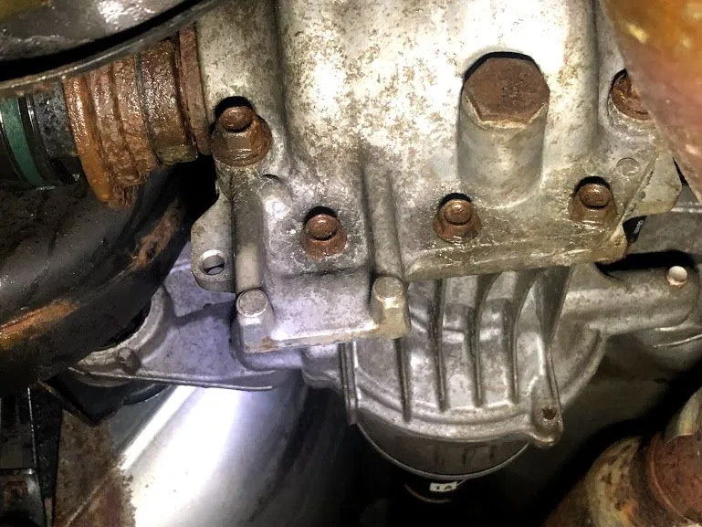

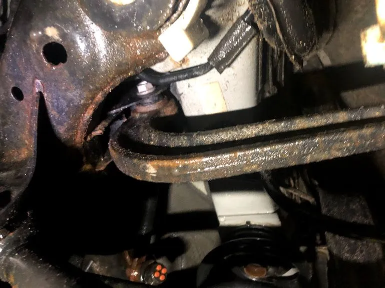

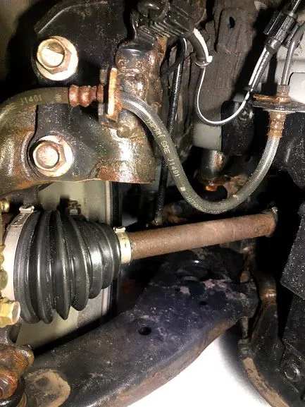

I am new to the forum and wanted some (or all) of your opinions. I recently purchased a 2016 Mazda CX-5 GT used (53k) from a Mazda dealer (it was a lease return) and was told by the dealer that there should be no rust because of how new it was (2016). I took his word for it, its a reliable dealership and purchased the car. Now at home I am crawling all around it and and finding quite a bit of rust that I didnt think possible! I wanted to get this vehicle rust checked ($150 compared to the dealer undercoating of $699) and am now worried that the damage is done and there is no point. To me it looks like surface rust however there looks to be too much for me to repair myself (I am pretty handy when it comes to engines and construction stuff) and I am wondering if anyone else is having or had this issue. I know some of you will say that it is my fault for not looking harder at the dealership but the damage is done, what can I do now? If anything I hope it prompts you to look under your car every once in a while! Thanks!

Actually, it looks pretty good for a 3-4 winter old NYC car to me... Maybe just get the underbody treated with the oil?
Thanks @mazdadude! So you think I should go ahead with some form of rust proofing (fluid film or another oil type)?
-Ross
That's really nothing. I'm just north of you across the lake. I spray our cars with Fluid Film and Crown (see if you have locations in your area). Next year I will try chain and bar oil, it sticks much better.
Any oil undercoating will do in your case. Just stay away from one-time-and-forget (Ziebart) or rubberized stuff. Dripping is good.
Oh, and don't touch the exhaust, unless you like driving around in clouds of smoke :) Yeah, it IS stainless steel...
Thanks @yugrus! I might be getting paranoid over nothing then! I appreciate the input, definitely planning on getting some oil under there asap!
-Ross
That is just minor surface rust, nothing to worry about. When it gets so rusty that you can poke a hole through it, then you have a problem. Fluid film is an excellent product and will drastically slow the rusting process if not stop it altogether. I had my full size, extended cab long bed pickup truck fluid filmed this past fall for $150. I may have my dad's CX-5 done next year.
Worth noting, my 2015 Subaru Outback is one year older and has twice as many miles as my dad's 2016 Mazda CX-5 and it is not as rusty underneath as the CX-5. The CX-5 still isn't bad, it looks about the same as yours, Ross. Though it seems the Subaru has held up a little better to the corrosive brine and road salt.

Both ends of the drive shaft are prone to rust. And the bolts holding two back brackets in the back. I was back under my car hitting spots with fluid film. My neighbor must think I'm crazy lol. The thing is, rarely will I have a nice shiney undercarriage with little rust and I want to prolong it. Nature ends up winning in the end, but for now I am crawling under my car with a paper towel and a can of fluid film once a month or so.

Was under my car this afternoon looking for rust. I found no new rust but sprayed a little more film on parts. Mazda really should use a better coating over undercarriage welds instead of just the paint that everything else is painted with. Anywho, so far so good. CX-5 is a pretty good car.
