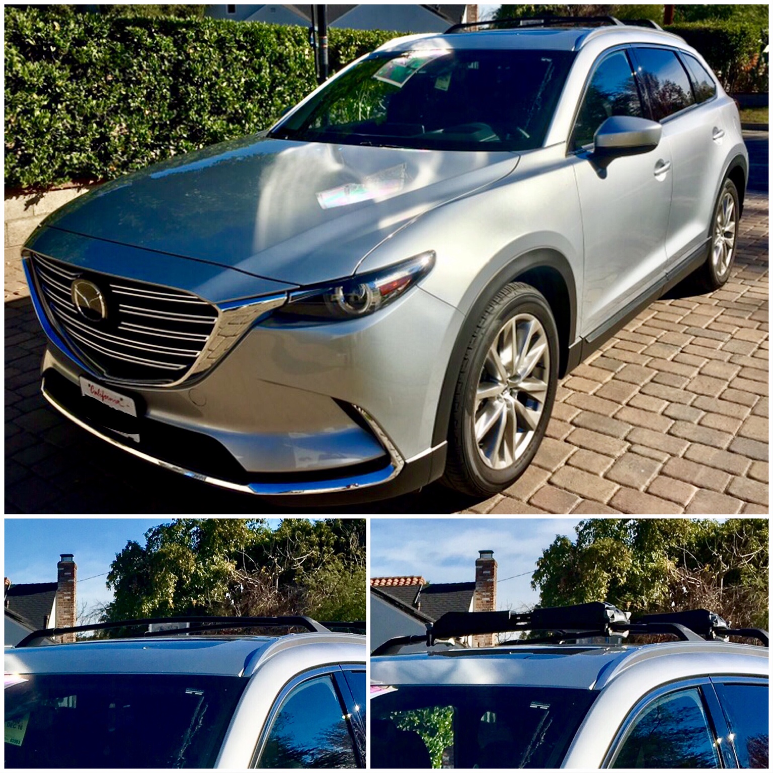

Anyone else install the crossbars for the 2016 CX 9 GT?
I just did, it was a PITA. The bolts were inaccessible even with a u-joint socket as recommended by the instructions. I ended up unbolting the side rails so I can tighten the crossbars, then reinstalling the side rails. Unfortunately the bolts they used for the rails were soft AF and I ended up stripping 2 and had to drill one out. Also the tension from the crossbars made it hard to properly align the side rails.
Anyone else had the same experience?
so after sleeping on it, I decided to do a quick inspection of what I did last night. I have a feeling the rails are not correctly aligned because of the tenstion from the crossbars.
can someone do me a favor please and take a close up picture of the where the rail meets the roof? is it totally flush or can you partially see under the rails like the raised part where the bolts go?
I'm contemplating unbolting and reinstalling everything. I will need new bolts for the rails though since they strip easy.
This is what I meant when I said I might not have been able to position my rails correctly. As you guys can see from the images below, there's a slight gap between the rail and the car's roof. Can any one confirm for me if this is normal or not? Thanks
Though it's kinda hard to see in these pics, I checked it closely and there is no gap like yours.
I plan to install my cross bars this weekend.
No gap like yours. I thought it was pretty simple when I installed mine. Took no more than. 15 minutes
Mine was a relative easy install as well. I did have it backwards at 1st. FR & RR is on the passenger side. I as well did not have the tool in the instructions but the hex tool that came with the cross bars worked fine. Just had to do it slow
damn I guess that's what I get for following the instructions to the 'T' without consulting the internet first (yes)
I will take it apart and redo. thanks for the help guys
