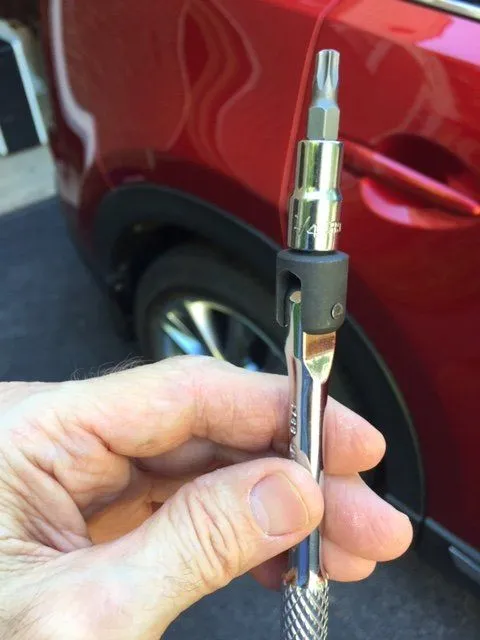

I installed the Mazda crossbars today. Double checked the side (L/R) and front/rear markings on the crossbars. Using the tool that came with the crossbars, it took about 30 minutes. Be sure to lay down a rag on the car while you're tightening the bolts or you'll scratch the paint. This is the setup I used to give the bolts the final torque.

One can look for the shortest T30 bit in the rack and perhaps grind the end of the bit shorter, no longer than needed for full engagement. If you use a grinder, keep the bit cool by dipping it into water frequently; don't let it get hot and soften the steel.
