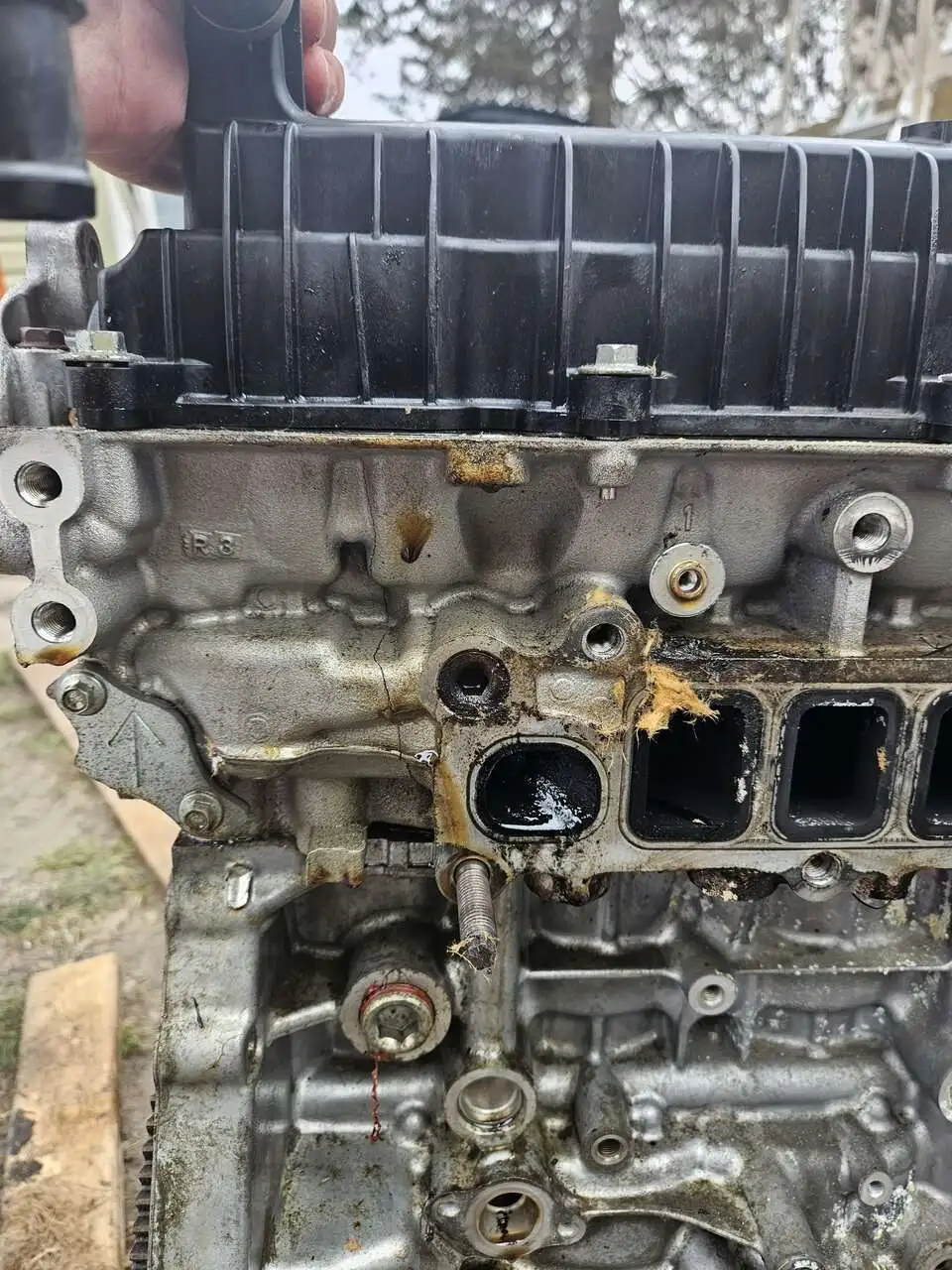

Another update.

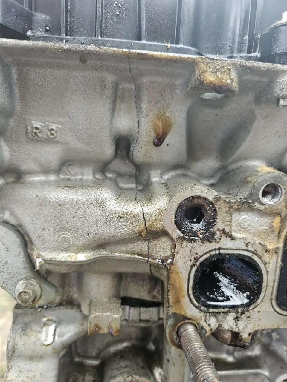

Here are some pictures.
The old head split in half. You cant even call this a crack.

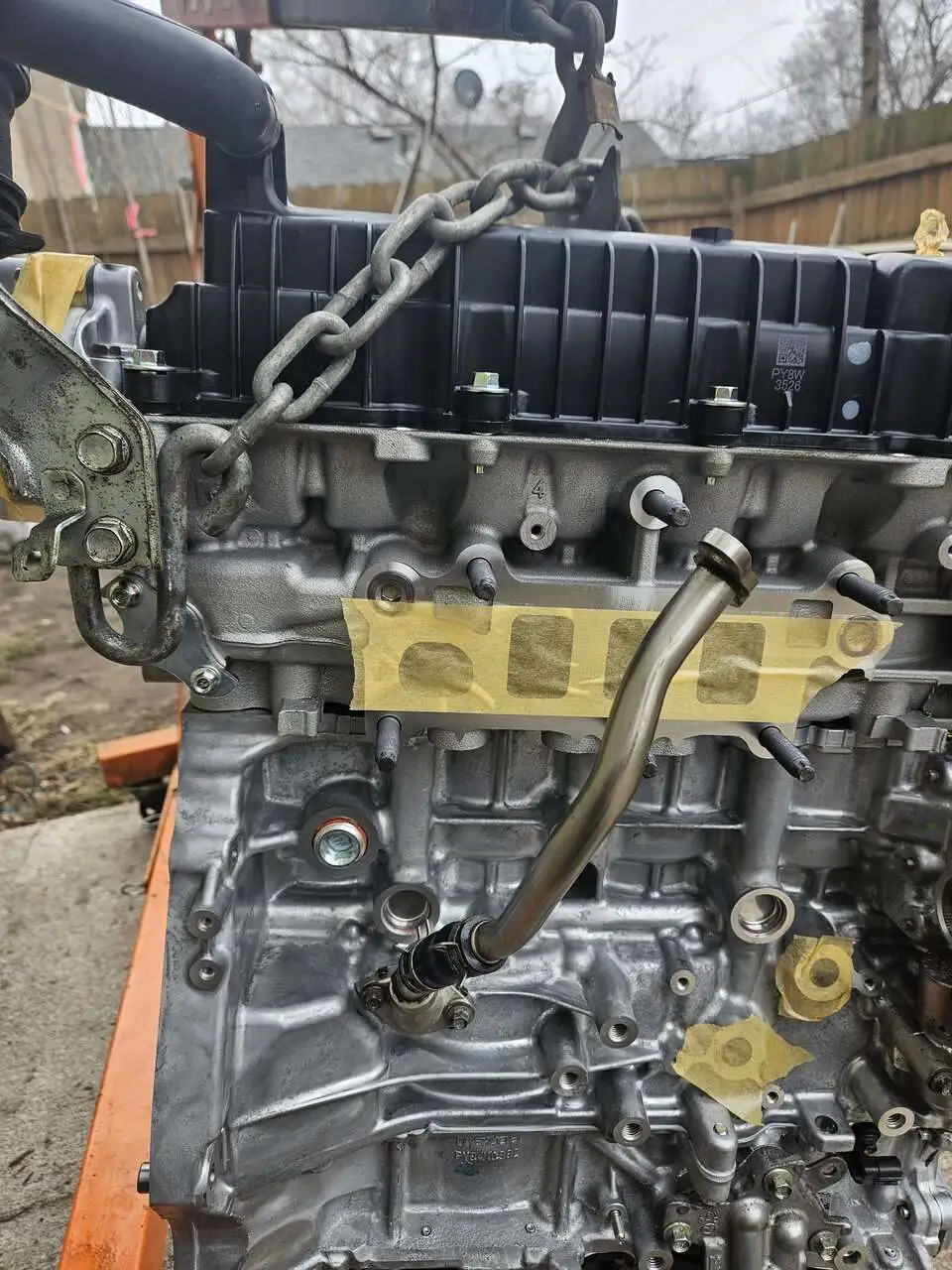

I added a picture of new engine head. I don't see any structural changes from the outside when compared to the old head.

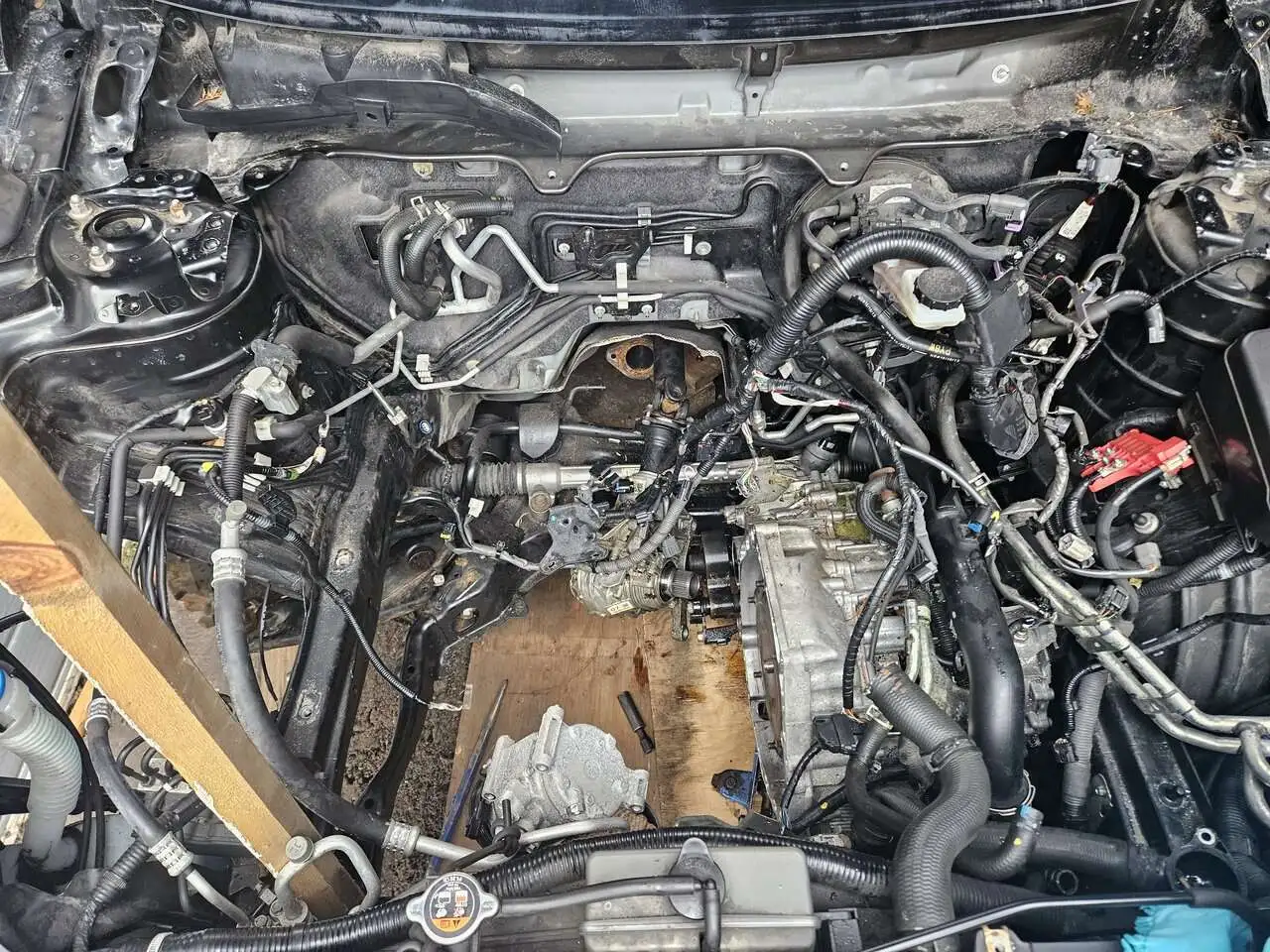

Last picture is an empty engine bay. No need to pull the trans.
The engine installion is moving forword well.

Update:
The car engine is installed, and the car is running well. Here is the cost breakdown of the whole project. I was considering an engine rebuild (head replacement at $750), but it would have taken one to two months more due to my work schedule. I plan on rebuilding the old engine at a later date.

It is a shame that Mazda will not take responsibility for the factory defect. Most likely, this is an issue with the heat distribution (how the head is cooling) or improper aluminum casting aging. This is why they redesigned the gaskets and there is no structural changes to the new heads.

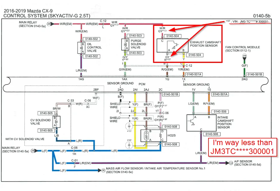

My car doesn't have an exhaust CMP which makes me wonder why I get a P0365. According to the wiring diagram the exhaust CMP was added many thousands of SNs after my car. Anyways, I pulled the intake CMP to inspect for debris and it was fine, I even hooked it up to an oscilloscope and the signal matches the reference wave pattern shown on the troubleshooting guide from Mazda.

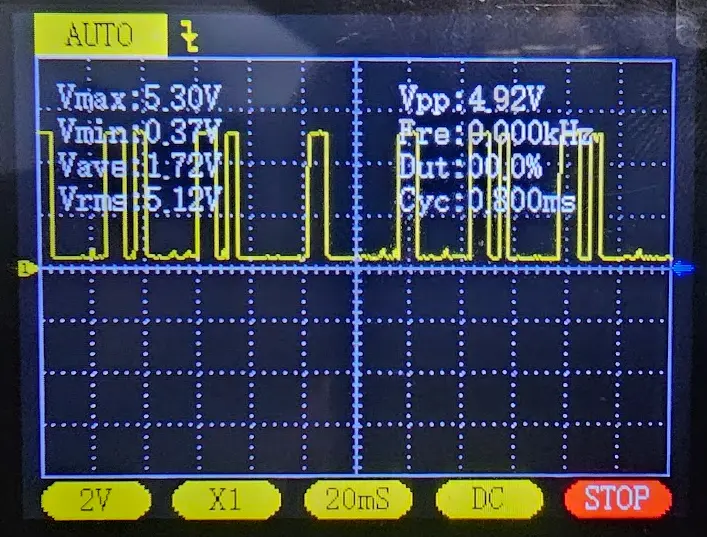

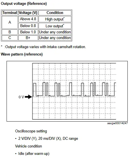

My next steps are pulling the crankshaft position sensor to inspect for debris and then I plan to hook it up to the oscilloscope to look at its wave pattern too. I'm not sure why it shows up as P0017 in my scanner. According to the Mazda manual it should be P0335.
