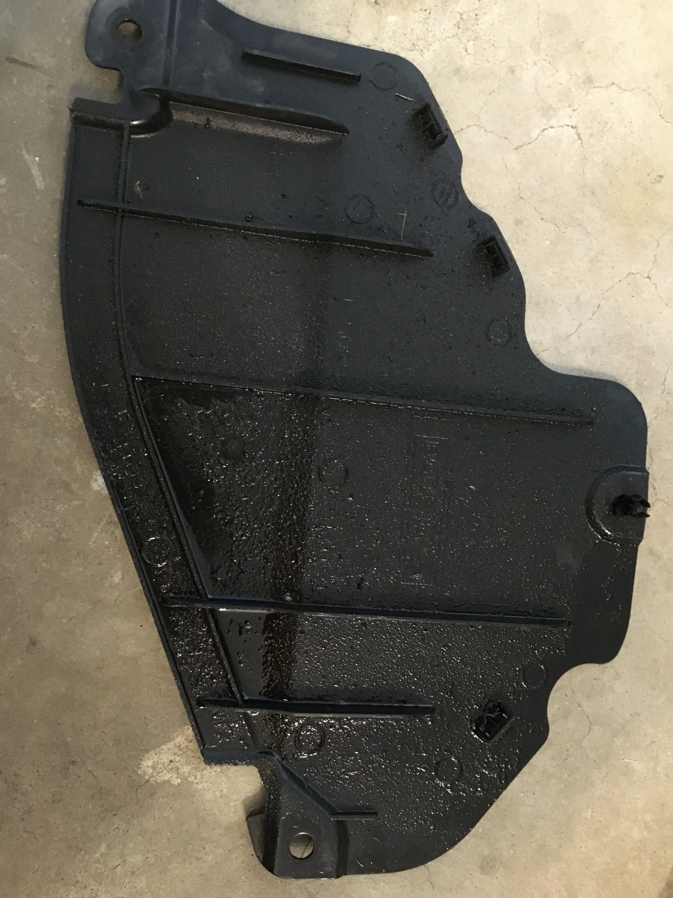

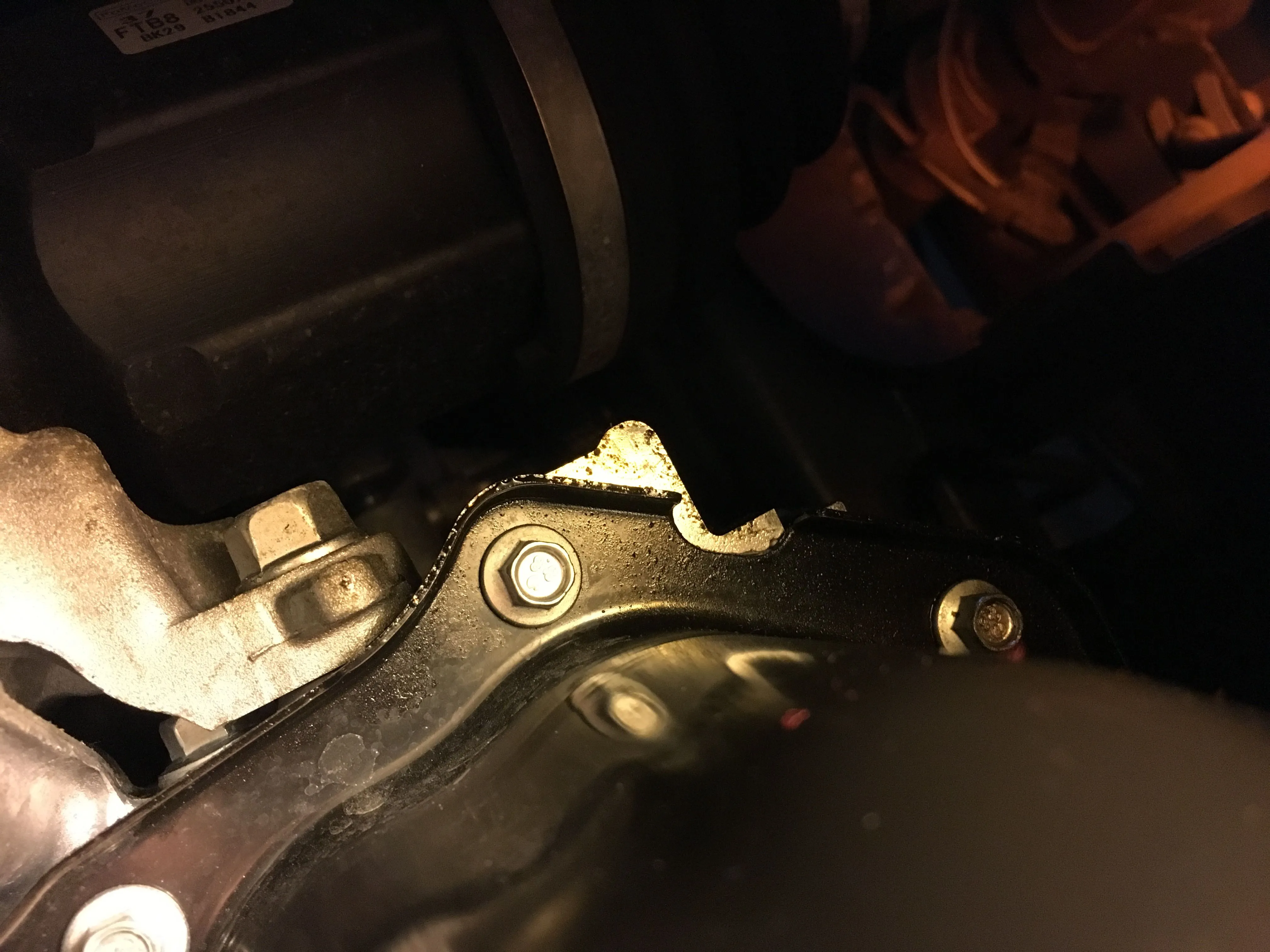

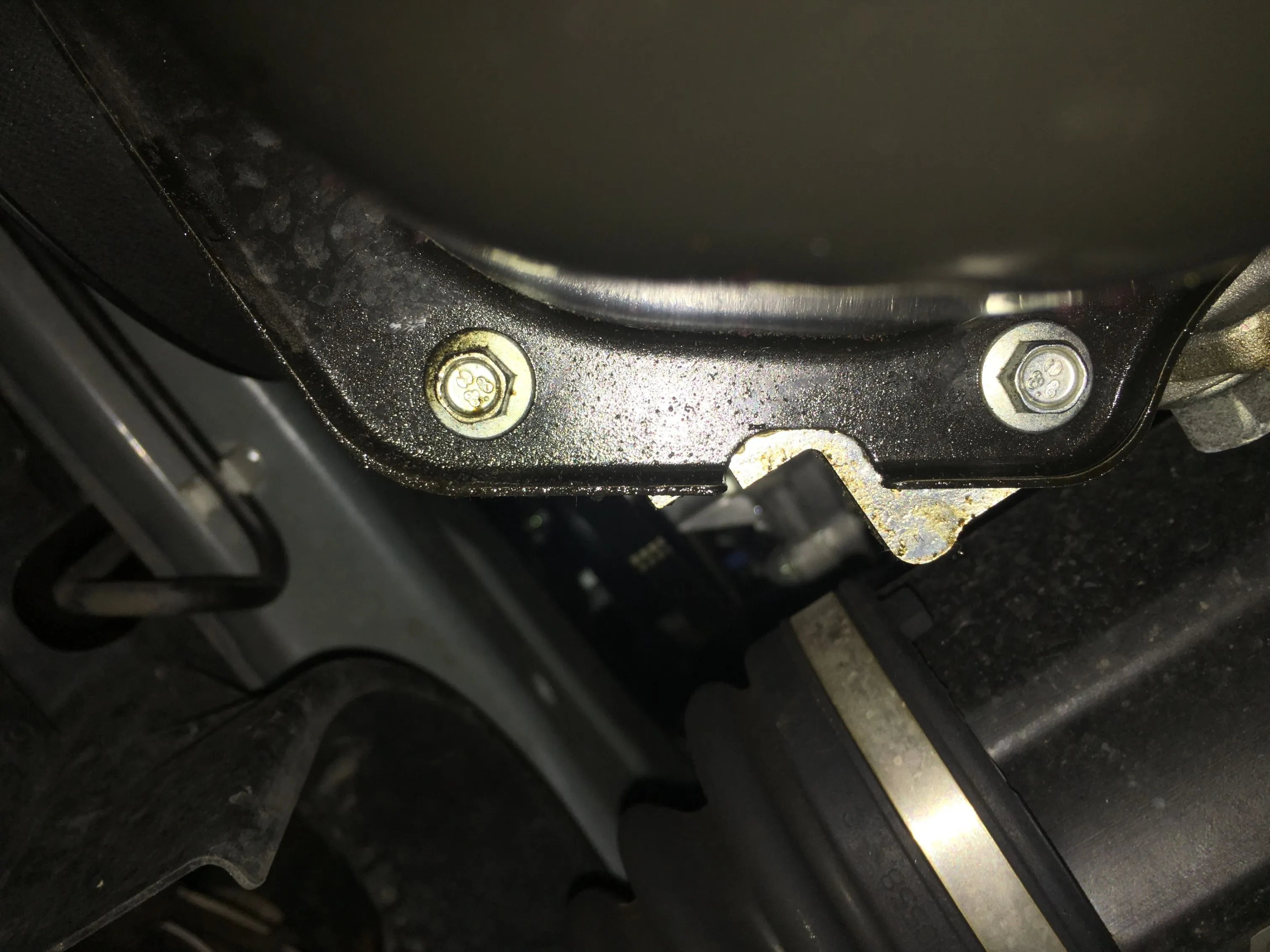

Took the cover off - I think I found the culprit -
I think the oil pan gasket is failing - the entire outside rim is dry except the front passenger corner which is fairly wet with oil. The plug and filter looked OK from my view.
Could be something above flowing down to that point?
Front part of splash shield may be all that is needed... I would probably drop the whole thing though.
I looked all around and everything looked pretty dry from what I could see - the only part that was wet was in that one area.
I didn't want to wipe the plastic cover (or around the pan) clean for fear the dealer may just send me home from not having any evidence.

Maybe some one missed the oil fill hole on the last oil change and it took a while to run down. When's the last time oil was added?

Very likely. Or could be the front crankshaft bearing seal is leaking but that is rare. Dealer should clean up the area first then wait and see.
Agree. Only check oil level and let the dealer service dept. do any warranty work. Don't fret about possible worse case scenarios. Ed
Thanks - Yes, I lowered the cover to take a look, but didn't really touch anything and put the cover full of oil back on.

Dealer came back and said the oil fill plug gasket wasn't seated right when they did the last service and did a complimentary oil change.
