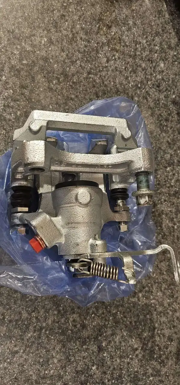

2015 CX-5 Rear Caliper bracket bolt bigger than hole
I have a 2015 Mazda CX-5 AWD. I replaced the rear pads and discs about 2 years ago and they are already used up so something might be wrong with the caliper. I went to replace the caliper today and bought a replacement but the bracket bolts are bigger than the hole on the replacement. I went to another store and I'm seeing the same size. What is going on here? I bought the car used and it had about 30-35k. If I get the smaller bolts is that going to be a problem since the holes on the hub assembly are bigger? I'm so confused right now.

I mean that would work but I want to replace the whole caliper. They look the same but why would my car have bigger bolts? To clarify, I live in Michigan so any time I can replace rusty parts the better. I don't want to reuse the rusty bracket, I want to know if there would be any reason for this. It's the same bolts on both sides so it's not some weird fix.
I'm assuming that you've confirmed the part numbers are correct for your vehicle, which means that the part companies are including brackets with bolt holes that are too small. And it's possible that most people who buy these same parts just swap the brackets, and never bother to complain about the mistake.
If you're intent on installing new ones, you might want to check an OEM bracket at your local Mazda to see if they have it correct or not. Then, if the Mazda brackets have the correct size bolt hole, and you don't want to pay OEM prices, try the Rockauto help line to see if they can sort this out for you.
But in any case, I'd advise against switching to smaller bolts, because the close fit is by design, and is virtually certain to be very important to the integrity of the system.

I figured so much that I didn't want to go with a smaller bolt. I thought about ordering just the bolts from RockAuto to see if they are the same size or not.
I ended up just putting new pads and rotors on for now and I'm going to watch it. I guess these cars have back brake issues.
I went to two different stores and brought the bolts and they didn't fit at either store so I assume the part numbers are correct. I also checked the part number on RockAuto and it matched up.

I went to Advanced or maybe Auto Zone. They look the same. I also went to a more local company. Both had smaller holes on the calipers.

I went to two different companies in town and they both had the smaller hole.

Thanks for the suggestions everyone. I'm not crazy though and the holes are different sizes. I stumped the parts supply people for sure.

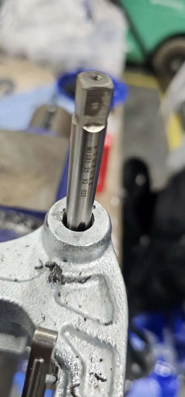

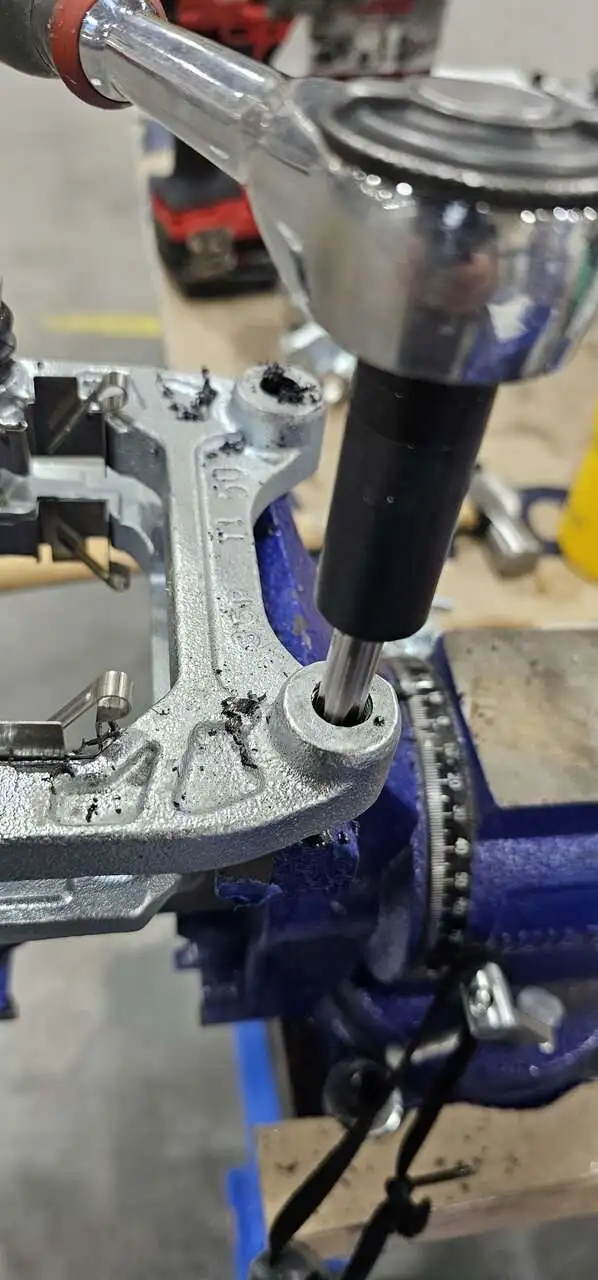

It is done. Problem solved. My factory bolts now fit just fine.
"We'll make it fit!"
