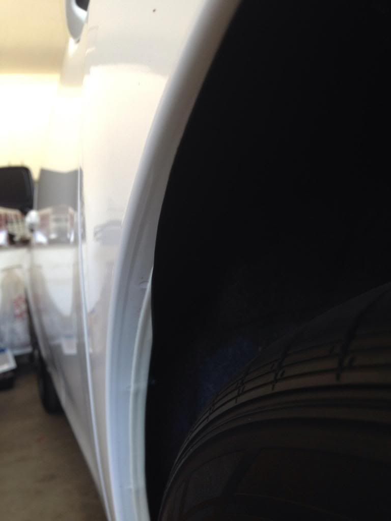

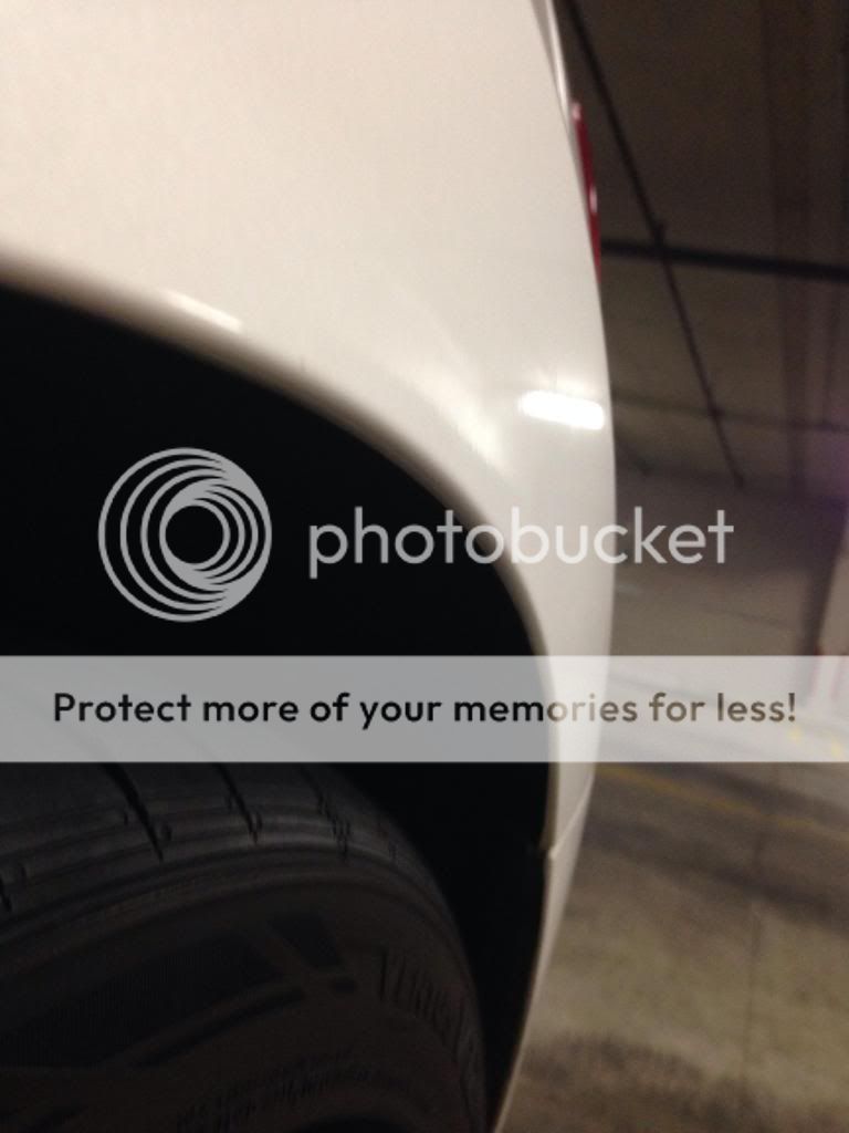

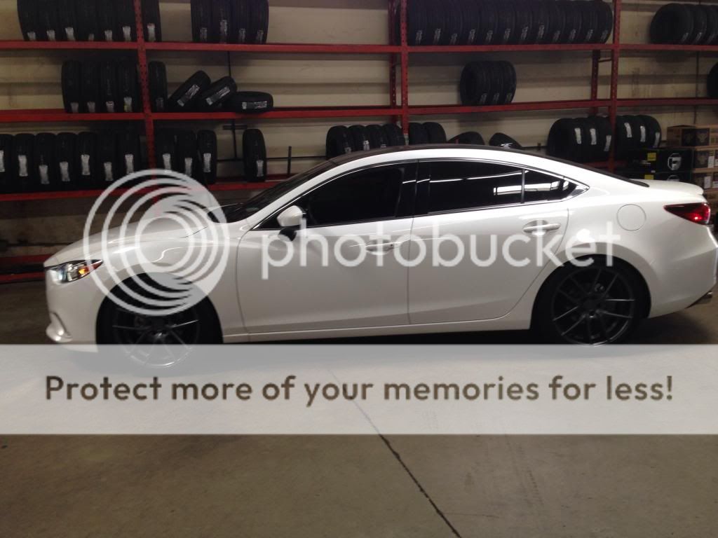

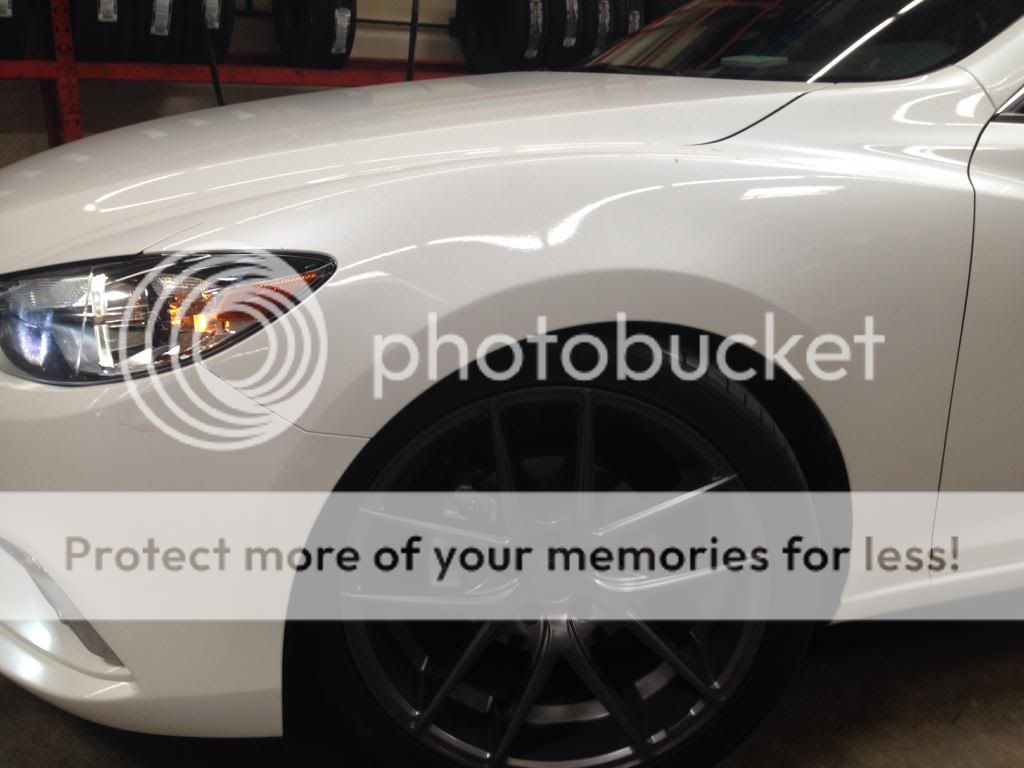

Funny you asked. It's been since September '13 since my last mod(exhaust) and after a year of enjoying the stock height, the lowering bug finally bit me! It all started last month when I tried to roll my own fender using an Eastwood fender finisher...now I know why they call it a fender finisher:( After putting a welt in the driver rear fender, I decided to get my fender professionally rolled. I went to my local detail place and called a few painless dent removers and they all said I had to live with the dent:( I didn't give up...a heat gun and 2 cans of condensed air, you can barely even find the once 3 inch crease on the fender...it worked! After hours of searching the interwebs...I came across Tony. His name was mention by so many people in the car community that I called. Tony is Fender Rolled by Tony in Granada Hills, CA. I made an appointment last Thursday and in 1 hour, Tony advised on a fender shave because I DID NOT want to pull my fender or stretch it out. A professional hub mounted roller uses pressure ti roll the fender and it pushes it out a bit. Tony has been doing this for years and has done thousands(no joke) of cars. I almost fainted when he to a cutting wheel to my fender but he was precise and he knew exactly where to cut, how much to leave, and what to cut out. Pm me if you want his number. Thank you, Tony, you are the man!

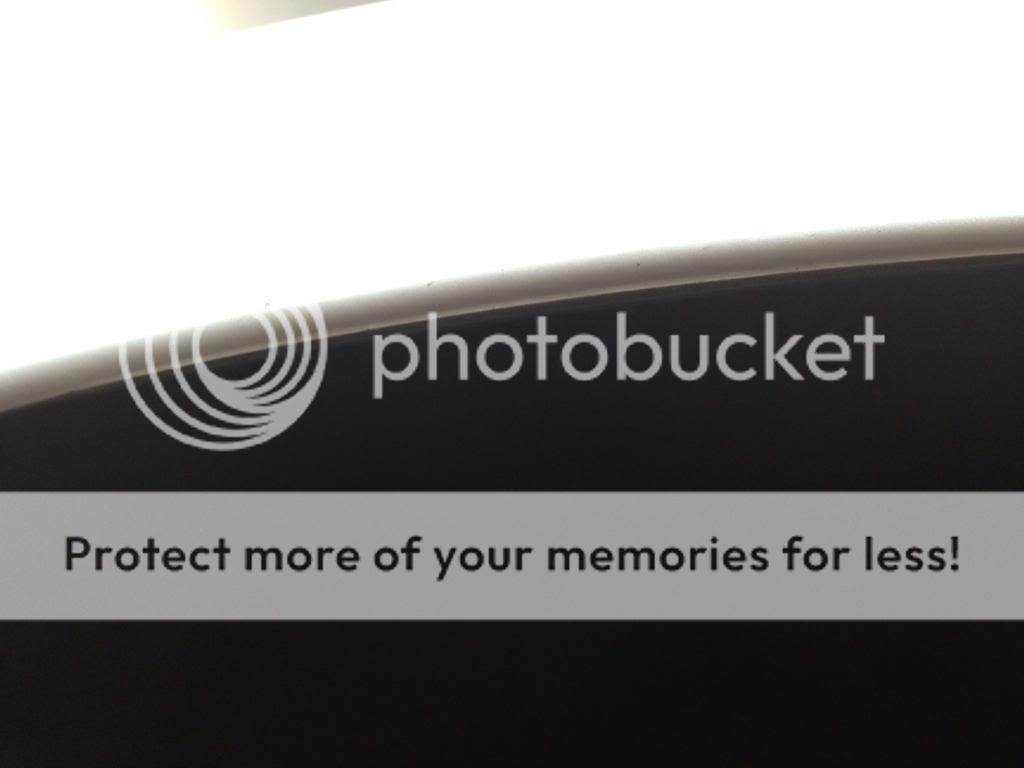

Tony took 30 minutes on each side, 1 clean cut, no measurements or marking, sanded to a fine OEM finish and feel, and symmetrical on both sides...impressive!
I ordered H&R springs on Friday from Grand Prix Tires in Monterey Park and made an appointment for Monday for install and alignment.
Right off the rack!
After 30 minutes of hard driving before heading into the alignment rack.

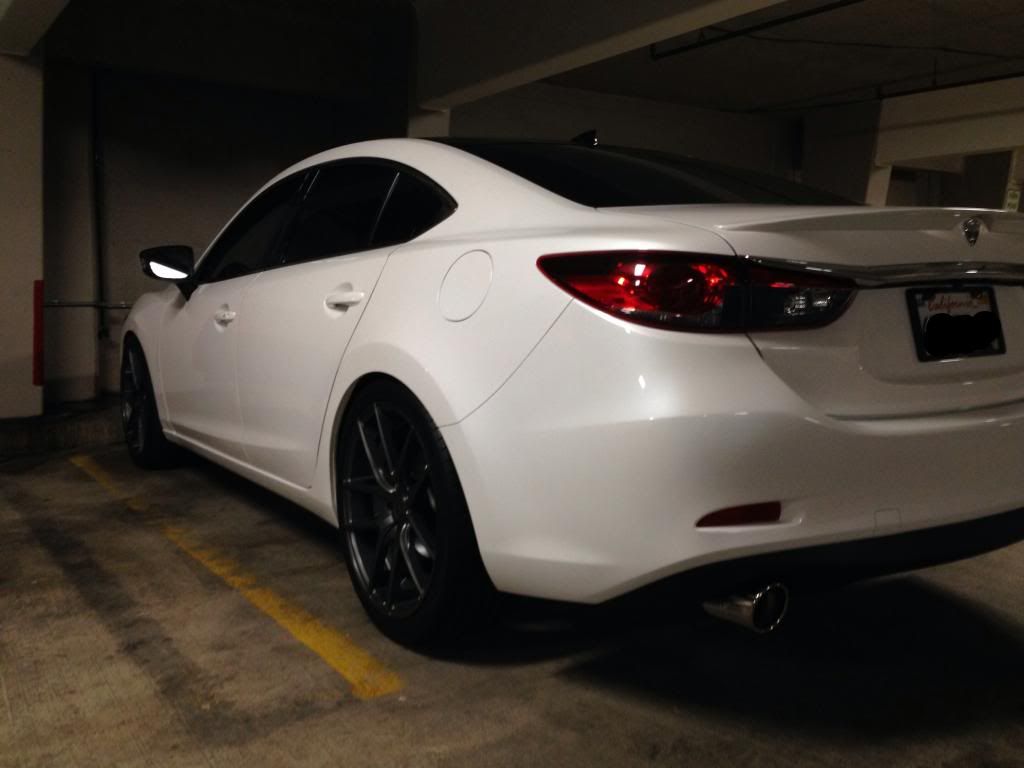

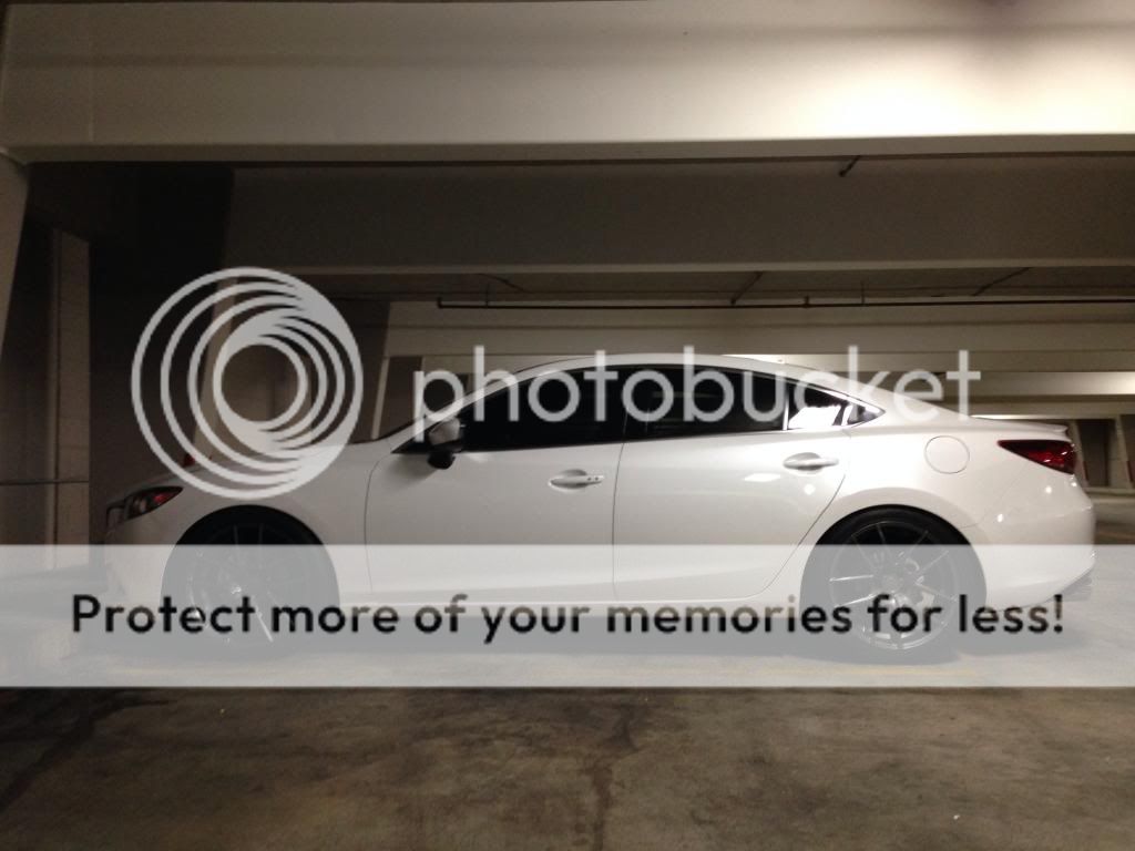

I love the H&R drop of 1.2 front and 1.3 rear with the 245/40/20 tires. It's a perfect gap fill and a good fit all around. If i didn't shave the fender, it would have never fit. The ride feels the same with a little stiffness. I often read "bouncy" but I think the word should be firm. Bouncy would be like my old car which I cut the springs a coil and a half, that car bounced on straight roads, so this is NOT bouncy...just firm. My only regret is that I should have done it sooner.
Thanks to Tony for the fender shave and Chris and the boys at Grand Prix Tires for hooking up every car I've owned with wheels and tires. Grand Prix is the only full service mechanic shop I trust for the past 16 years.
I have a few more tricks up my sleeve. I remember a little over a year ago when I first bought my 6 and went crazy for 2 weeks, I felt that I was the first...but man, everyone is killing it with the mods. Still haven't seen another fixed up 6 in Los Angeles...not even with wheels. I've seen a few more on the road in the past few months. I'll try to keep you all posted.

My wheel guy suggested 245/35/20 originally, 245/30/20 would be ideal...I wanted a bit more rubber because I bent a wheel in December due to some bad roads in L.A. The taller sidewall meant closer to the fender in the rear. The front has plenty if room. I would have preferred coil overs but with such a subtle drop, I won't be blowing up my stock shocks.

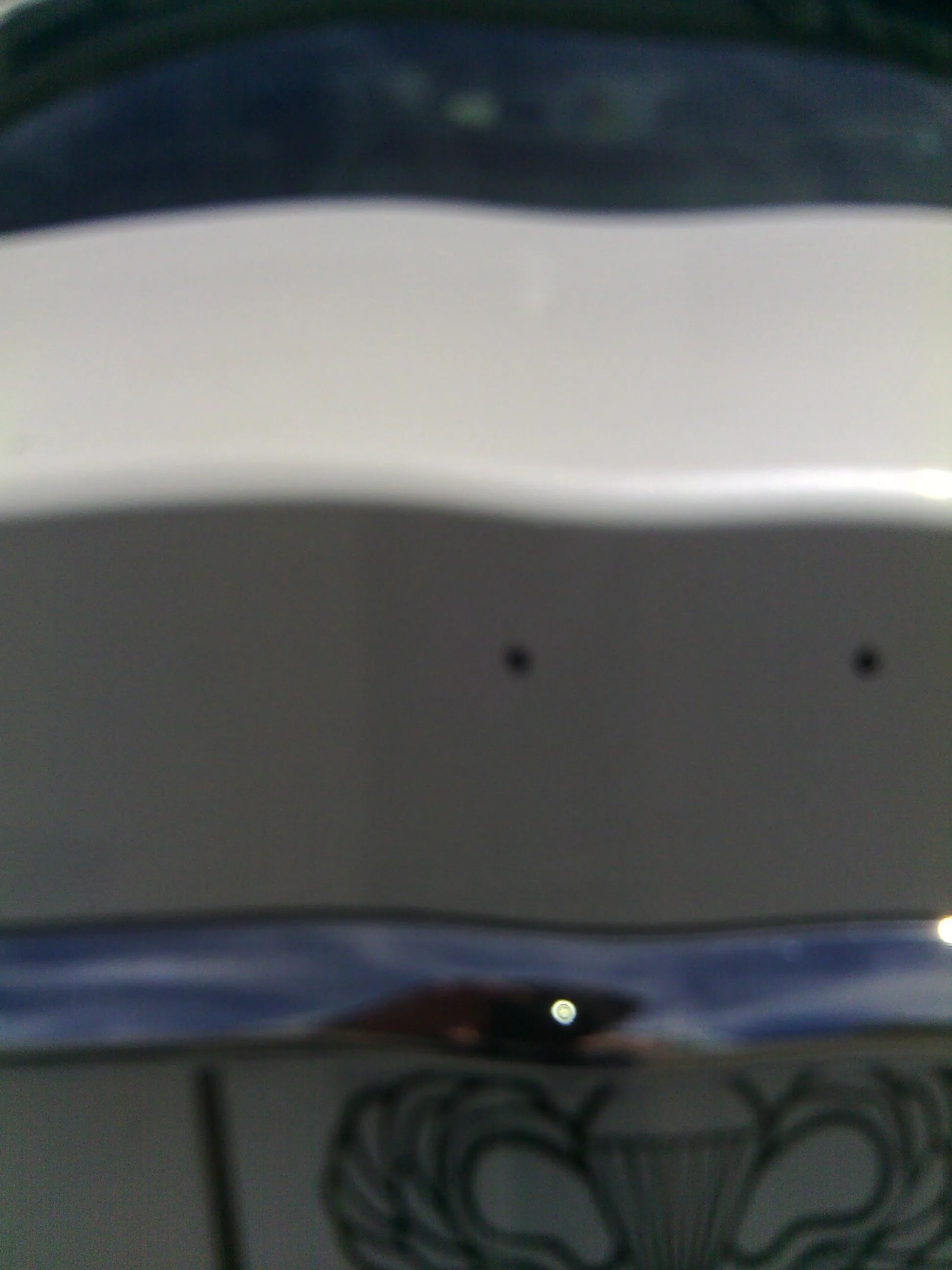

Fantastic car! I like the clean look of Monkees car. As I removed the emblems, I think it is worth mentioning that not all the 2015 rear emblems are adhesive only. I am debating painting the rear emblem black and replacing, or having the body shop weld the holes and paint.
