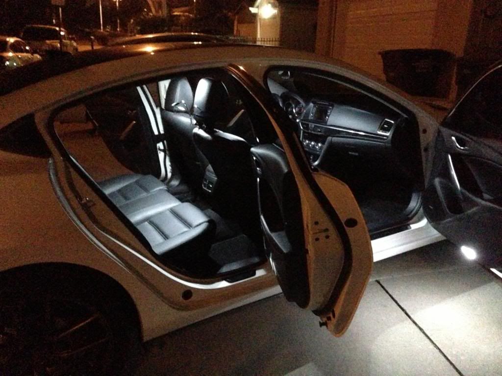

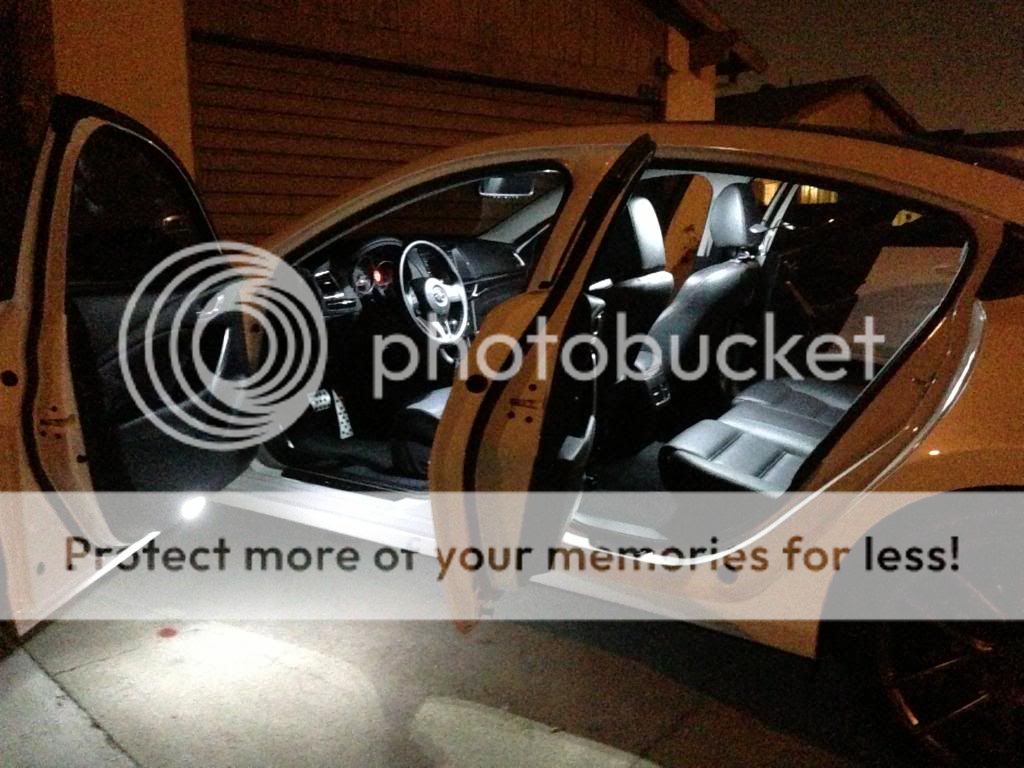

also replaced all of my interior lights and license plate light.
Here is a link to a kit for all of the interior LEDS (can be bought separately for way cheaper)
https://www.amazon.com (commissions earned)
these are the ones i used for the license plate light:

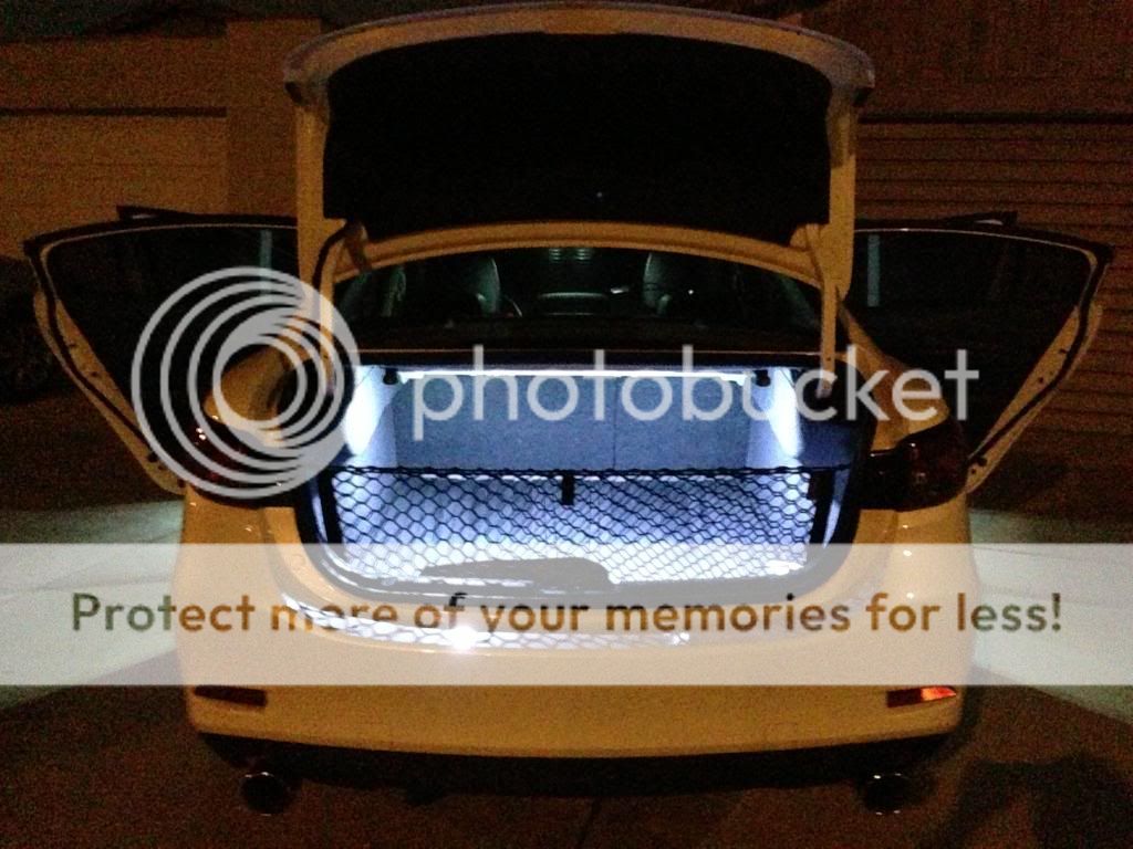

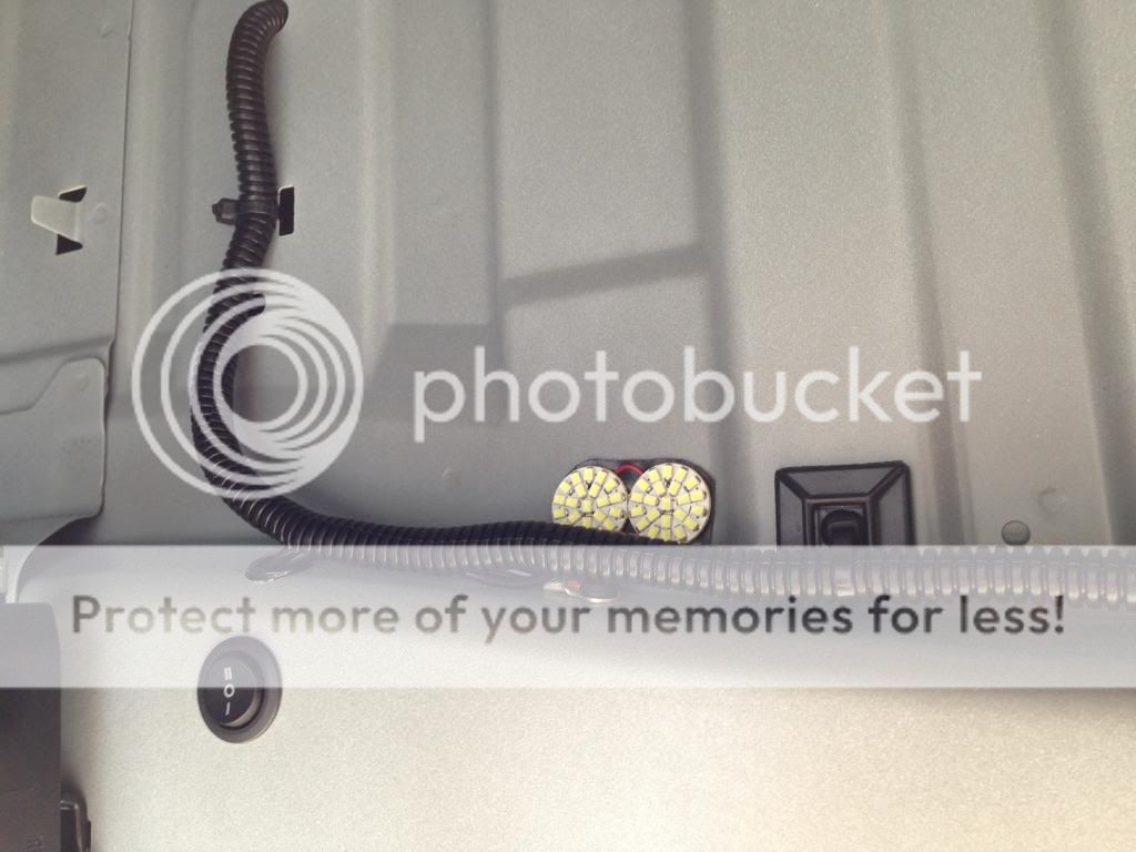

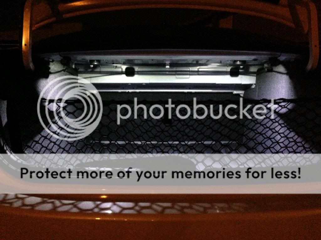

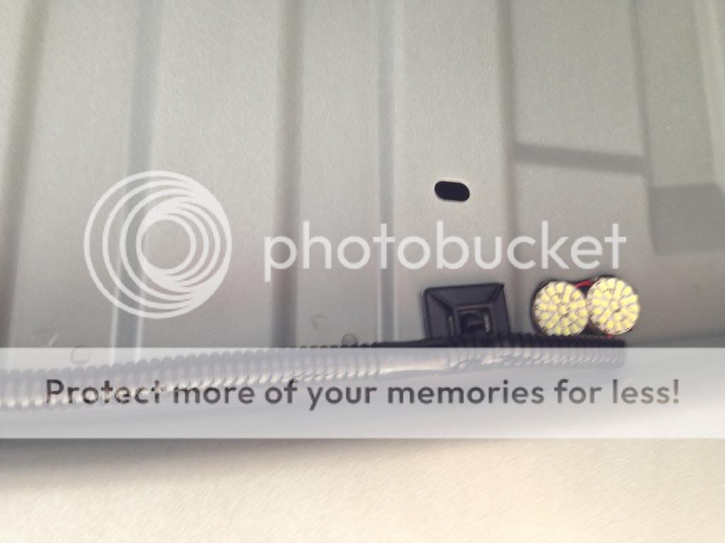

-I also took out that little instrument panel light trunk light and replaced it with a set of LED lights. 4 dime sized LED lights with 21 diodes on each coin sizes disc. That's 84 diodes lighting the trunk. Strips are usually directional, these coins are 360 directional. I also added a momentary switch with let's me manually turn off the trunk light while it's open.

Yes, it is a GT. Ralph at SWR Motorsports sourced out there nickle sized LEDs and they are thin as a nickle. They are fully replaceable with connectors in the wiring. It is wired to the old trunk light wiring and the manual switch was added to an existing hole. It works automatically or I can turn it off if I don't want my valuables illuminated at night...I move some valuable stuff sometimes. It cannot be seen from the outside and lights up the whole trunk. I'll get a pic off the LEDs at night and post it tonight.

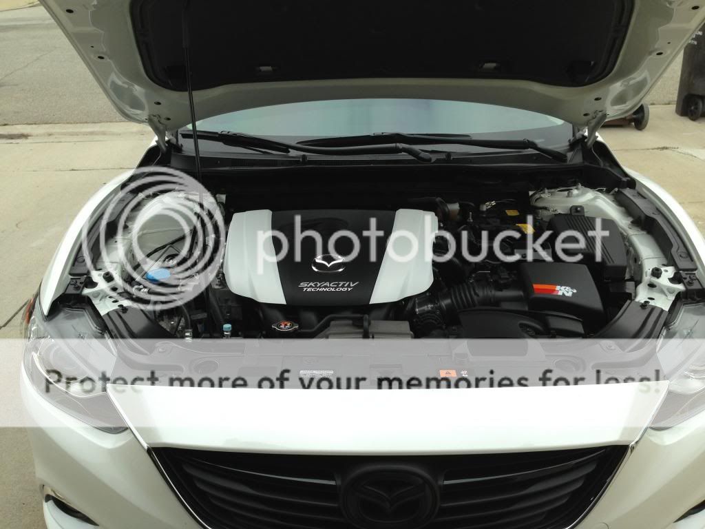

I also just decided to paint the engine cover to match the exterior. Rustoleum white high temp spray paint and 3 coats later, it's done. It's a nice flat white, too. Colors come in white, black, red, grey, almond and silver.

did you pull the tiny wedge socket out and remove that from the car and just wire the leds directly to those wires?
nice, that looks awesome
Yup, gotta pull the little socket trough the back deck, cut then feed it back through the hole. A little solder and done.

Also, scratch the Cold Air Intake off my mod list. Installed the Injen CAI yesterday...sounds great and you can feel the difference.
