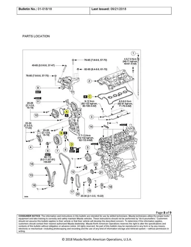

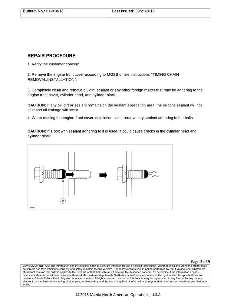

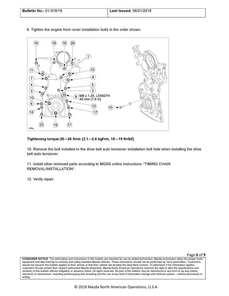

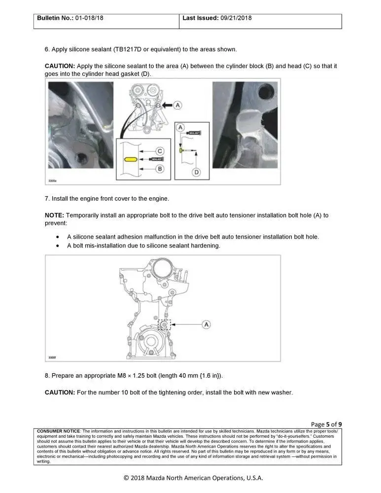

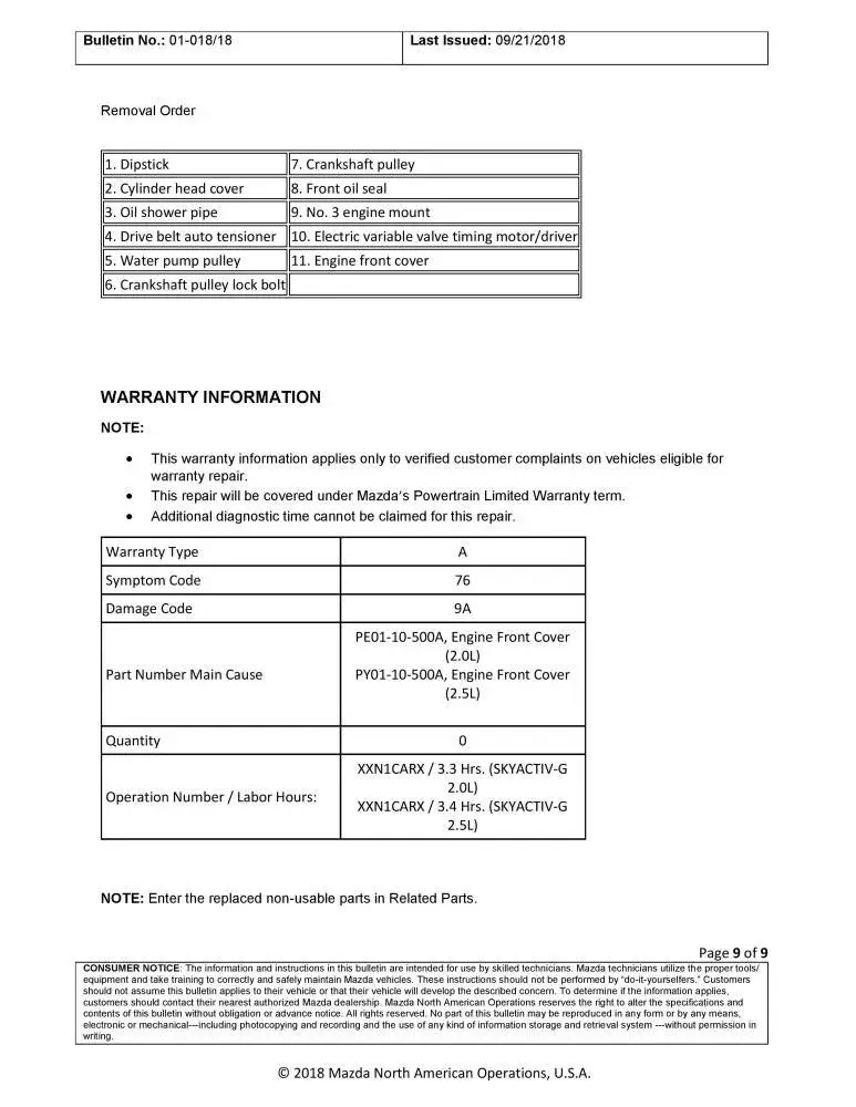

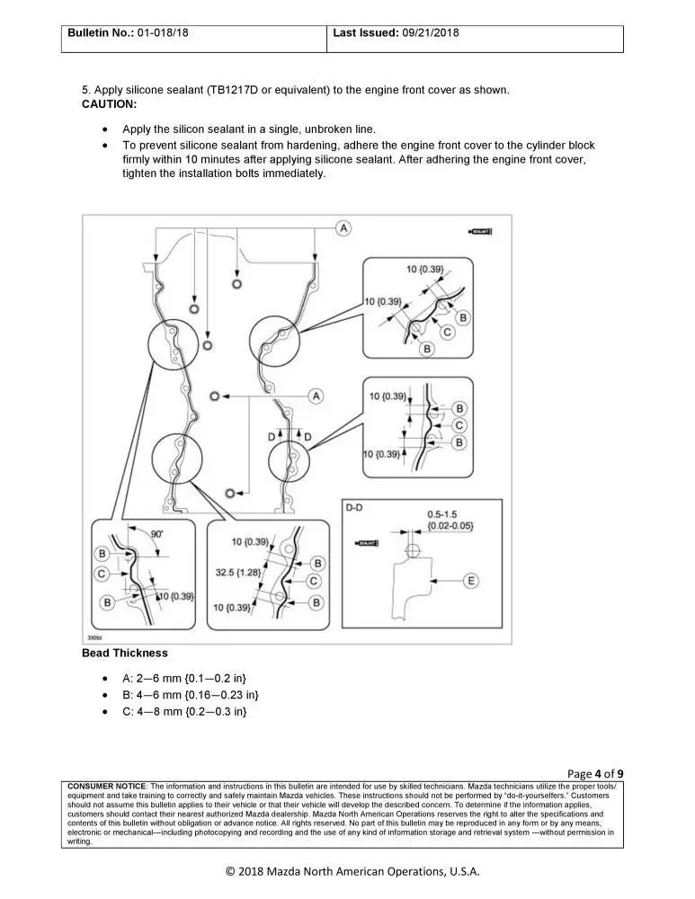

At the dealer the day, our Mazda3 with only 53K miles or 85K kilometres showed signs of timing chain cover leaking. The stealership mentioned it will be over $1500 to repair and they will need the car for a day. Upon research, it appears there is a TSB on the leak but TSBs are not the same as a recall so they won't be covered outside Mazda's Powertrain warranty.
