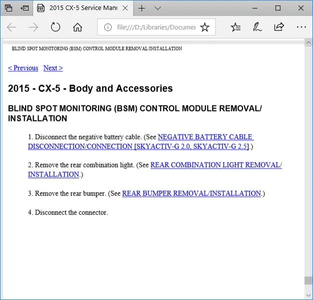

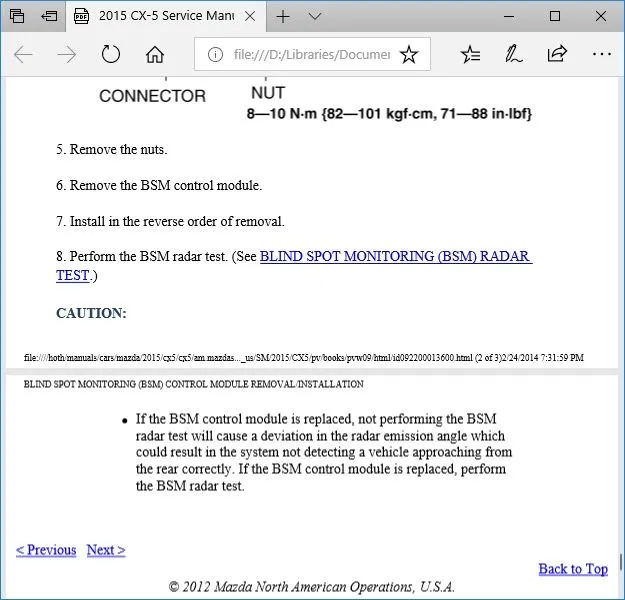

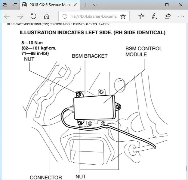

Actually I was surprised MNAO didn't do anything for your BSM when you still have CPO warranty. At least they should ask Mazda dealer hooking up M-MDS computer and checking if there's any DTCs stored in the BSM control modules (radar sensors) on both sides. According to Mazda Factory Service Manual, whenever the BSM control module is replaced, a BSM radar test needs to be performed.
Mazda Factory Service Manual said:
CAUTION:
If the BSM control module is replaced, not performing the BSM radar test will cause a deviation in the radar emission angle which could result in the system not detecting a vehicle approaching from the rear correctly. If the BSM control module is replaced, perform the BSM radar test.
Whenever anyone replaces one BSMCM, if the part number on replacement one is different from your original BSMCM, you had better replace both sides with the latest revision number and perform the BSM radar test.

BSM Control Module Removal_01.webpBSM Control Module Removal_02.webpBSM Control Module Removal_03.webp
I wasnt aware that there was a test that could be performed. I was told they physically inspected the condition of the module units themselves and drove the car. They never once mentioned any kind of radar test. Im curious as to what it involves if anyone knows? Is it a special tool or something?
