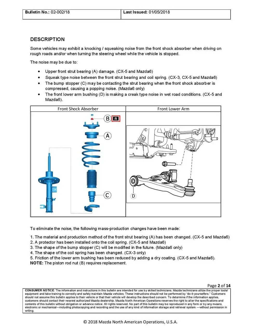

I know its about that times for shocks and struts I am at 118,000 and every times I go over any sort of bump I get a clunking noise from the front end . i had it at the garage for some tires and they said the noise might be the front sway bar links I know the rear links are shot because i can see them hanging down . i would like to attempt this job with a friend so I can save some serious money . I have been looking at rock auto and I also found a complete set of struts for front and rear shocks for under $300 i am worried they might be junk any thoughts ? I am gonna try to share the link . just so you know this is my daily driver and i ride on some pretty decent roads and I am not looking for the ride quality of the original struts when the car was brand new . https://www.ebay.com/itm/2939590641...=0&customid=link&campid=&toolid=20001&mkevt=1
