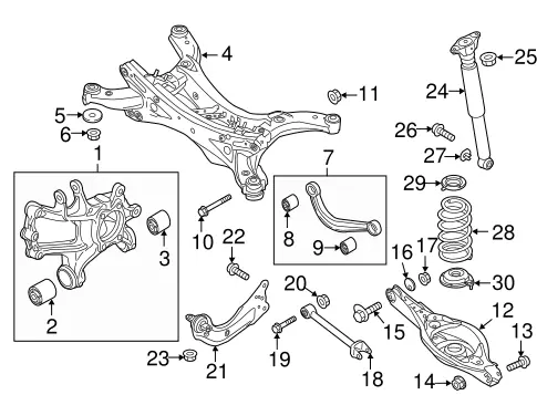

For OEM rear shock absorbers. #24 in the diagram, here are part numbers for gen-1 CX-5:
KDY5-28-910C Shock absorber for 2013 ~ 2014 Mazda CX-5 to 5/13/13.
KR27-28-910H Shock absorber for 2014 ~ 2016.5 Mazda CX-5 from 5/13/13, Type 2, without AWD.
KD35-28-910K Shock absorber for 2014 ~ 2015 Mazda CX-5 from 5/13/13, Type 1, with AWD.
KA0G-28-910G Shock absorber for 2015 ~ 2016.5 CX-5 from 11/03/2014, with AWD.

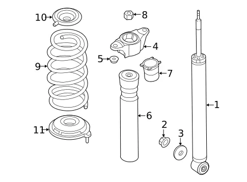

For OEM rear shock absorbers and shock top mount, #1 and #4 in the diagram, here are part numbers for gen-2 CX-5:
KB7W-28-700B Damper rear for 2017 CX-5 to 06/22/2017, with FWD.
KL2F-28-700A Damper rear for 2017 ~ current CX-5 from 06/22/2017.
KL2G-28-700A Damper rear for 2017 ~ current CX-5 from 06/22/2017.
TK48-28-380C Shock mount for 2017 CX-5 to 10/01/2017.
TK52-28-380C Shock mount for 2017 ~ current CX-5 from 10/01/2017.

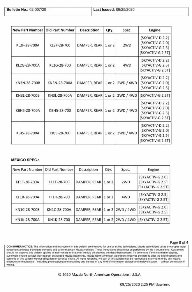

Just wanted to chime in on this good post, these are the new updated part numbers for the rear shocks, if you're getting them for your 2017-2020 CX-5 make sure you get the updated ones, ending in "A" or "B" depending on application, as yrwei52 posted, as the earlier version of the shock has some possible oil seepage or leakage from them, more details in the attached TSB.
  • TSB 02-007-20.pdf
New part numbers for OEM rear shocks which superseded the part numbers I listed above from the TSB posted above thanks to Hawke:
TSB No.: 02-007/20 OIL SEEPAGE / LEAKAGE FROM REAR SHOCK ABSORBERS
