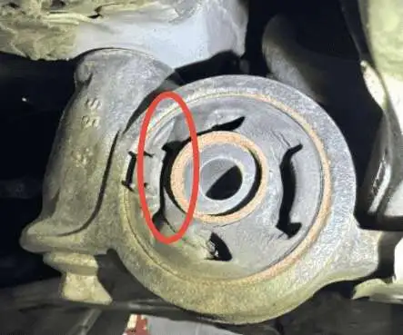

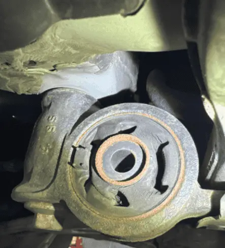

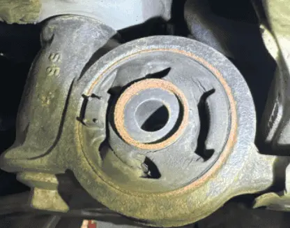

3. Control arms (left and right) are about $ 1,200 in total. See pic below - apparently they are worn out. Not sure if it is bad enough to require replacement

3. Front LCA bushing and ball joint on CX-5 is problematic and there have been many updates based on many TSBs especially on early MYs. Compare to recently purchased LCA on my 2016 CX-5, your LCA bushing definitely has worn and should be replaced.
Be aware Mazda uses different front LCAs for different MYs on CX-5; whereas the aftermarket LCAs have one-size-fit-all.

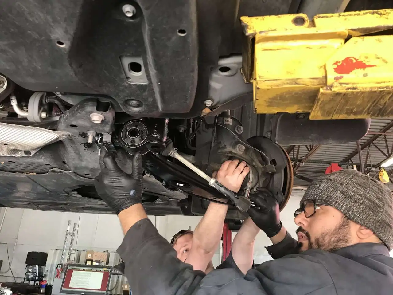

CX-5 DIY Control Arm Replacement Difficulty?

No way I would be spending that kind of money to replace $100 control arm. Go to a different mechanic. Also, your control arm bushing looks fine. Unless you have play in the ball joints, no need to replace.

Apparently you didn’t deal with the LCAs on CX-5 recently. Go to the link I posted above and read. The OEM LCA for a 2014 CX-5 selling for $165.15 each just 1.5 years ago now it’s $248.35. Yes you can pay $100 each for some cheap aftermarket LCAs, but do you really want to risk $250 labor each for a LCA which may have fitment and reliability problems?
The OP saw the LCA bushing has worn out with a pic. I can see it too comparing to my new LCA bushing. With worn-out bushing some states can’t even pass inspection (again, see the same discussion).
$1,200 to replace both front LCAs seems to be outrageous. But unless you DIY with cheapest aftermarket LCAs, that price (apparently it’s a dealer’s quote may include a 4 wheel alignment) isn’t too high based on my recent experience and others (again, see the discussion in the link).

My bushings look much worse than what you see in that photo. The vehicle handles stable and adeptly through a variety of road conditions and maneuvers (Including high speeds and hard cornering.)
As I've mentioned in another post, my 2 cents is that replacing the entire LCA for a slightly worn bushings, on a problem area which wears quickly anyways, for such an insane price isn't worth it.
It was actually a trusted mechanic who pointed out that the bushing was worn, and that it isn't a big deal. He was more concerned about the minimal amount of play on one of my ball joints, which also is not extreme enough to warrant a replacement just yet. I like to make the most of the parts on my car before replacing.
⋯ As I've mentioned in another post, my 2 cents is that replacing the entire LCA for a slightly worn bushings, on a problem area which wears quickly anyways, for such an insane price isn't worth it.
I understand what you’re saying. In fact even if the 3 connecting rubber all separated on LCA bushing it won’t cause any safety issue other than big clunking noise and fast tire wear. And in old days we only replace the rubber bushings but not the entire LCA as the labor was much cheaper. If you can DIY replacing only the rubber bushings not the entire LCA which may be the way to go to save big money. But for Mazda the ball joint is also the weak point which looks like very difficult to replace only the ball joint. Hence for Mazda, replacing the entire LCA which includes bushings and ball joint seems to be a better way to go.
In short, keep a close eye out for play in the front wheels when you have the car up in the air. Or clunking.
Though my LCA ball joint clunks over bumpy turns, it's hardly any play. I won't change it just yet.. Look out for excessive amounts of it.
But you still want to be careful on clunking ball joint even if it doesn’t have any “play”. It’s a lot more dangerous when the LCA ball joint fails, i.e. the ball comes out of the socket! And it’s been reported a couple of times here even on an almost new CX-50:

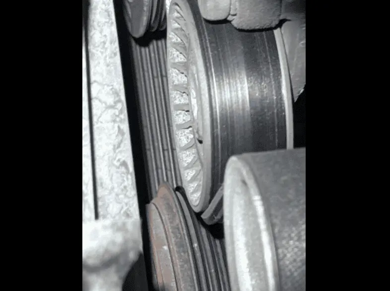

Any thoughts on the drive belt-serpentine. Apparently, it is also due. Please see below

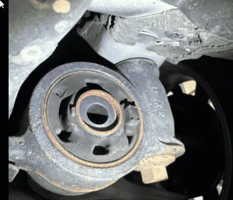

Also adding both LCAs - do both look bad equally bad (rubber and ball joint)
I would definitely replace that serpentine belt as precautionary measure. At 220,000km, mine was in rough shape.
If your ball joints have play in them, find a better quote and replace them. Otherwise, you could leave those for now (if you wish.)
