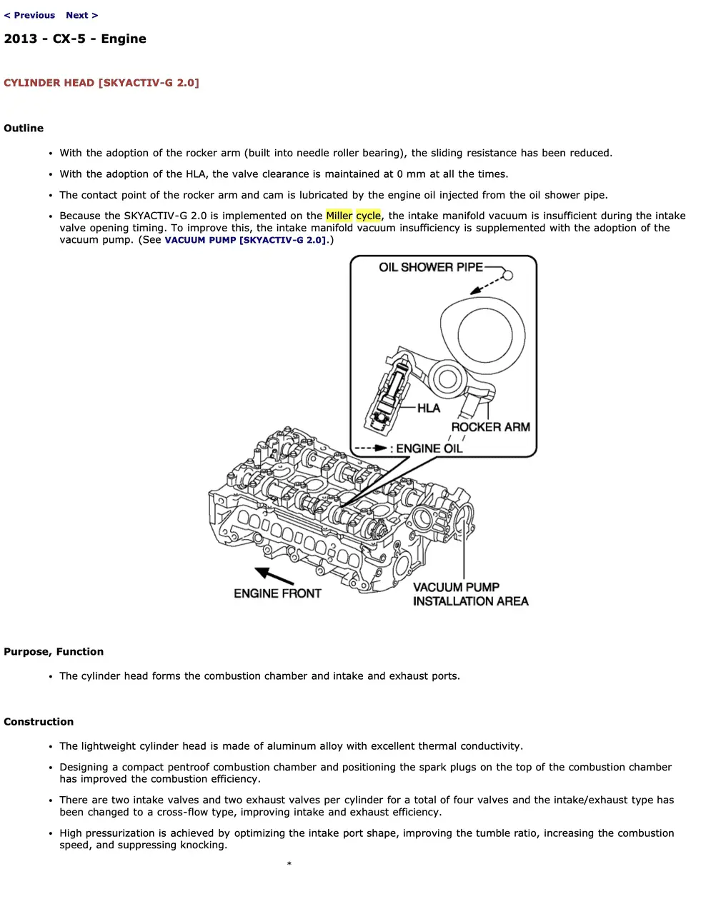

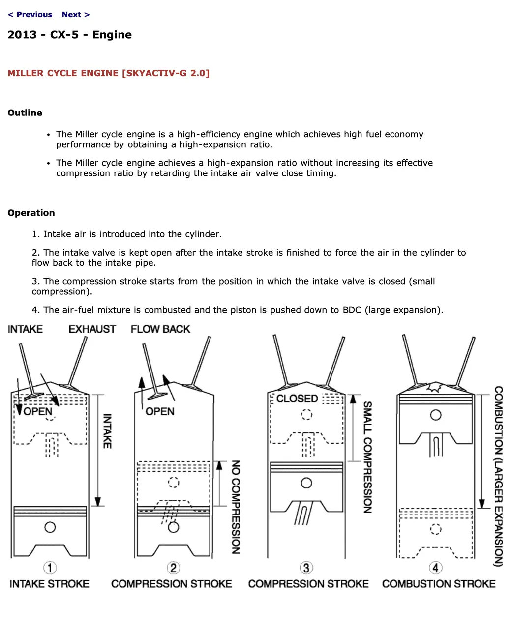

Interesting info about Miller Cycle a bit off topic while looking up compression
