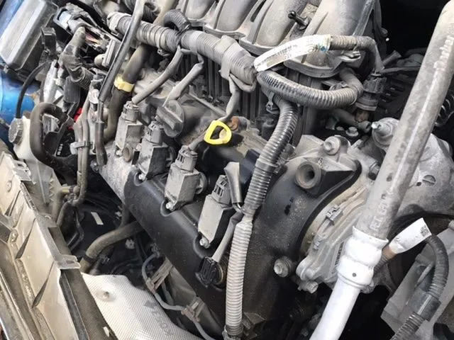

new here. I have developed a new oil leak in my 2013 CX-5 2.0 6spd manual with 170,000km . I’ve owned it since new.
small patch of oil on the driveway.
doesn’t look like a drain plug. Last oil change was 5000km ago and this just started. Oil is collecting on top of the plastic cladding under the car, and dripping through the holes onto the driveway.
I thought I had noticed some white exhaust, but it’s been winter here and can be hard to be sure in cold weather. I took a picture of the top of the engine with the dust cover off, where there is also oil present.
Any ideas on what this could be? Hopefully not a head gasket but I’m concerned this could be the issue.
Thanks in advance.
Adam

Any chance there was oil spilled during the last oil change or the oil fill cap or dipstick was not fully seated. Both of these will result is oil on the engine top that will run down. Ed
Dipstick seemed ok when I checked my oil level.
Didn’t think to check the full cap, re seated that. Thanks. Hopefully that makes a difference.
I’m wondering if the oil on top of the engine is just over drip/ spoilage from 7 years of oil chnges.
It looks like a noob spilled oil on the valve cover. You can always wash it off with a hose and some spray (or the powerwasher at a self car wash). Put a cotton rag/towel over the alternator if you do that
It's almost certainly the oil control valve (OCV). If you search online, you'll find quite a few reports of those leaking after considerable mileage.
The fix requires removing the valve cover.
That type of mess wouldn't come from the ocv. It doesn't spray out to cover the vc like that. That clearly looks like someone wiped oil over the VC (like with a rag after a spill). Unless the oil sheen on the vc is unrelated, the ocv weeps very slightly when it does start

It’s a follow up here. Turns out there were 3 separate issues.
oil control valve started leaking at the bottom of the engine, and was the source of the dripping.
Valve cover was seeping oil.
Oil pan was also seeping a bit.
All fixed up and good to go.

Thanks for the update. The dripping from oil control valve was excessive. The other two oil seepages should consider normal wear and tear on most vehicles.

Most of time those rubber o-ring (oil control valve)、cork gasket (valve cover gasket)、and silicon seal (oil pan) are aged and hardened which would cause seepage or leak.

You need to change the oil control valve solenoid, PE01-14-420A, at the same time, not just the rubber o-ring seal, as the valve itself will leak too at higher mileage.

Your old valve cover gasket should get replaced at the same time too.
