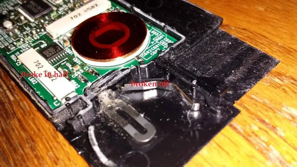

After opening(really horrible job since the entire case is glued) i found out that the battery wasn't making contact because one of the battery connectors was broken off the PCB.
I bought an empty shell case of Amazon and put the old PCB in the new shell case.
https://www.amazon.com/dp/ (commissions earned)
Tried soldering the battery connector but that didn't work since it was shorter because it had broken off. Bought an external battery holder and glued that on the back of the case.
This didn't work either because in my attempts to migrate the PCB apparently one of the copper antenna's broke in half. This resulted in spotty unlock/lock behavior.
https://www.amazon.com/dp/ (commissions earned)View attachment 303980
