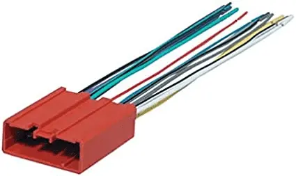

Radio doesn't matter. I'm asking which harness you went with. You did use one, right? You didn't cut the factory plug off, right?
Dude, WHY?!? Solder it back on (yes, actual solder, not crimps, and for the love of God, not a twist and tape) spend $7, get a proper harness. All of your problems will disappear.
Lmao, speed 3, only harness available is a 130$ steering wheel control one that I don’t even care about cause I’m doing single din, literally just need a unit that plays Bluetooth since I’m doing dual amps, 4 channel and mono, 2 subs and 4 new speakers. I just needed to know if the color for the wire was correct.
They don’t make a 7$ harness for a mazdaspeed 3.
You are dead wrong: Yes they do. You don't get the steering wheel controls or display functions, but everything else works perfectly. And yes, it's dirt cheap, $4.37 on Amazon dirt cheap. Metra part number 70-7903.
Now repair your screwed up factory wiring harness, and do the job correctly. You have a very, very nice car. Treat it as such.
