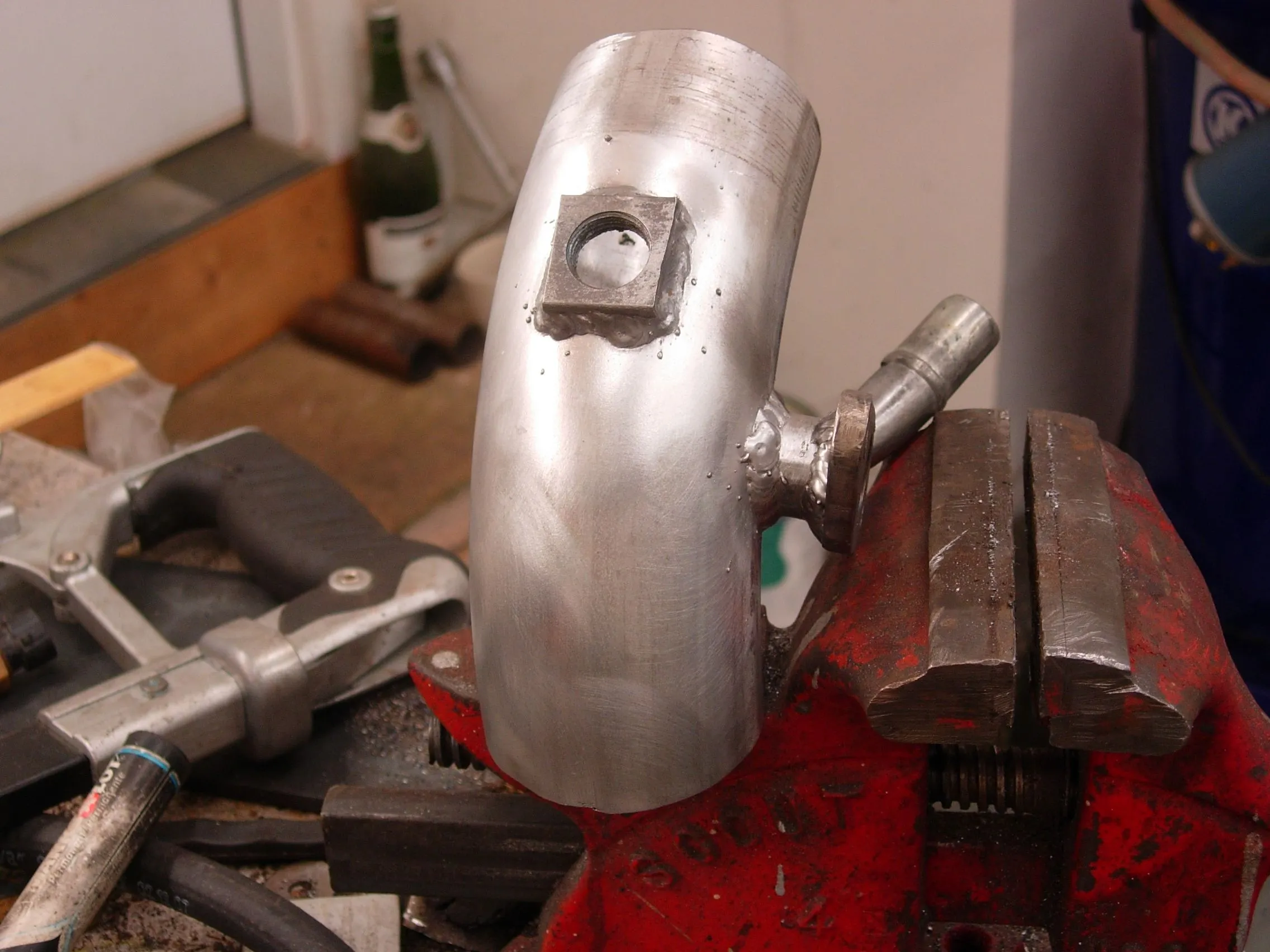

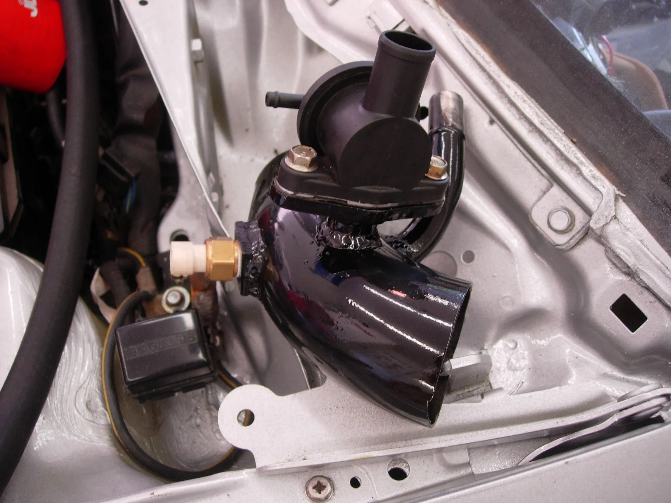

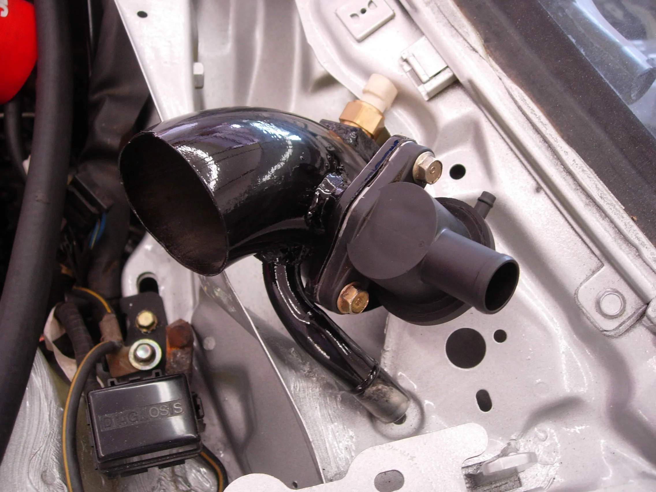

Once the intercooler was mounted and the majority of the piping fitted, I had to build a fitting at the throttle body to allow fitment of the IAT sensor, BOV, and IAC valve supply. A bit of test fitting, drilling, cutting, and welding yielded a rather complex contraption.

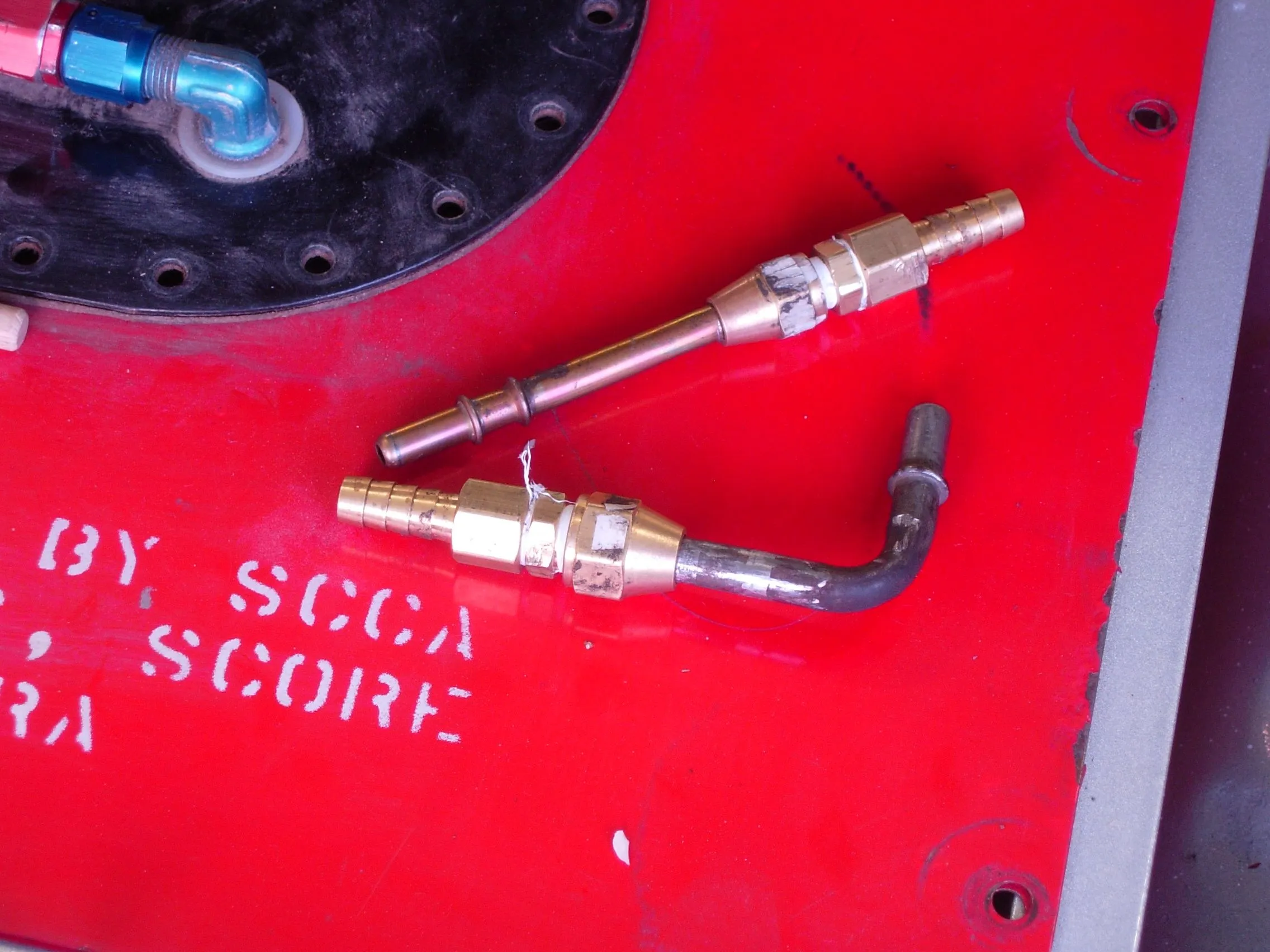

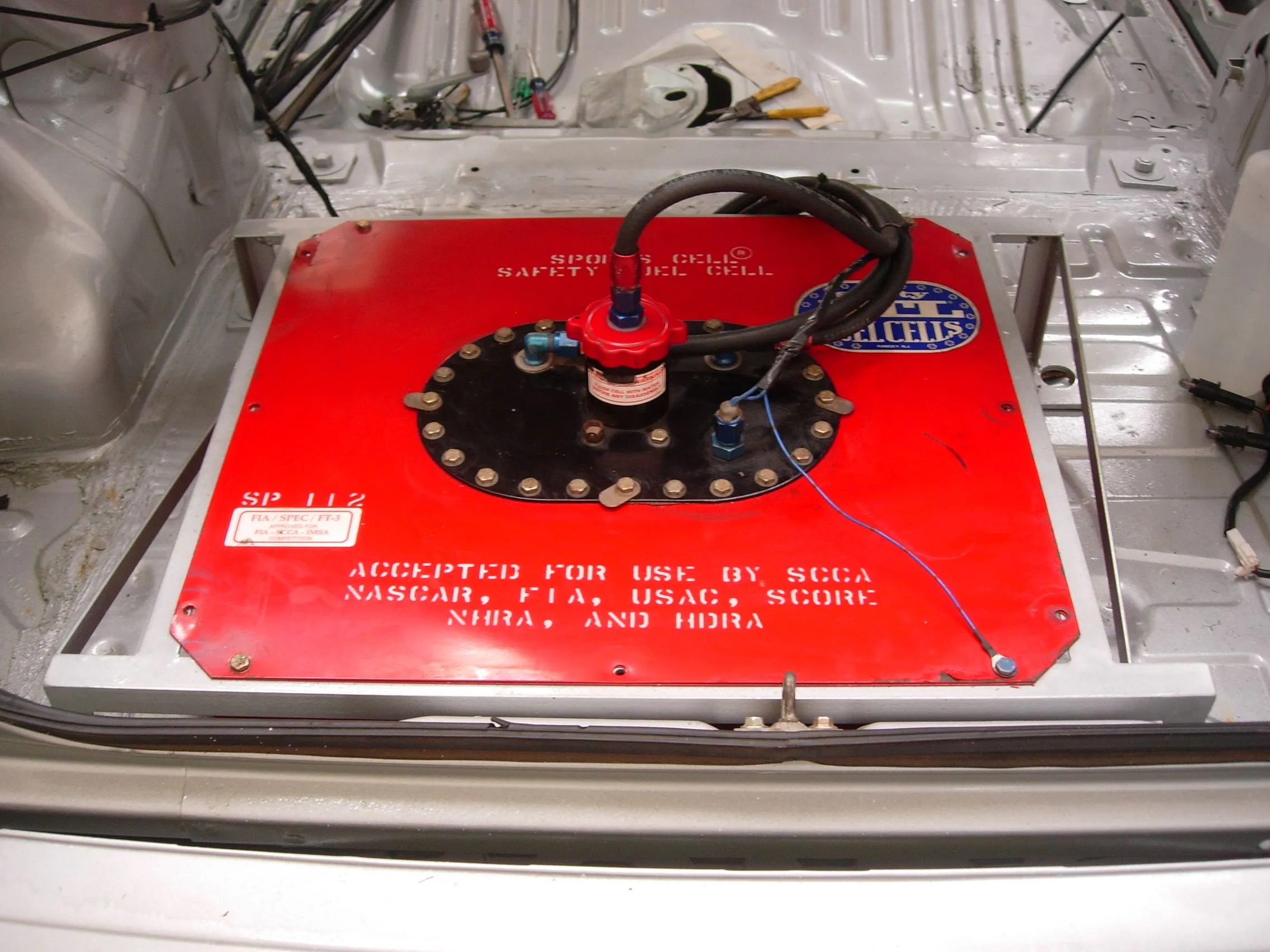

Once the fuel cell was mounted and, for the majority, plumbed, I had to tap into the Ford fuel lines. Mazda and Ford did things a bit differently between their respective versions of the BG chassis. Ford used a sort of quick connect fittings to connect the lines to the fuel pump whereas Mazda uses simple compression. To avoid cutting into the stock semi-hard lines and fighting with fittings, I cut the original quick connect receivers from the OE fuel pump assembly. I then flared the ends to mate with fittings so that I could easily extend the fuel lines to reach the fuel cell. No leaks and all is well.

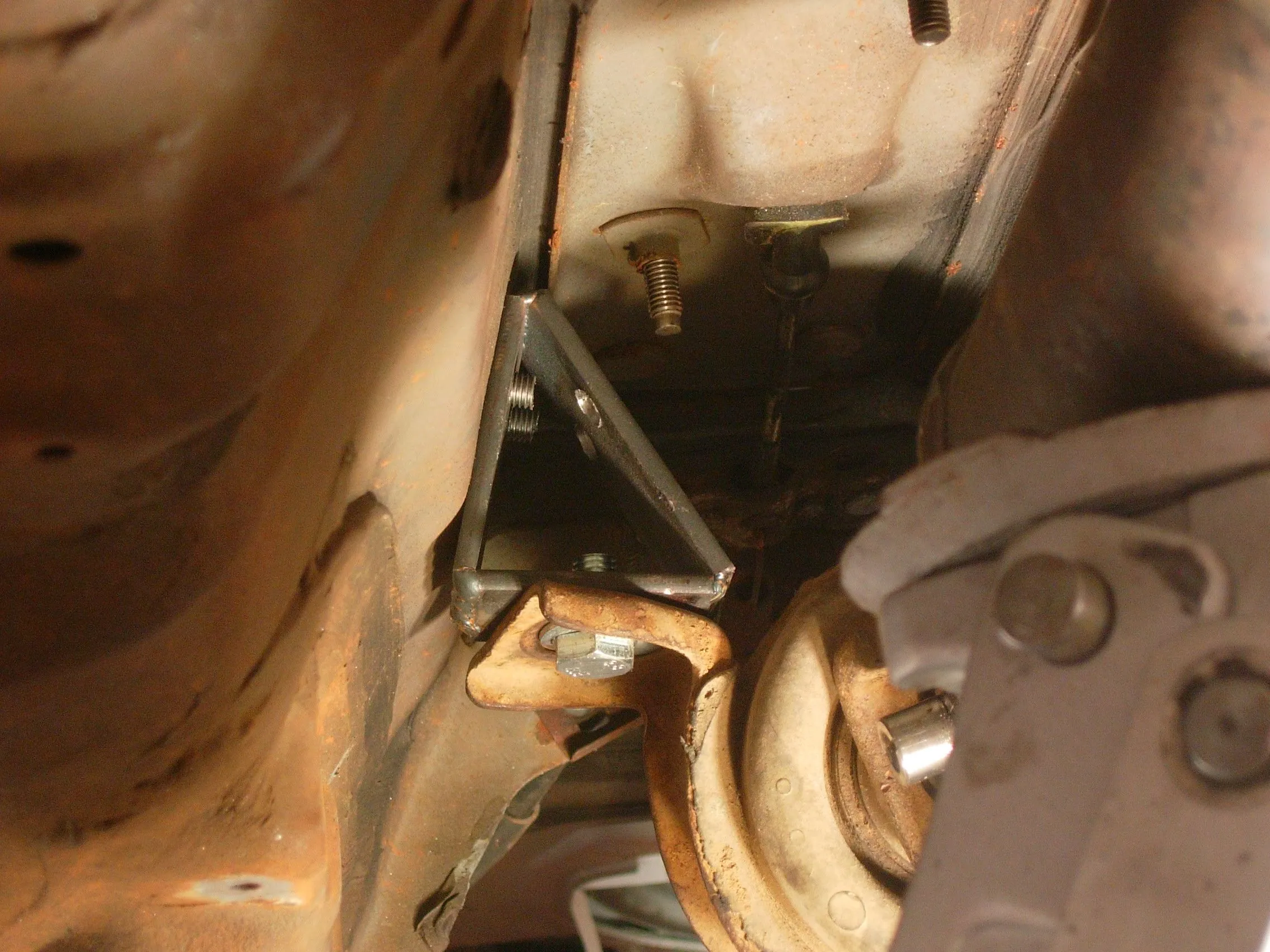

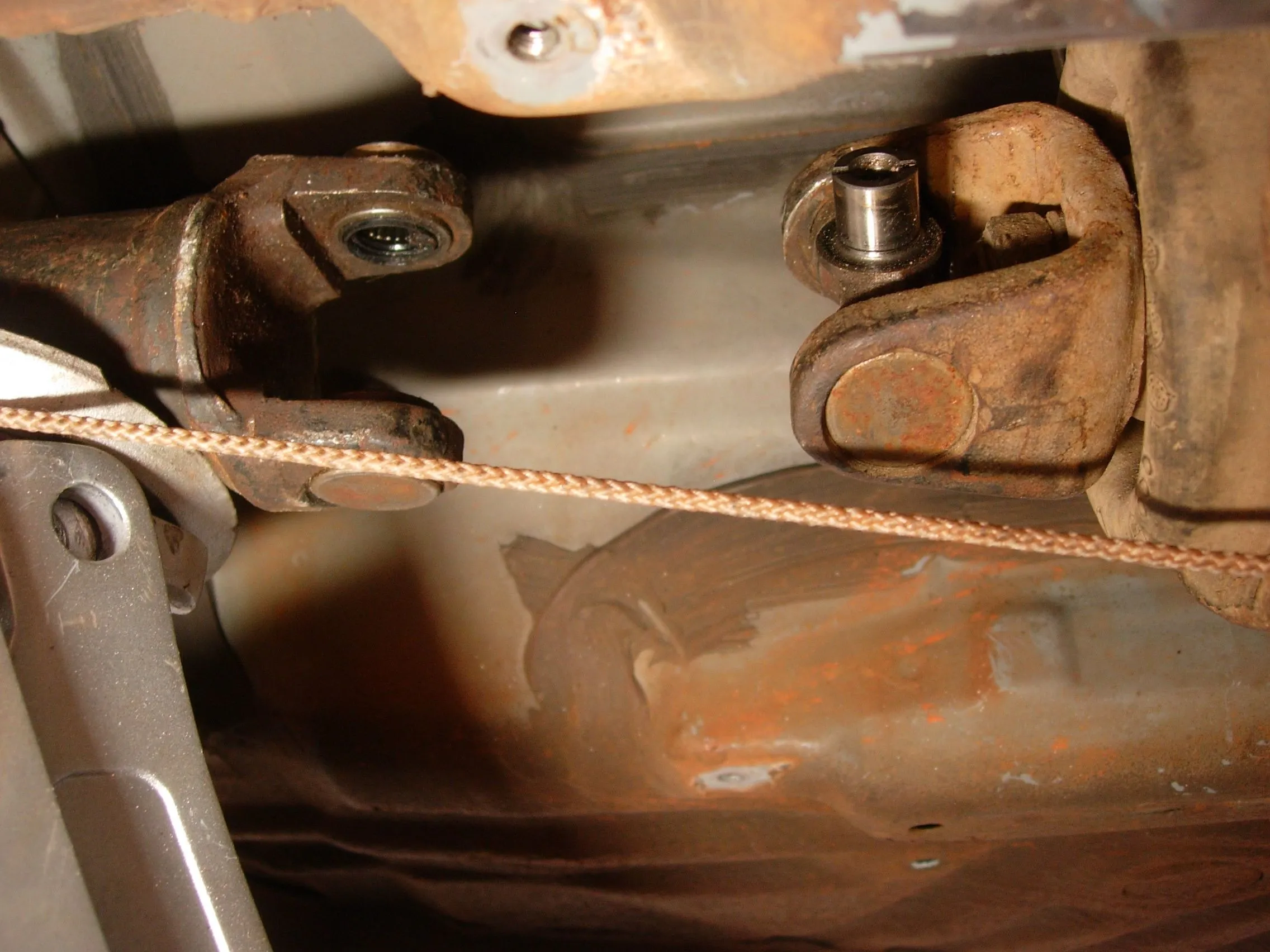

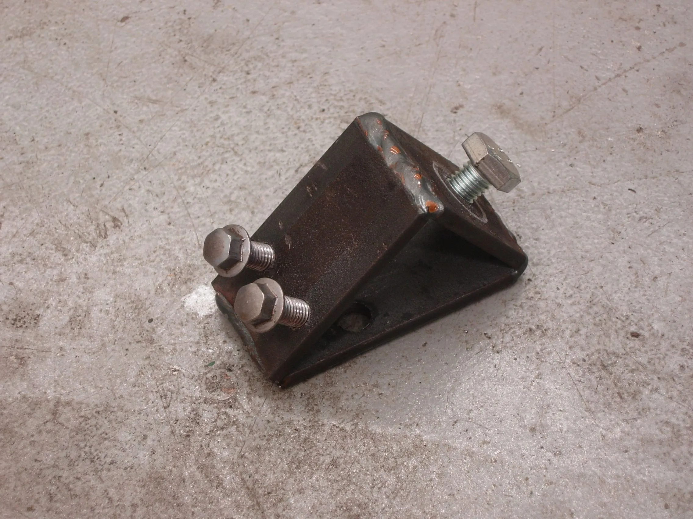

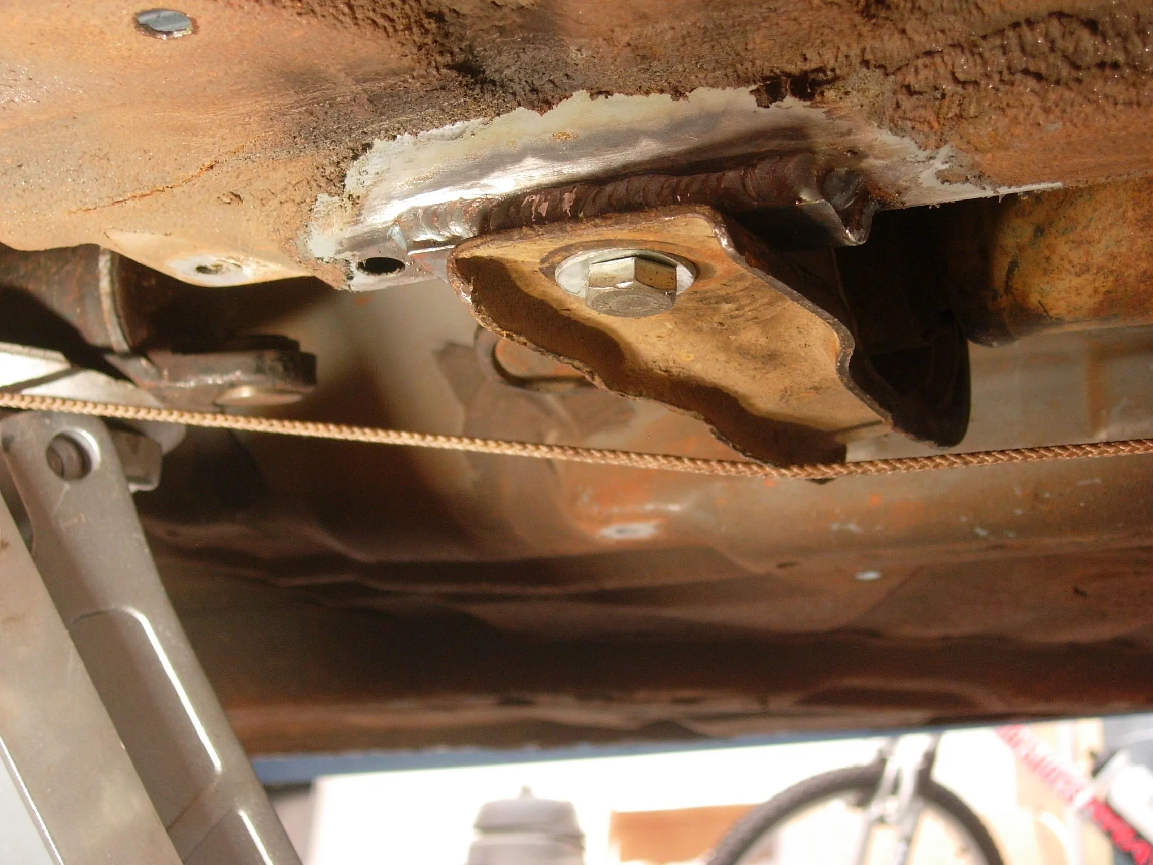

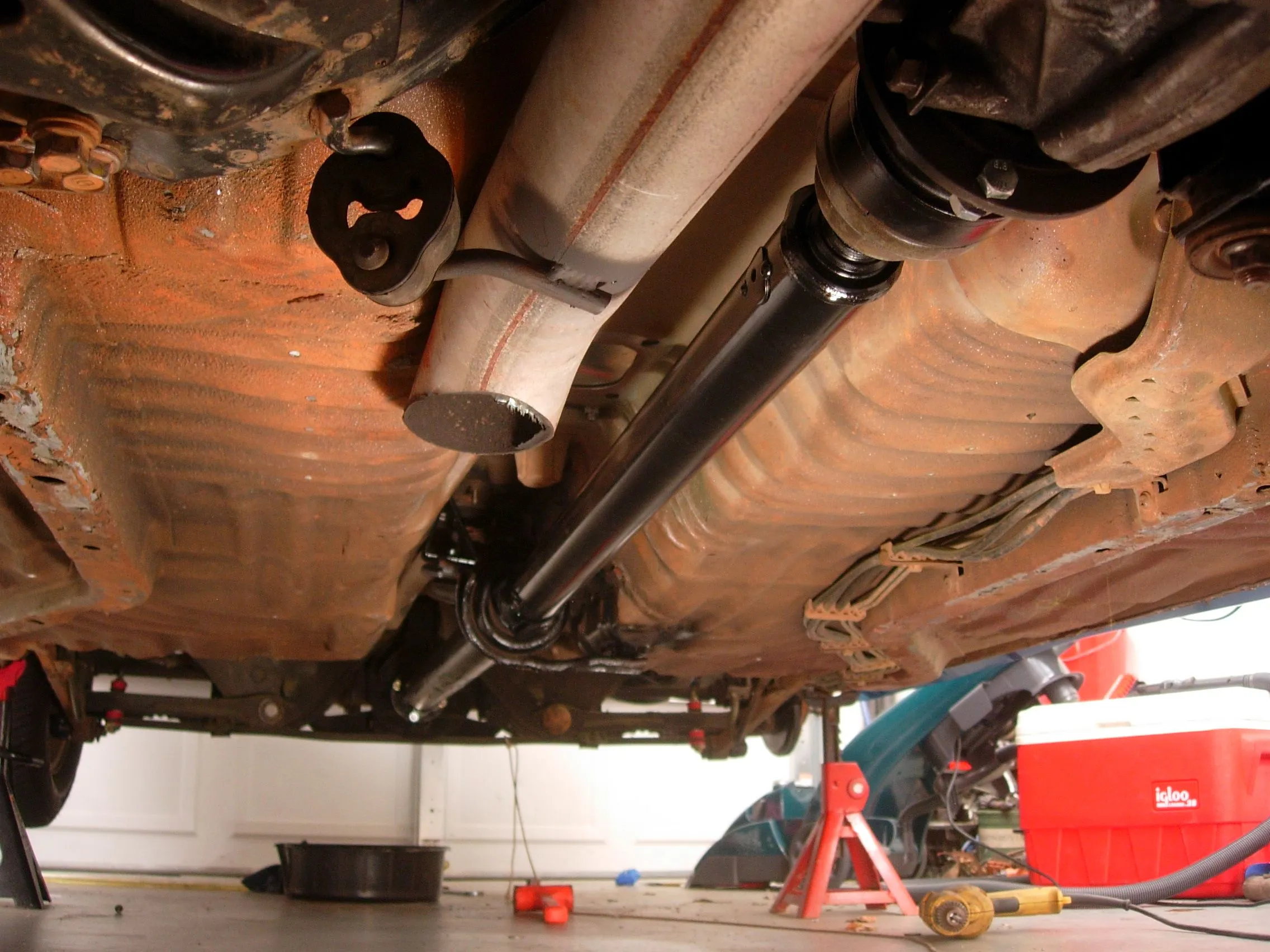

Obviously, the drive shaft would need a custom mounting arrangement. Therefore, I fabricated a triangular bracket to mount one side of the shaft support to the exhaust tunnel. The other side was secured by a welded piece of steel just beneath the driver's side seat mount. Fortunately, the chassis steel there was thick enough to provide ample support. As expected, the drive shaft is 3.5 inches too short. I'll have to lengthen it and hope the balance will hold long enough for the challenge.

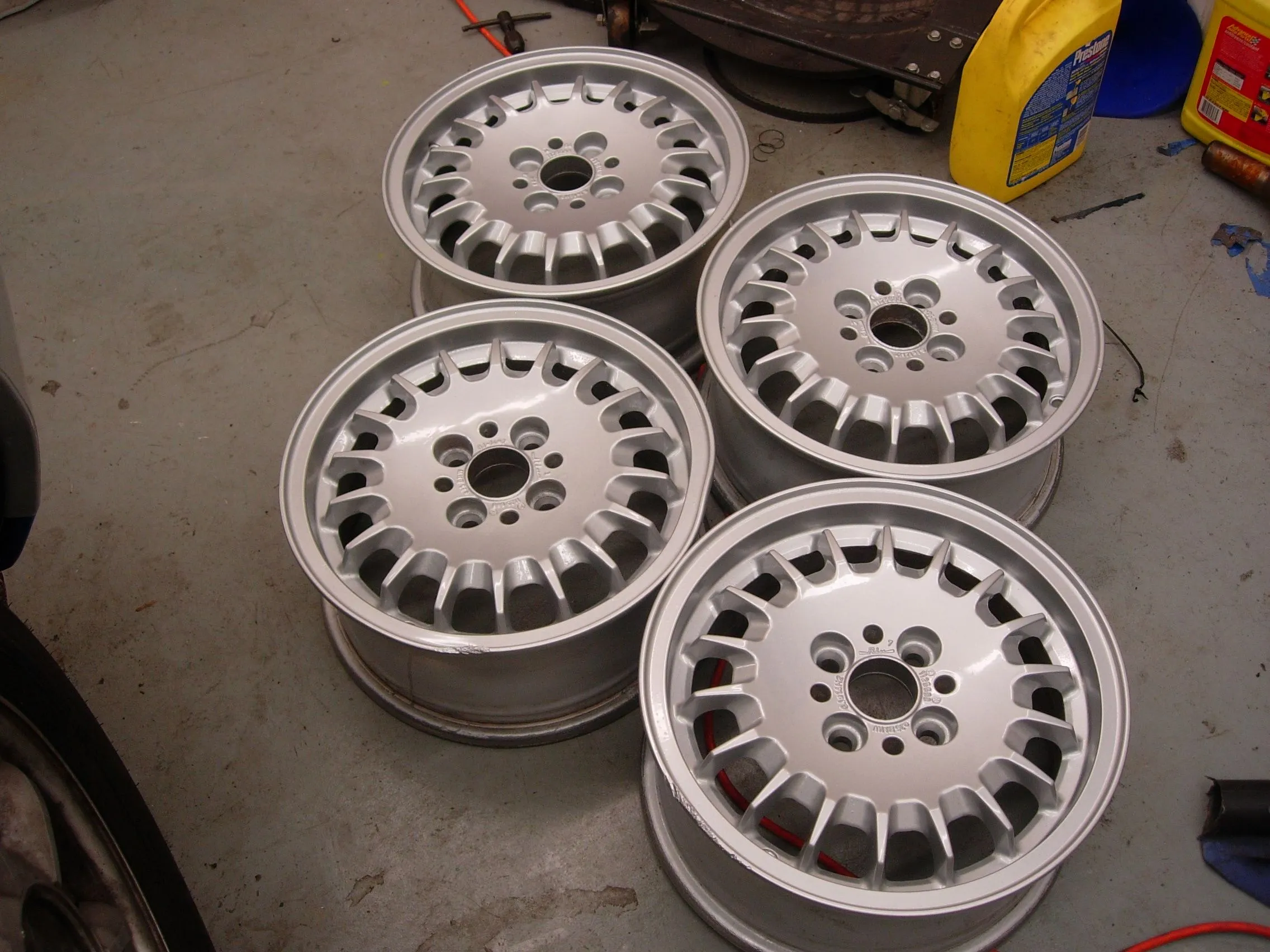

-Saturday or Sunday, the wheels will be painted in silver

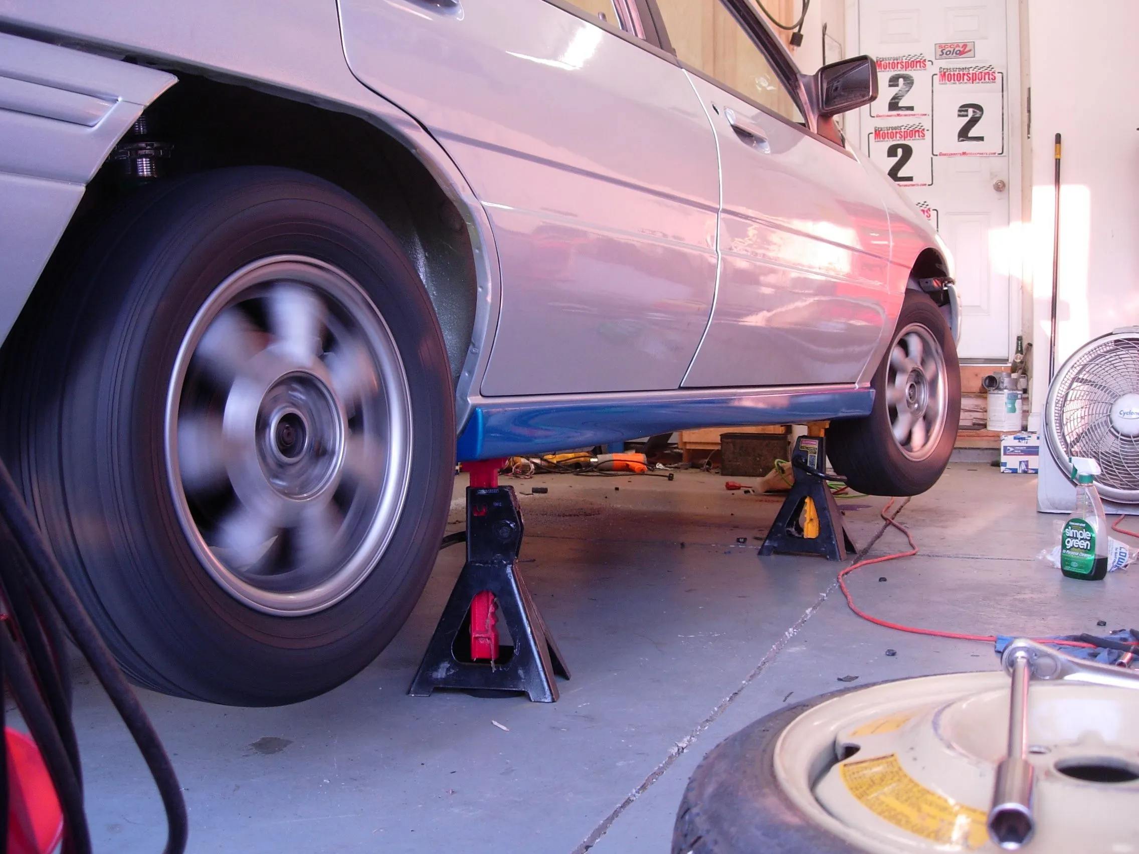

And BAM! Just like that you have an AWD Tracer!
The Tracer runs, drives, boosts, and turns all 4 wheels! Not too complicated, huh? Right. The car is nearly complete. Still with a significant list remaining, all of the body panels are painted and fitted, the wheels are painted, and the AWD system is complete. Monday, I will wrap up the front sway bar and rear firewall between the trunk and passenger compartment (required by NHRA regs). Tuesday, I'll dial in the corner weights and alignment. Wednesday is a catch all day which I'm sure will be full of small odds and ends. Thursday, I head to the dyno and then off to the Challenge! 4 days left.

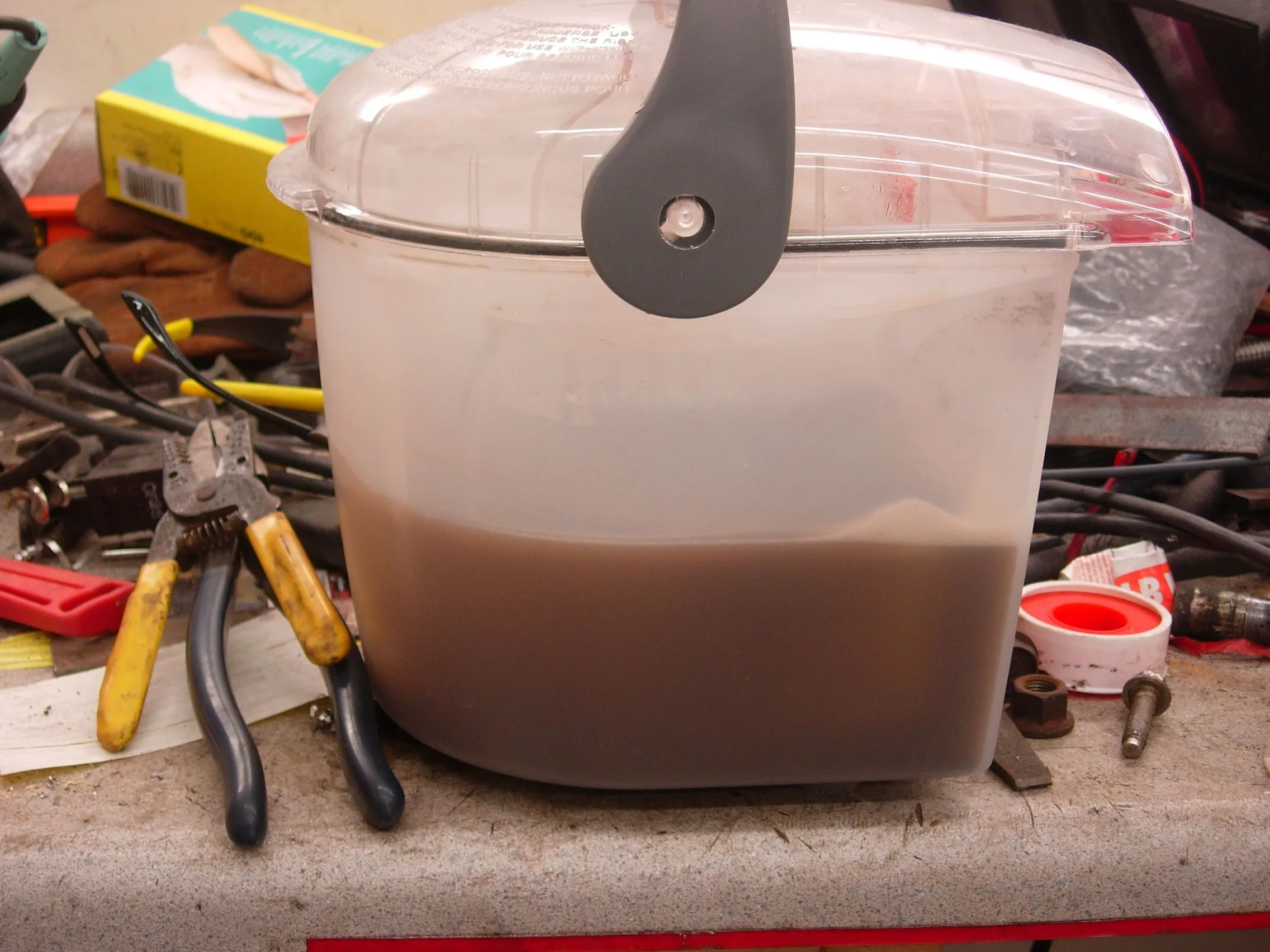

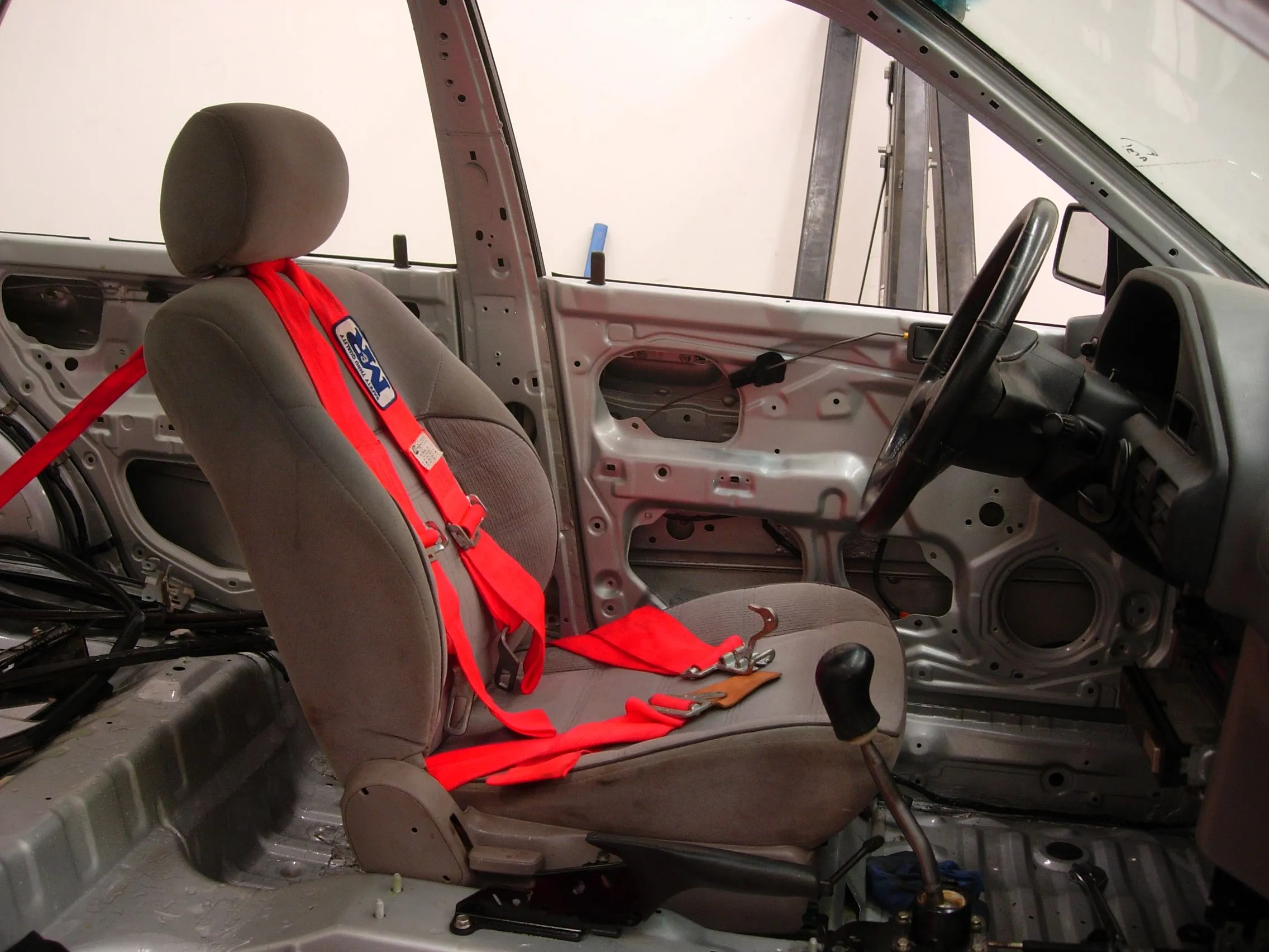

I had to use the passenger side seat as the driver's had a huge hole in the bolstering. After swapping the sliders and installing it, I steam cleaned it. The third picture shows the amount of funk I pulled from it. Absolutely disgusting. I may clean it again as I was still pulling brown stuff out. I also mounted a super bright harness I had lying around.
Thanks to Todd and Shuman for swinging by and helping out. Great job on the wheels, guys! :)

oh shnap 4 wheels turning under their own power! I can only assume so, unless you spun those by hand then turned on the camera :D
Can't to hear how it does. Good luck.
I wish the sound of that turbo could be better captured on a video. That thing sounds awesome!
