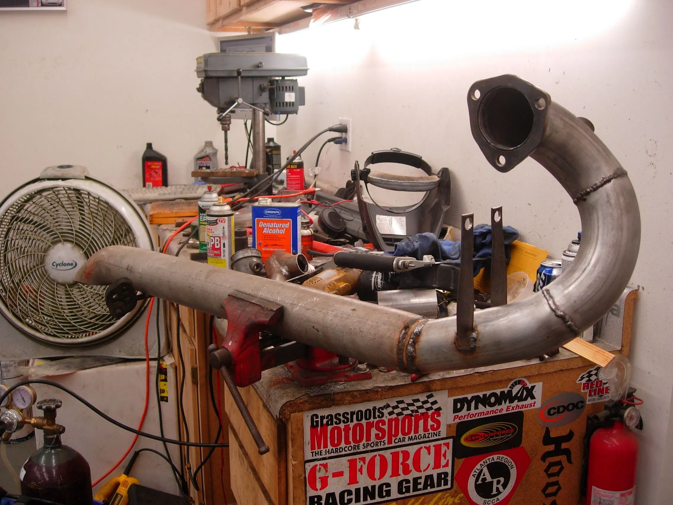

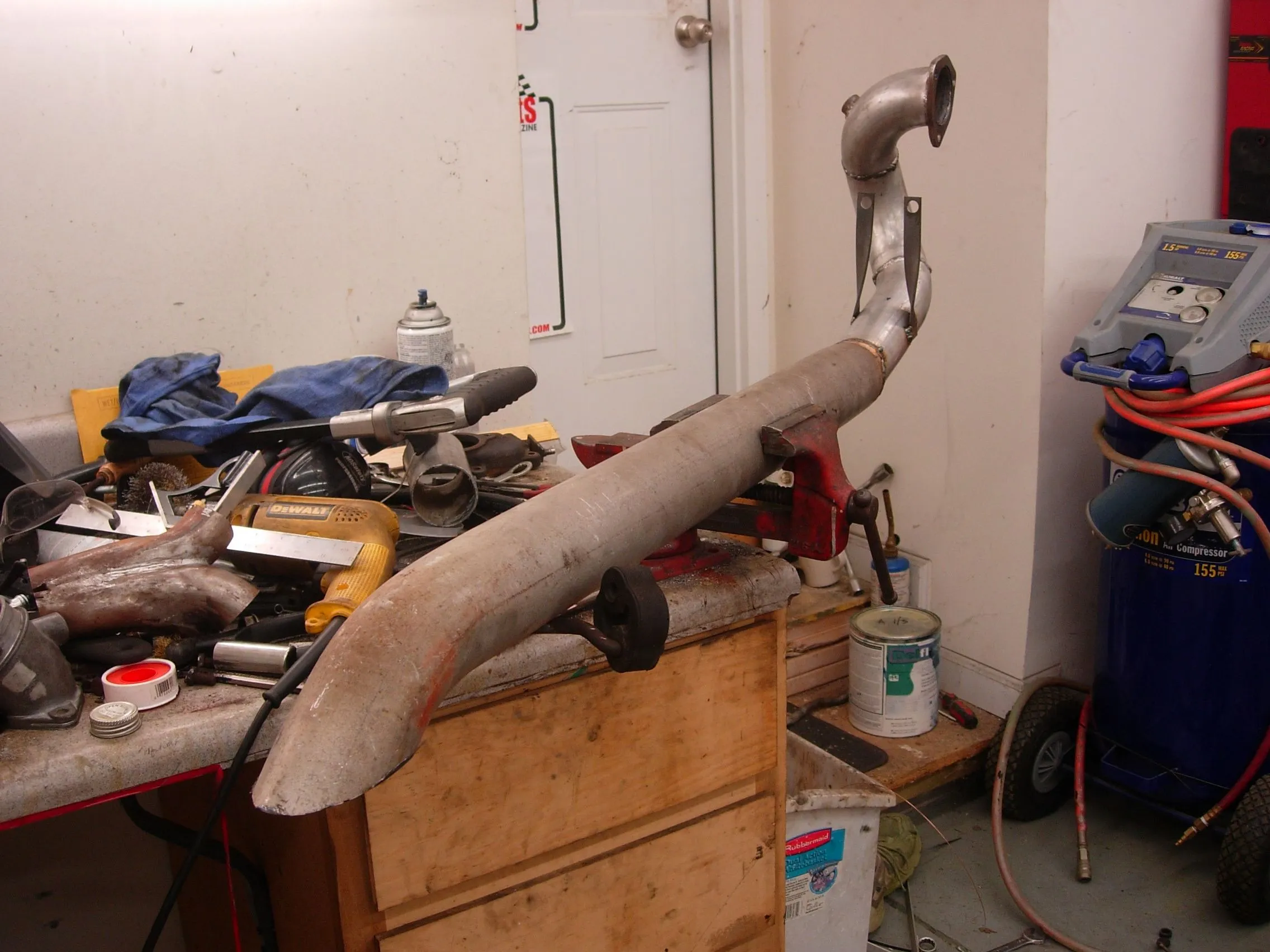

It's crunch time. I need to get this done. That said, I'm having to short cut a few things. So far, it only involves a touch of IC piping and the post-down pipe exhaust.

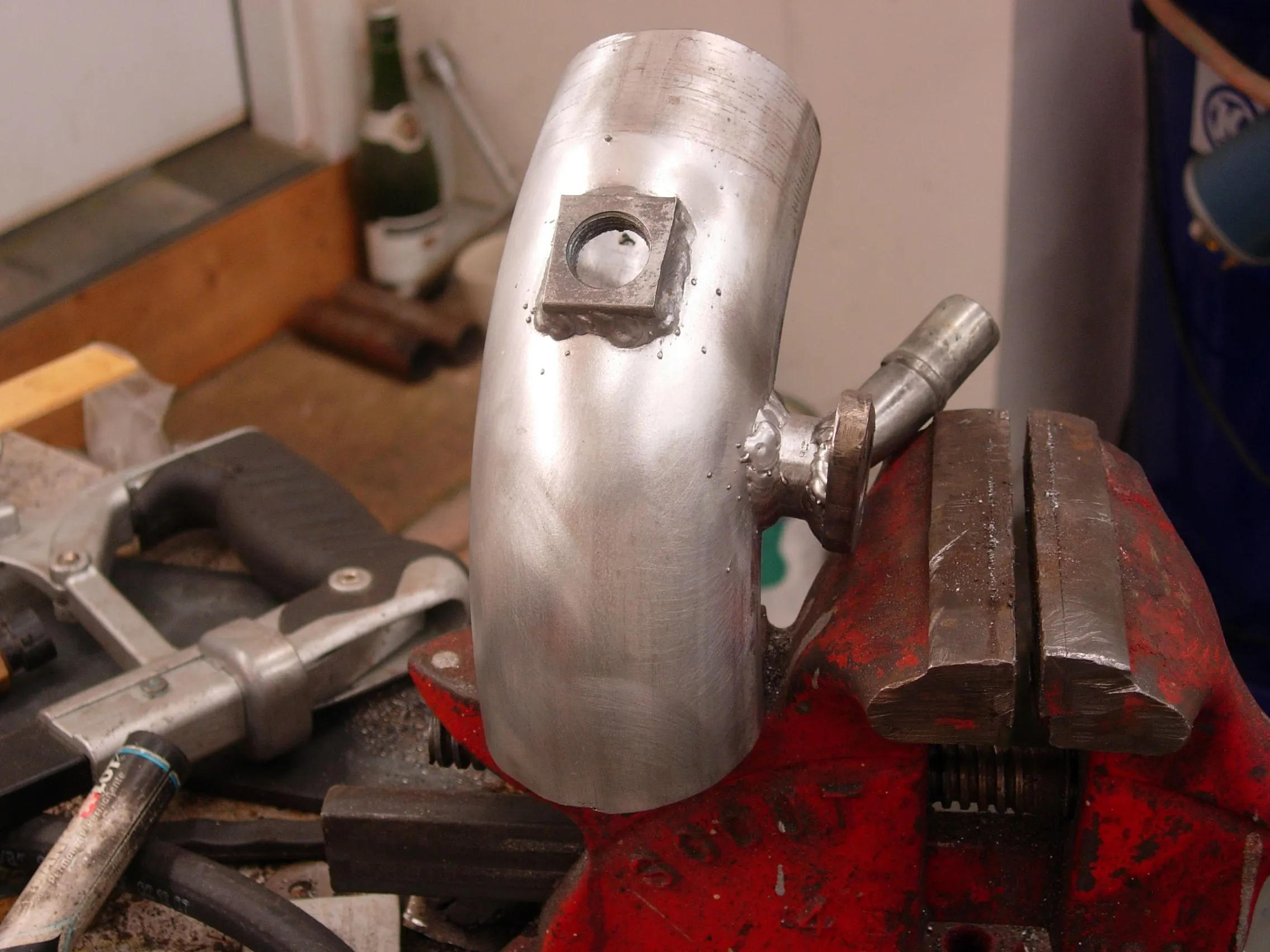

The intercooler piping between the turbo and the intercooler will be finished with a piece of about 12 long 1.75 ID hose from the GTX's intake piping. However, this isn't a terrible thing as it allows for engine movement without binding on the hard pipes. In a programmer's world, this might be considered and undocumented feature ;). I don't have pics yet of this as paint is drying on that portion of the piping.
Secondly, the biggest rigging thus far is the exhaust. I needed to move the exhaust outlet back as opposed to dumping it from just under the engine. For budget purposes, I didn't want to spend the money on a length of 2.5 piping. Fortunately enough, I procured a rather nice amount of 3 piping from a trash can at last year's Challenge (including a Magnaflow muffler with dual outlets). I think it was from a Neon. Regardless, I used it and performed quite the hack job of fitting it to the 2.5 down pipe. This will be corrected after the Challenge. Nonetheless, it serves the purpose.
All in all, I'm about 95% finished under the hood. All of the IC piping is constructed, cut, and fitted. I'm just waiting for paint to cure on a few pieces. I finalized the elbow leading into the throttle body with fittings to allow for the IAC inlet, IAT sensor, and BOV. Furthermore, I have plumbed in all but 2 holes on the turbo: the compressor inlet and water return. The oil supply was made as a hard line from old brake lines :). The water and oil supply was sourced at the OE locations on the block that are, by default, plugged from the factory in U.S. applications....reliving the BG 1.8L GTX/GTR days :).
