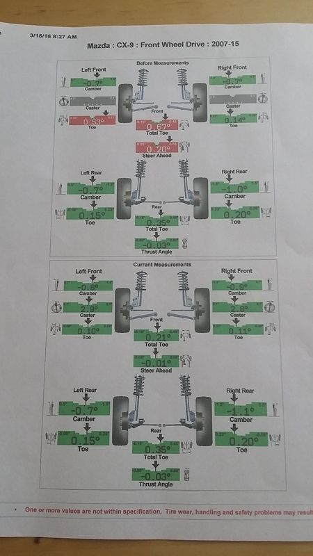

"Performed alignment" is a sham.
I have proof. I just had my car aligned this morning because I got my CX-9 back with a 30 degree tilt in the steering wheel.
Here is proof they didn't align it. Have a look for yourself.
I would send all that to Mazda usa..asking for reimbursement. ..now about your alignment print out....your rear camber is worse after with 0.4 difference....wtf? 0.2 diff. is the max I would allow them to leave it at. Thoughts?

I walked into the dealership here in San diego no questions asked by the service manager. They replaced the lower control arm, aligned the front, and even washed the car for me. I made sure to check steering wheel alignment and all is good.
Yeh, mine was aligned too. Have print out and car trails well. No wash though...damn it!! New bushings, new end links but LCAs look reman or something along the lines. ...new black paint with rust spots...not sure paint covers rust or new painted metal starts to rust...

Front wheel alignment was performed free of charge, and a minor adjustment to the toe was required. The tech said that the drivers side ball joint had excessive play present. The steering feel does seem improved with a noticeably tighter impression in the wheel. I also just inflated my Parada Spec-x tires to 42.5 front and 42 rear.

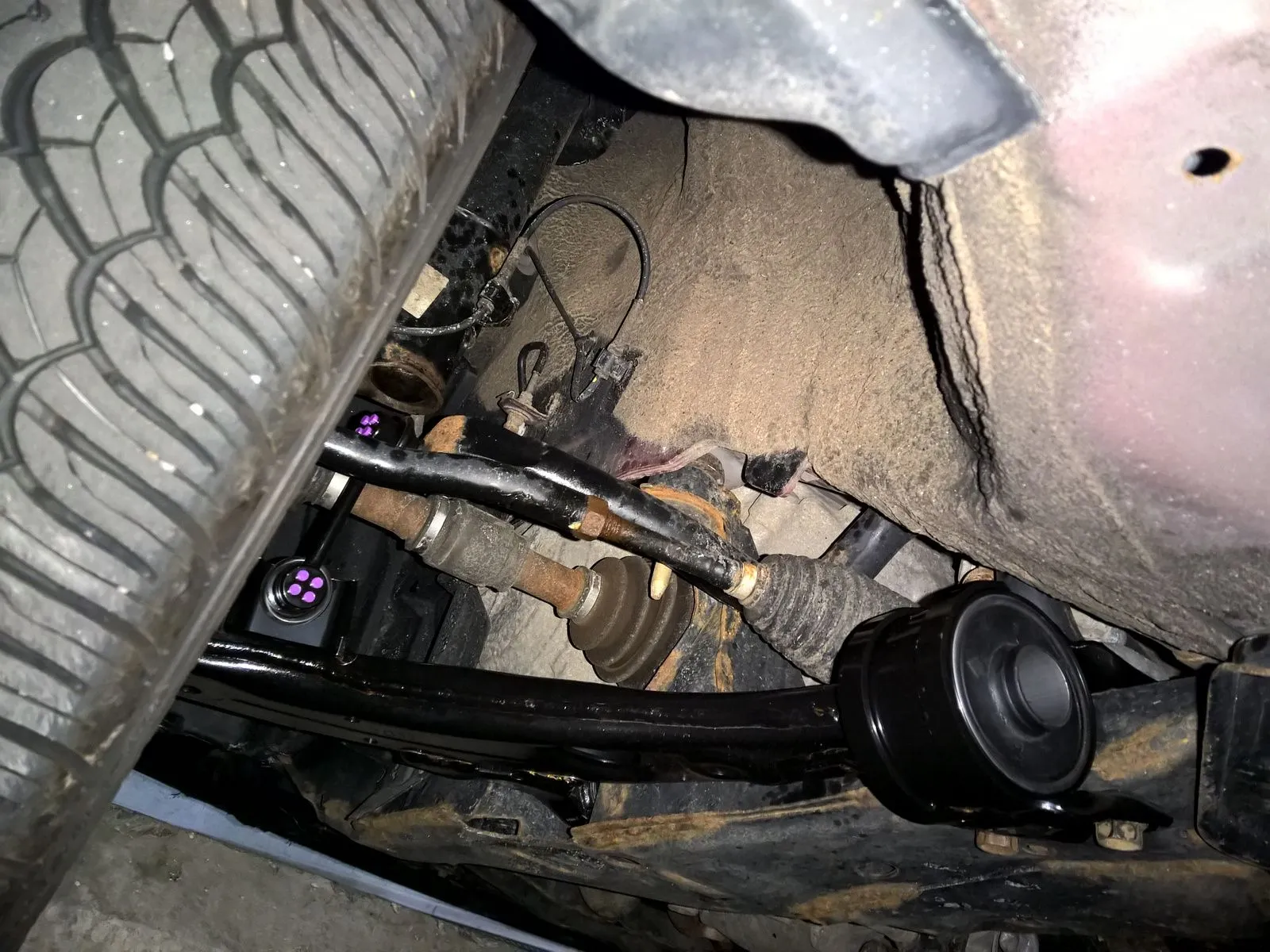

I just had mine replaced last month. They are already showing rust... especially on the wield seems. I called the dealer service department that replaced them, and they were not concerned. I told them my old controls arms had no rust but you all replaced them anyway... and now i have control arms with rust. They scheduled me an appt but will probably just give me a half arse lesson about why the sky is blue. Problem is, I was an aviation elctronic tech in the Navy, where corrosion is your worst enemy. I know what neglecting rust can do! I should just treat the areas, which includes rust on the housing that holds the ball joint, but I would rather let them deal with it.

I wouldn't worry about that either. Basically road debris "sand blasted" the paint off the surface.
I'd be surprised if your original control arms didn't have any rust.
Also, the rust that is part of this recall is in the balljoint, not on the control arm.
