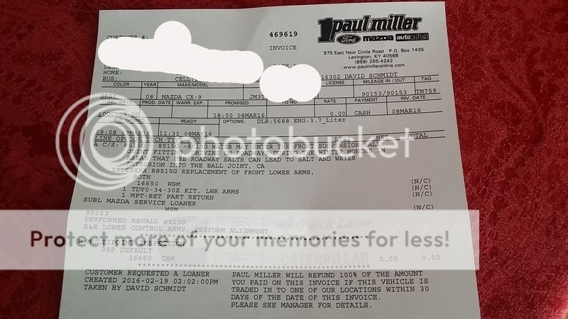

whoa, you just posted your name, address, phone numbers, and make/model & VIN number,
just a friendly recommendation: I would black that out quick, who knows what nut online will try to steal your ID.

recall performed 1/30/16, excessive tire wear 3/11/16, wonder if Mazda dealer aligned
I am at the Mazda dealer to have them look at the car. The outer edges of both front tires are worn down to secondary rubber. Tires are less than one year old. AWD. Rears are pristine. I wonder if dealer was supposed to align during recall 8515G and failed to do so. There is no note on the service record re alignment.
Waiting room, expecting to hear some BS story.
Opinions?
Opinions?
Yes, they must complete an alignment as part of the recall.
As for my wife, they completed the recall(I assume) yesterday without and hiccups....well, except for the fact that the transfer case needed to be replaced as well(not due to the recall).
OK, I also have to question the alignment. The invoice does not specify anything about an alignment. Can someone confirm that an alignment is necessary and should it appear on the invoice?
If you are changing control arms, I would think it would require an alignment or at least a check. Maybe they don't list it on the invoice and is included in the recall work, but I would expect an alignment report.
Necessary or not, you should press them on it. If the recall states that the dealer perform it, you need to have the dealer clearly explain to you why they would not perform it. Unless they did a check and everything was within the proper tolerance, they should be doing it under the recall. Mazda reimburses them for the work, so there is no reason not to do it.
If they did alignment u should get the print out....no proof no alignment

So....guys who have completed recall service. ..who actually has alignment print out in hand?
Sent from my SM-G900V using Tapatalk
"Technician found the front lower ball joints in the lower control arms
Replaced the front lower control arms, front sway links and performed alignment."
That's what my invoice says.
