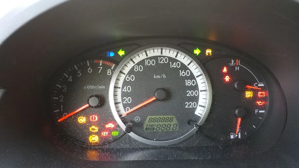

In addition to my question about the part number: Can someone tell me where the cruise control indicators on the dashboard are located? If I run test mode 26 all dashboard indicators light up, but I don't see any cruise control indicators. ("Cruise main" and "Cruise")
Does this perhaps mean that my car does not have pre-programmed cruise control? If so the buttons and brake switch I bought will be useless whilst somewhere else on the forum I read that all 2006-2009 M5's should have the preprogrammed CC :-(
In the meantime I figured out that in my 2006 M5 the DSC lights are on the spots where the Cruise Control lights are supposed to be. On a Cruise Control equiped car the DSC lights are on a different location.
I reckon this means my car doesn't have the CC pre programmed so I decided to cancel the order for the buttons.

Wonder if a European Mazda5 owner can take a picture of the cluster in test mode to see all the lights on - then post it here.

@Typhoonk123456: I read on a Mazda 3 forum that in case of the M3 if there are no CC lights in the instrument cluster it can't be added either. I reckon this will be the same for the 5. No going to take the risk trying it.
Regarding the instrument cluster, this is mine, a 2006 1.8 Exclusive Sport from Germany (imported into the Netherlands):
attachment.php
(ignore the dust, I need to clean out the car ;-))
