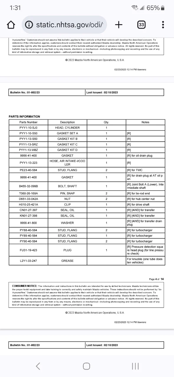

I've been out of the loop for a while. Can you please refer me to the source info for the new OEM redesigned parts? I was not aware that Mazda had made these available. I'd like to have a 2018-20 Mazda again, but the cylinder head leaks on my old one have really put me off as at the time the only replacement parts were the same ones that failed before.
Here are the new parts:
Head link:
