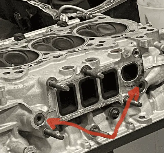

The failure as described by the dealer for my engine was a warped head caused by bolts leaking coolant and therefore the head overheating. I've pointed out the bolts in the photo below. These are at the exhaust manifold, so I suspect they changed that part of the head and therefore needed a new exhaust manifold gasket for the redesign.
So, are you now saying that in addition to the redesign of the "head and exhaust manifold gasket", that there is also a change in the head to where a different configuration exhaust gasket was necessary to mate?
I suspect that the modification to the head is related those leaking bolts/plugs and therefore requires a different exhaust manifold gasket. The exhaust manifold bolts on directly adjacent to those bolts/plugs. All speculation at this point.
This is interesting because my issue was not described like this. The dealer told me that the block cracked, and that's why I was leaking coolant. I never experienced any overheating, and it was found because I said "I smell coolant" and could have been potentially overlooked for a while longer. Does this mean we're looking at two distinct issues (with different root causes) that happen to have the same resolution, or just different symptoms of the same root cause?
I hope there's not more than one issue to bring about possible failure.
My guess is that the problem is not conveyed accurately to the customer.. Therefore we are actually telling different stories due to the inaccuracy of communication from one person to another.
What is likely happening is that the head is developing hairline cracks at the holes where the exhaust manifold bolts/studs go, due to cyclic thermal stresses. That part of the head gets really hot when the engine is running, it is made of aluminum which expands quite a bit with temperature, the manifold is bolted to it and made of a different metal that's expanding at a different rate, and the holes act as a stress risers, so a lot of stress builds up in that area. When you shut it off, everything shrinks back to normal, ready for the next cycle; now repeat that 1000's of times. All that works together to cause fatigue cracks to form in the aluminum and grow. Unfortunately, in this case, eventually the crack reaches the coolant passage in the head and starts to leak.
There are other engines that are prone to cracking in this area, this isn't just a Mazda problem. However, in a lot of other engines the cracks don't make it to the coolant passages so you'd never know they were there unless you were digging into the head for other reasons.
This sounds like a very viable hypothesis. The original diagnosis I received from the dealer was also a cracked block. Not sure why they can't get their diagnoses straight. The final diagnosis was the warped head and they provided quite a bit of detail regarding it when I went to see the engine and car in many pieces.
Now we are getting somewhere! Thanks for the pic and explanation!
