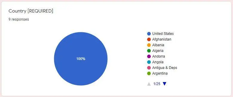

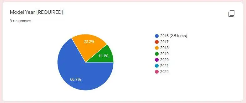

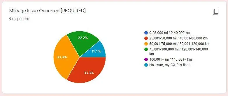

Stats from just 9 responses so far lol
(FYI forms link, pls share in your cx9 communities: https://forms.gle/ZwE3En5KNrLLPbyB7)
