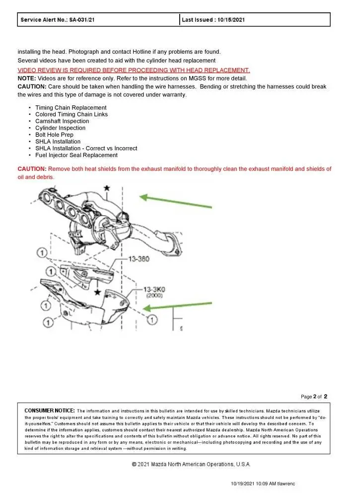

Note here "cylinder deactivation models only"
