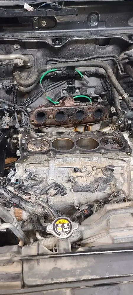

We never remove the engine, requires the subframe to come down and a LOT more work afterwards including an alignment. I'm also not sure how you could do this job without removing the timing chain altogether, because both cams come out during the head replacement and the actual timing chain cover is bolted in some places to the head. The job is a messy pain in the rear, and warranty pays next to nothing compared to CP. But right now during slow season we welcome this sort of work. Just a shame it's happening, but luckily every single repair we have done has been covered by Mazda with the customer in a rental. Sometimes for weeks or months.
... I'm also not sure how you could do this job without removing the timing chain altogether, because both cams come out during the head replacement and the actual timing chain cover is bolted in some places to the head.
I got my wires crossed on that, thinking about the switchable HLA replacement procedure instead of this one. I've been looking at lots of TSBs related to these vehicles, and sometimes they all just start to run together. Sorry about that:rolleyes:
