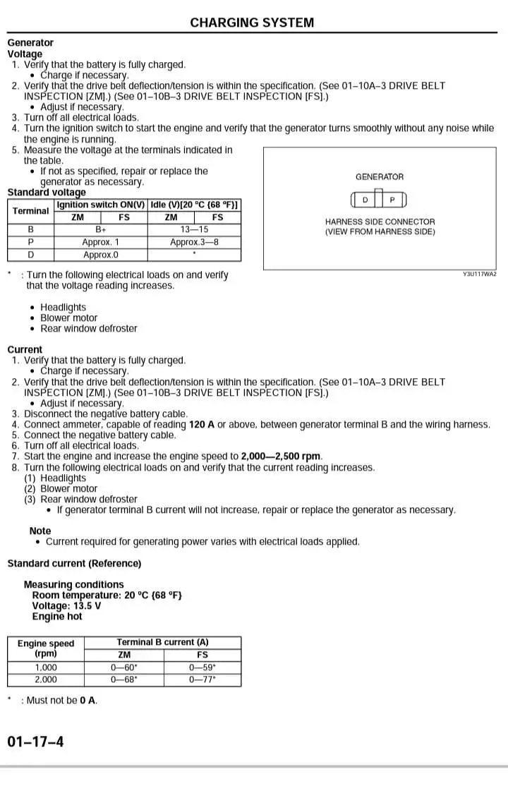

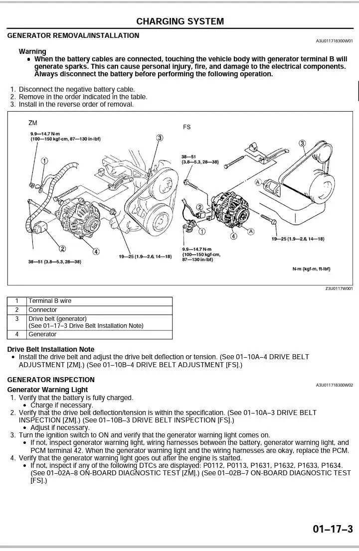

This is the info for the alternator on my car.
It's a bit different in that the regulator is in the ECU and not built into the alternator.
I don't know about the 1999 Protege?
This is a link to the Factory Service manual for my car.
It may be of some use to you, but I don't know how the 1999 Protege is different?

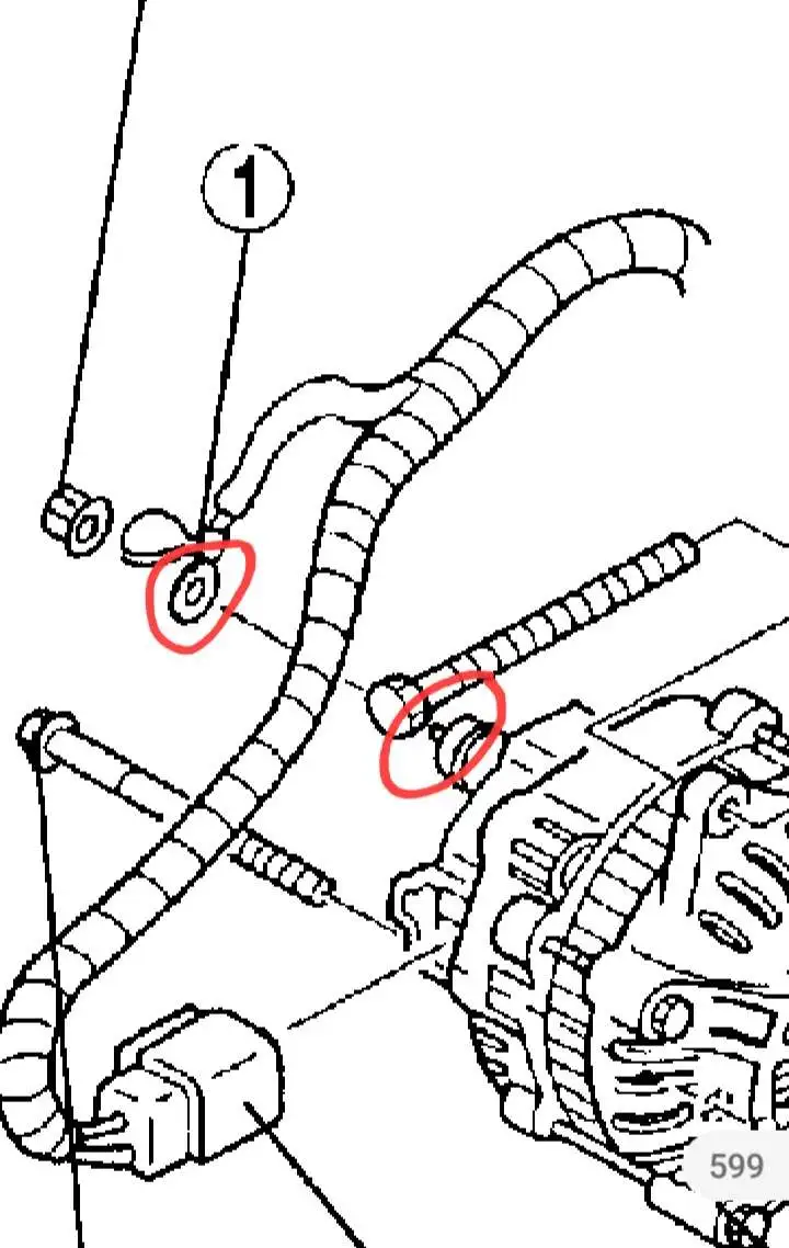

So I have checked the alternator to see if the wire was making contact it is I don’t think it’s the alternator because it is reading no resistance when I put it on the post and on the metal of the alternator
