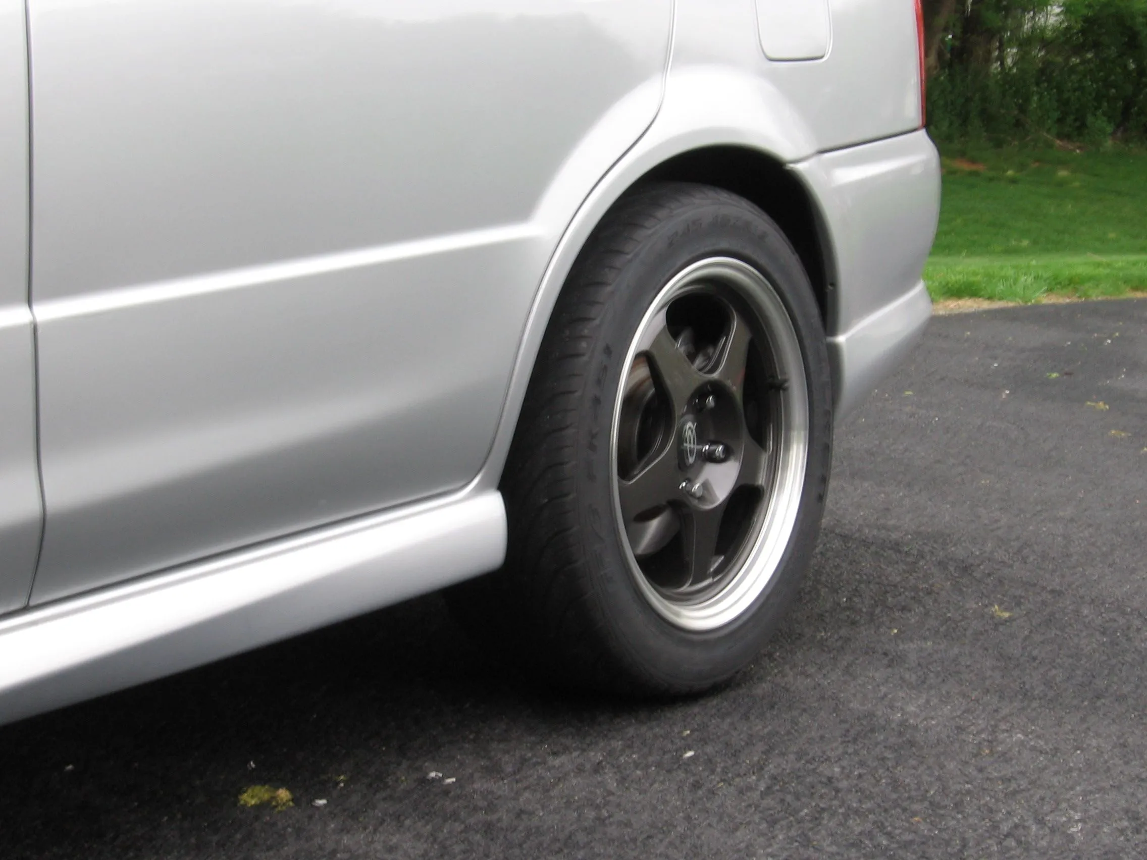

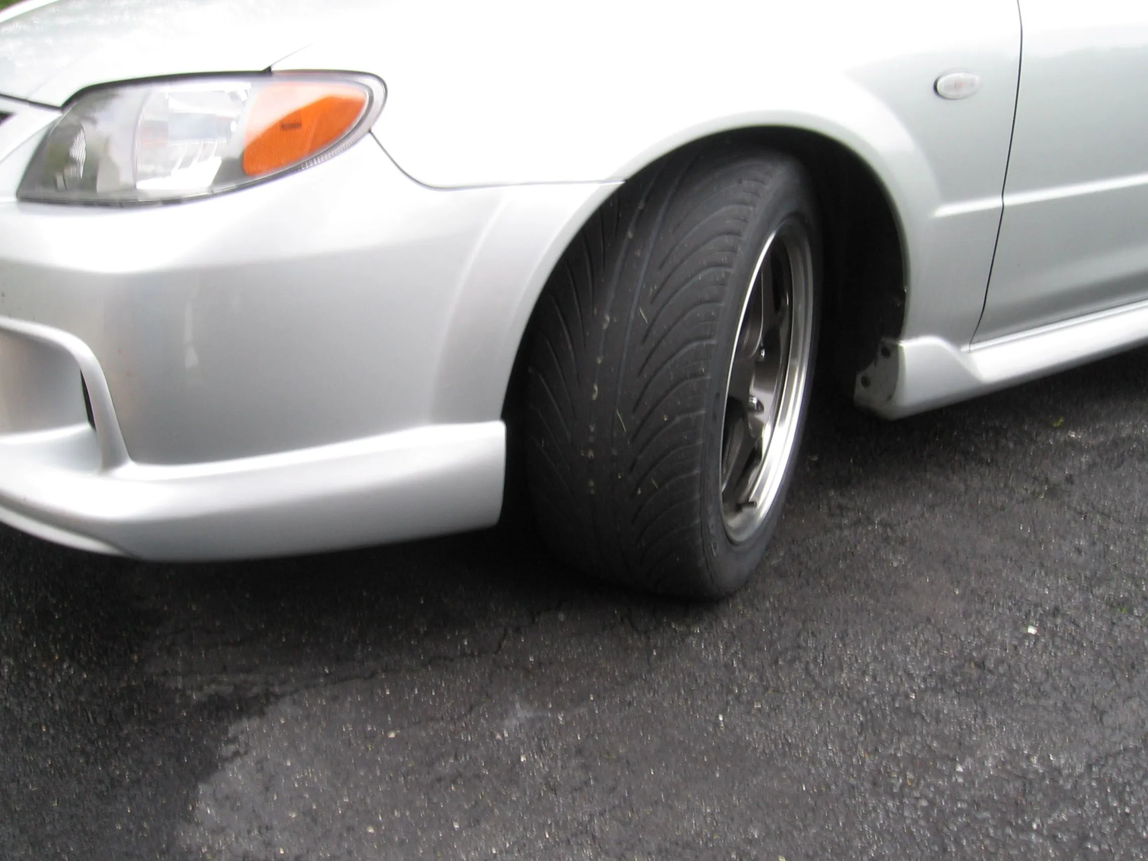

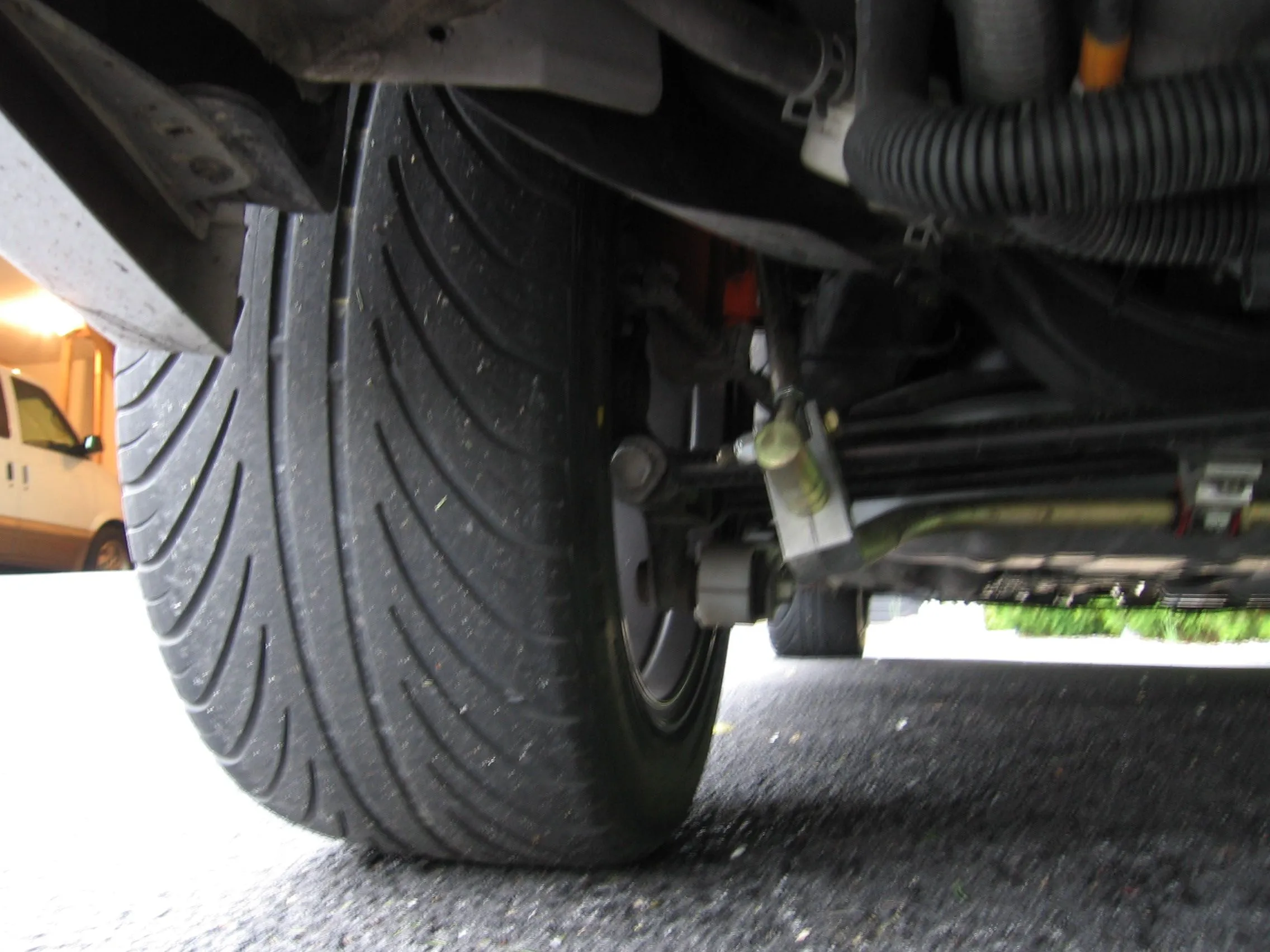

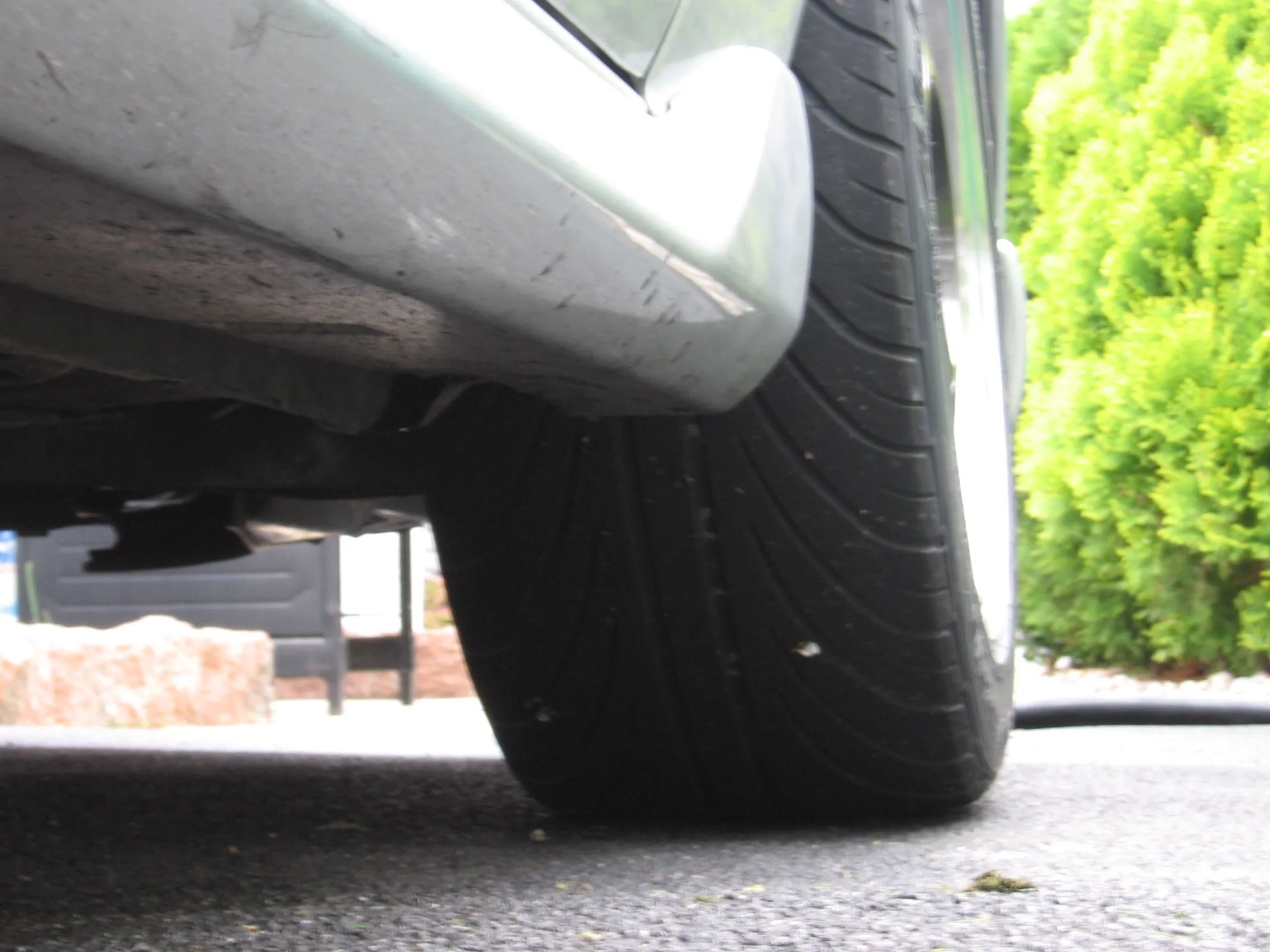

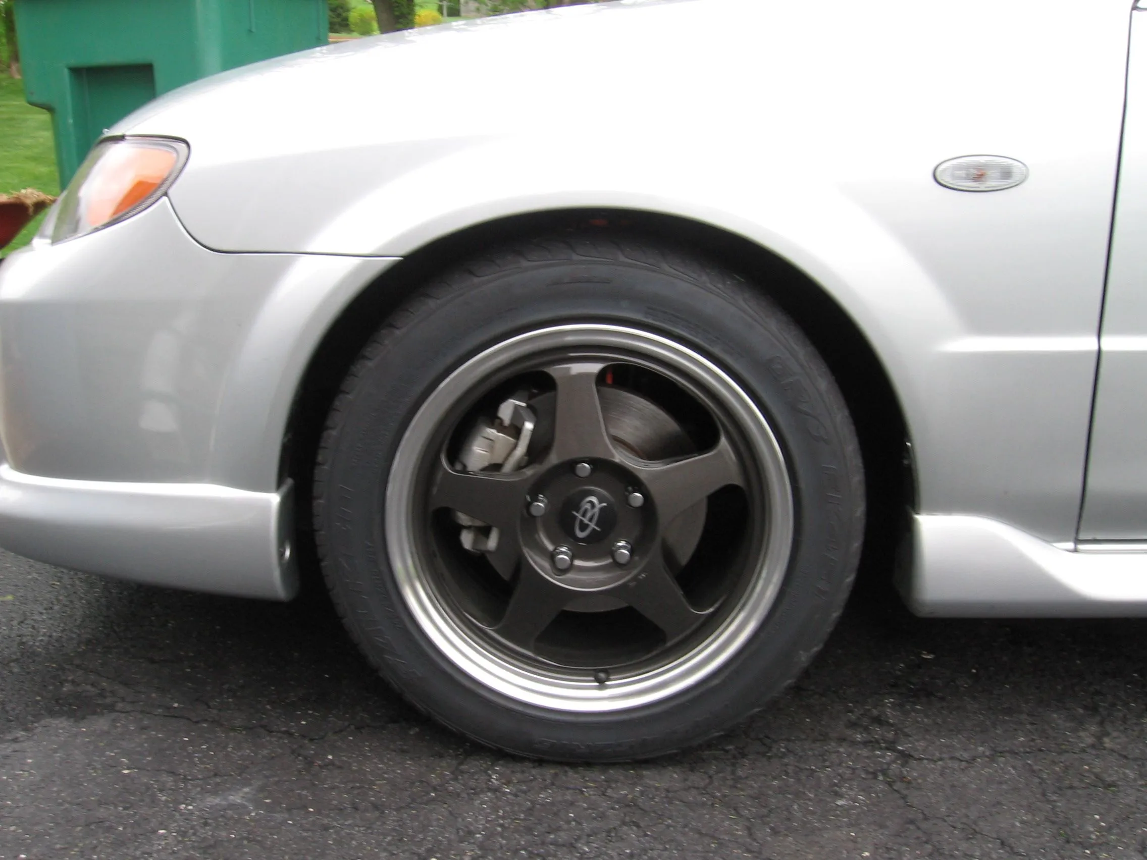

Well peoples..we've got them mounted and holy schmoly are they W-I-D-E. The car looks like a steamroller coming down the road. NO RUBBING. The car is still at stock height but it looks like we can come down an inch or so. We ended up using spacer to make the fit a little more comfortable. 5mm on the front and 3mm on the rear. I'll take some pictures soon and post them.

I am running a 45 series tire so the overall OD of the tire may be less. Also I am on heavier springs so the car does not roll much. The other factor is negative camber. You'll need some to fit the rear tires in the fenders. Right now for street setup I'm at -1 camber all around. Race setting with the 245's is -3 up front and -1 rear camber. I am no longer running spacers on the rear of the car so that I can get a wider track up front of +10mm. The car handles VERY well.
