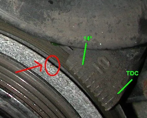

So I'm trying to do this today. I bought a timing light. I'm having trouble.
I'm following the directions off Miata net.
http://www.miata.net/garage/ignition.html
So I see this
http://www.miata.net/garage/timingmarks.jpg
But where the hell do I put the white out mark?
Begin by finding the big pulley on the front bottom of the engine, there should be a little hunk of plastic to the top right of it with markings on it. On the back rim of the pulley feel around until you find a notch in it. It may require turning the car on and off a few times until it is in a reachable location. When you find the mark, put a dot of White-Out or something on it to mark it (you know, the stuff that covers ink-pen errors). This photo shows the plastic thingy and the little etched timing notch.
There's no way in hell I can squeeze my hand in there to feel the back of the pulley and find the "little plastic thing" unless I remove the radiator.
Here you go, Christian. The notch they are talking about is circled in red on the attached picture. It's a PITA to find, but fortunately, it was in the shot when you snapped the pic. I also labelled a couple of timing marks.
EDIT: Is your water pump leaking? I noticed a small green blob on the alt/wp pully just above my red circle. If it's leaking, replace it ASAP.
Thanks a bunch -- will give it another go. I guess you might have to start and stop the motor a bunch of times to find that tiny thing?

Remove the plugs and turn it by hand.
if you cant see it with the timing light then the pully might be greasey/dirty. clean it. If not them maybe your gun is not the right set up right. Remember the miats is distributerless
