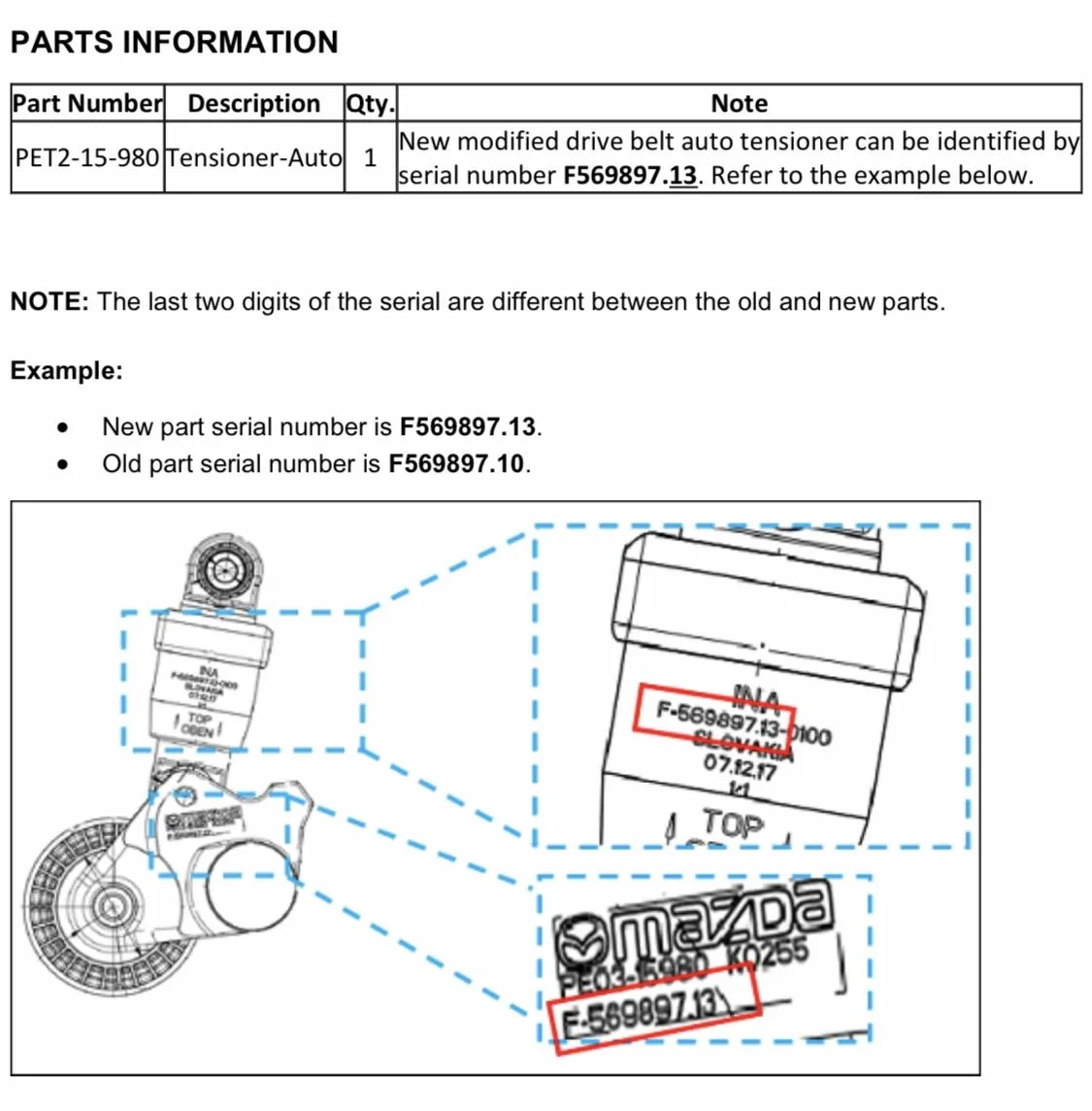

From the TSB:
Description:
Some vehicles may exhibit oil leakage from the drive belt auto tensioner and rattling noises from the engine compartment. This may be caused by insufficient sealing at the drive belt auto tensioner damper when the auto tensioner fully operates under both high ambient temperature and high load conditions. To eliminate this concern, the shape of the drive belt auto tensioner damper has been changed.”

TSB: "This may be caused by insufficient sealing at the drive belt auto tensioner damper when the auto tensioner fully operates under both high ambient temperature and high load conditions."
It's difficult to confirm what version you are actually getting. Resolution: Come in to the dealership parts department to see which ones they have in person. Otherwise if ordering online they can send you outdated versions.
The OEM INA ones look acceptable for what we need the part to do but the Gates one looks like a more refined part on the outside at least. The OEM water pump and belts are reliable. The weak spot of the belt system IS the tensioner. Keep in mind Gates makes the waterpump, both belts, and the tensioner as options for all skyactive engines. Viable options for the tensioner would be the latest version INA tensioner (tricky to get?) and the Gates one.
Edit: TSB clearly states to check for version 10. If so and leaking to replace with version 13 under warranty term. Taking a closer look at version 13 in the TSB illustration it looks to have a shape like the Gates now. On the top part, the version 10 and under has a "top hat" shape whereas the version 13 and Gates have a full square head shape on top. Only way to confirm is to get a version 13 in person. :) Say no to the top hat shape!

The TSB is for 2013-2019 CX-5. And it can’t be just a single version “10” in serial number which is having the oil Leah problem. We’ve seen people who have version “7” developed oil leak too. I‘m most curious that what serial number and part number are on the tensioner of your 2013 CX-5 which is still doing fine? We’ve to wait until you’re replacing the serpentine belt to find out?
I have difficult time to follow your finding on "top hat" shape and full square head shape on top between old version and newer version on OEM tensioner.
And please check the Mazda part number stamped on the level of your spare tensioner and let us know?
Its the same part for all Skyactiv models. TSB indicates all skyactiv models at the time of print: https://static.nhtsa.gov/odi/tsbs/2019/MC-10168785-0001.pdf
APPLICABLE MODEL(S)/VINS
US Spec.: 2016-2019 CX-3 2013-2019 CX-5 2016-2019 CX-9 2016-2019 MX-5 2014-2019 Mazda3 2014-2019 Mazda6
Mexico Spec.: 2013-2019 CX-5 2017-2020 Mazda6

You are correct, the TSB merely illustrates the version 13 tensioner when the spring is compressed (non-top hat shape). When non compressed its then a top hat shape. The Gates part covers the top spring even whether the spring is compressed or not. They may be implementing a different way to keep the oil from leaking. All hidden in that black plastic cover.
A person with the version 13 could probably attest to how easy or harder it is to open the rubber seal top.

So you can’t see the part number below the Mazda logo on the level of your spare tensioner as illustrated in the TSB?
My spare is version 10 made on date 2018. Inside facing as part number F-569897 10.
No, not the serial number. See the illustration where you can see the Mazds logo and part number such as “PE03-15980 K0255” here:
My spare says PE03-15980 K0255
Interesting. Your package has part number PET2-15-980, but the tensioner itself says the part number is “PE03-15980 K0255” (PE03-15-980) with serial number “F-569897.10” ⋯

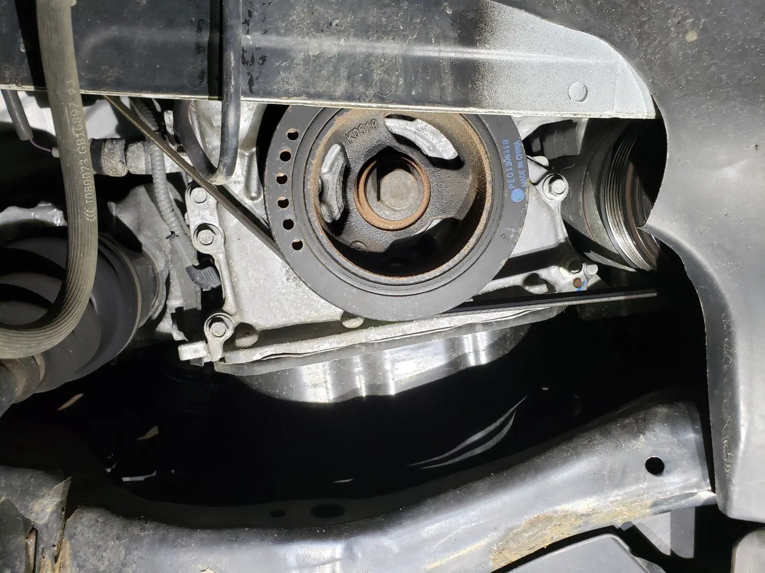

OK, I'm a failure! I did NOT replace the belt tensioner or belts today. I got all ready to decided to due the "take-off-the-right-front-tire-and-splash-shield" method. I did that and unfortunately, unlike the Mazda3 in the video, the belt tensioner in the CX-5 is in an almost impossible position. I gave it a shot but I couldn't even release the tension to remove the serpentine belt. So I closed it all up and I'll bring it (and all the parts) to my favorite mechanic and let him have all the fun! To be fair, this is "probably" DIY doable if you have a lift since the working position would be much better, but I don't have a lift.

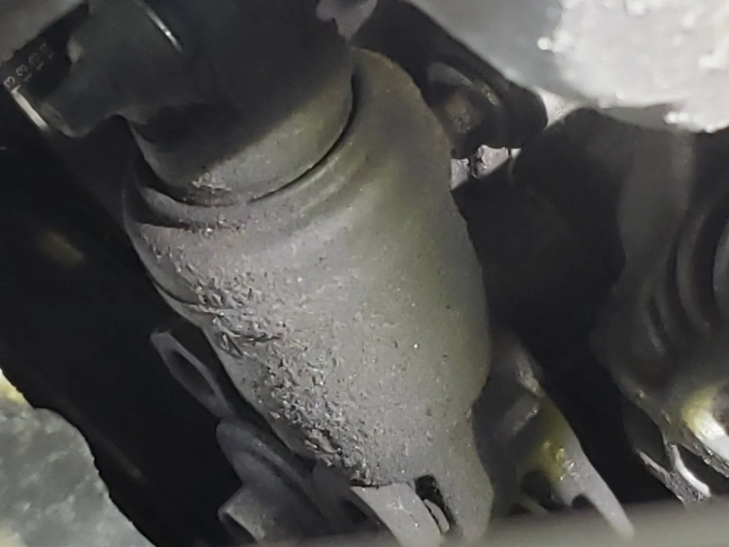

This is a picture of my dirty tensioner. Leaking? Beats me, but it makes no noise.
And after removing the tire and the splash shield, here is the view. Lots of metal in the way of where you need to get too. Tried both from this angle and the top before I gave up. Can't imagine that the standard shop time for the swap is .4 hours of labor!
Thanks for the info. Now we know accessing the tensioner from wheel well doesn’t work for CX-5! Did you keep the old tensioner where you can check the part number and serial number stamped on the tensioner?
I haven't taken it to my mechanic yet. But I will ask for the old part when I do.
That’s so weird. I was able to remove the belt and tensioner just fine with the wheel and shroud removed. The tensioner pivoted pretty easily with a wrench applied to the proper spot.
