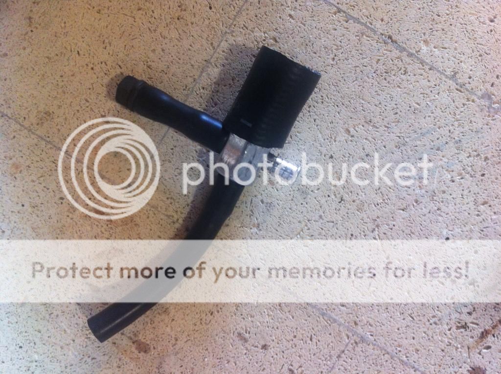

Hey guys, I got one for you.. A question, that is.
I pulled out my manual boost controller to see if it would help my over boost problem. And the biggest difference is I now have the damn turkey again!!
It's odd I know ( compliments of original owner ) but I don't understand how a a tiny section of tube and a lil MBC (which is turned all the way out) could make a difference to my by-pass system.
Anyone got any ideas why??
Relevant info:
hard pipes with 1' bypass fittings
1" boost sciences BPV
Gutted exhaust
Before
(W/ MBC)
spikes to 10 or 11 psi holds at 8 psi
No turkey, instant bypass
After (Without)
no spike holds 8 psi
noticeable compression surge
ANY insight would be much appreciated!
