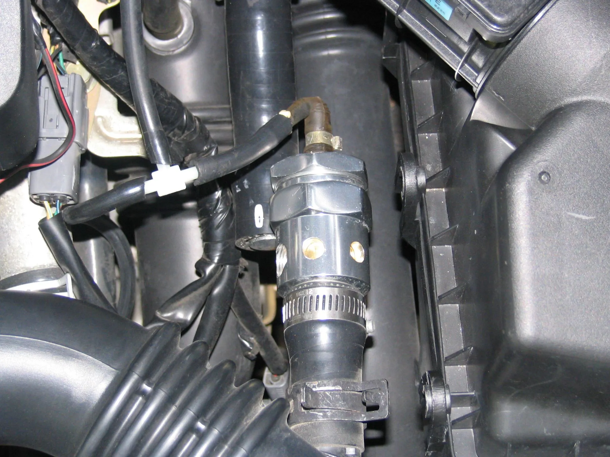

could you like , post pics of under the hood ?
if you have a bov, you have hard piping.. made of metal.
you might even have a font mount intercooler.. or side mount.. follow the piping from the engine going top the font.. and take pics.. and post them here..
12 psi on stock s*** is a problem waiting to happen

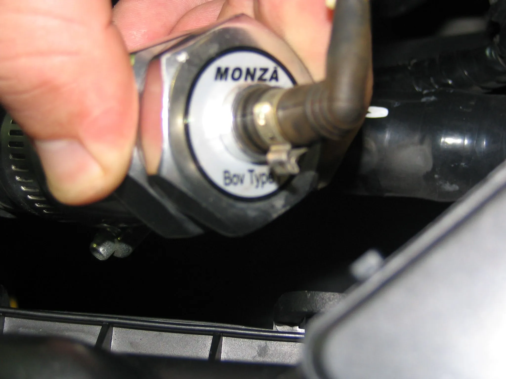

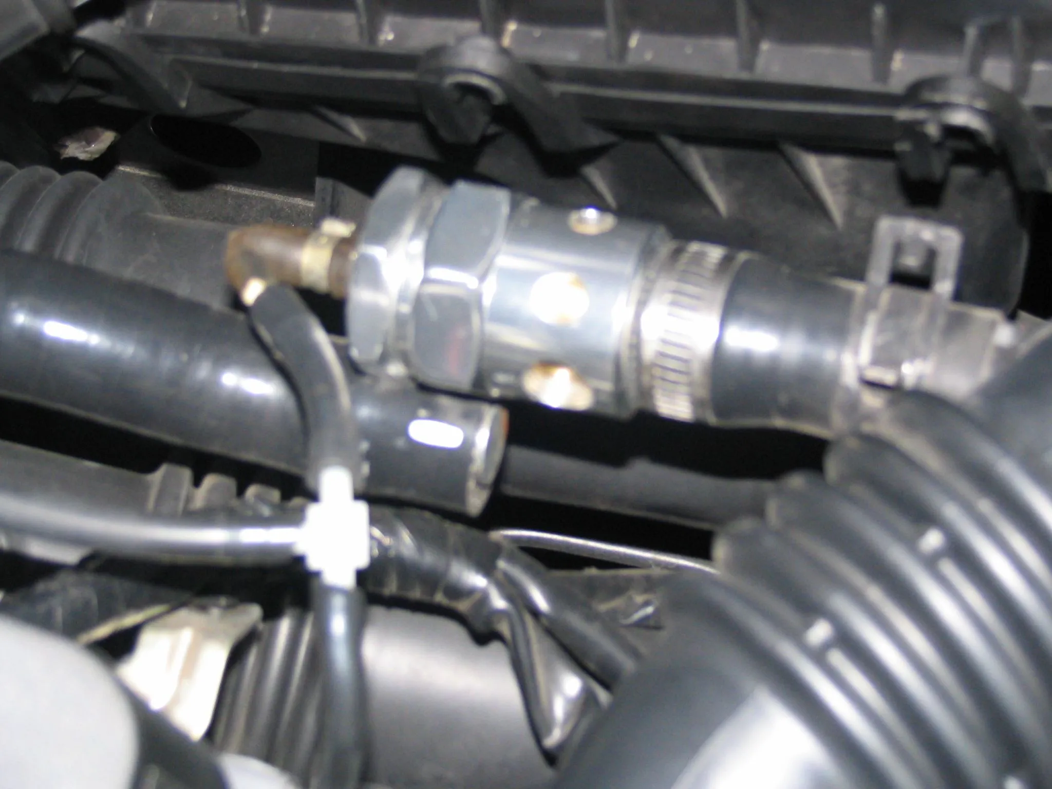

Here's a few pics I took the other day before I cleaned up the BOV install and put in the intake. Like I said, I used the over-enthusiastic boost as a bargaining tool when I bought the car. My sales guy tried to say that all the mods were done right and it should add value to the car. I quickly smacked him down with the "double stock boost and stock internals = grenade motor" argument. He adjusted price accordingly.....

the mods were done right and add calue to the car...that is the biggest load of crap i have ever heard...and after seeing the crap job the last person did on your BOV i think that is even more ridiculous...god i hate salesmen...
Did the DPO hack into the return line where the BPV was? He didn't leave behind the BPV for me.....
If that's the case then I'm a pissed because I just read up on the BOV/BPV duel system and I have all the stuff here at work to plumb in the air manifold block.

I'd question that setup and how the car may have been treated before. It looks like it was thrown together very carelessly.
I found the problem with the boost guage. The DPO hacked into the MAP sensor line for his boost signal reading. Thus, I was seeing manifold + barometric pressure on my boost guage. I put a air manifold on the brake booster line after reading up on a few threads. All my lines have been re-routed and I now get stock boost levels on my guage! That makes me feel much better about my purchase.
I still get some turkey at light boost, but I may just need to adjust the BOV some more. I would really like to put my BPV back in the system, but I do not have the part. Any suggestions on how to make one or something I can put in the recirc. line to act as one? I don't have $120 to shell out for a Forge and the factory part is crap from what I read. Here's a video I shot of my existing setup and the idle problem after blow off. I need to get some silicone lines and toss the plastic and rubber line.
You've done a good job cleaning up the hackery done by the previous owner.
