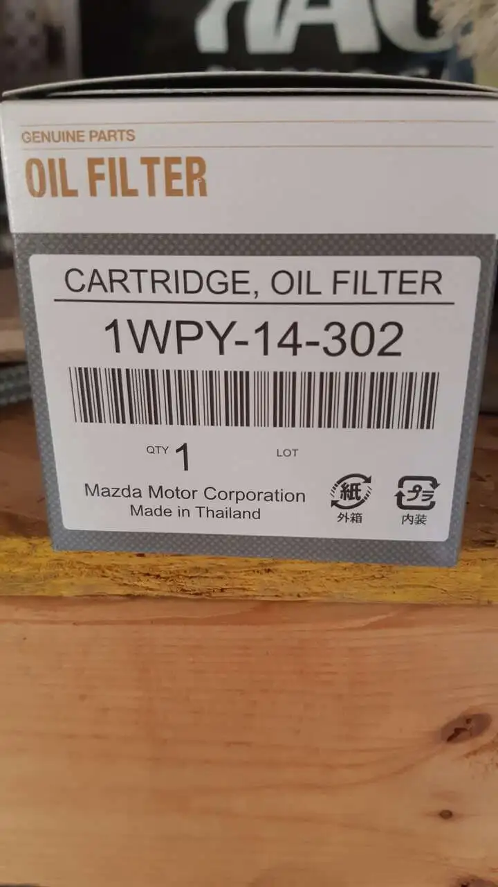

For the 2.5T, factory PY8W-14-302 Japanese Tokyo Roki oil filter found on the new CX-5’s has been superseded by the Thai made 1WPY-14-302 Denso oil filter only in the US market since Dec. 2019.
Like Buzzman12 said, 2.5T uses different oil filter than the one used on 2.5L.
Not mine.
See below photo of part# cx5 oil filter 2021 turbo. It looks like the last few years from 2018 to 2021 have same part#. The filter part# is not in my manual. Best to buy filter from dealer and washer to be safe. Same price as no name brands!
Ok, i paid about $13 -14 Canadian$ for filter and washer, which is same as your USA quote in photo approximately.
Not sure but some online sites quote same part# for 2.5 and 2.5Turbo oil filter. I guess they both fit car and optimizing on parts. Just get from dealer oem and be dammed.
