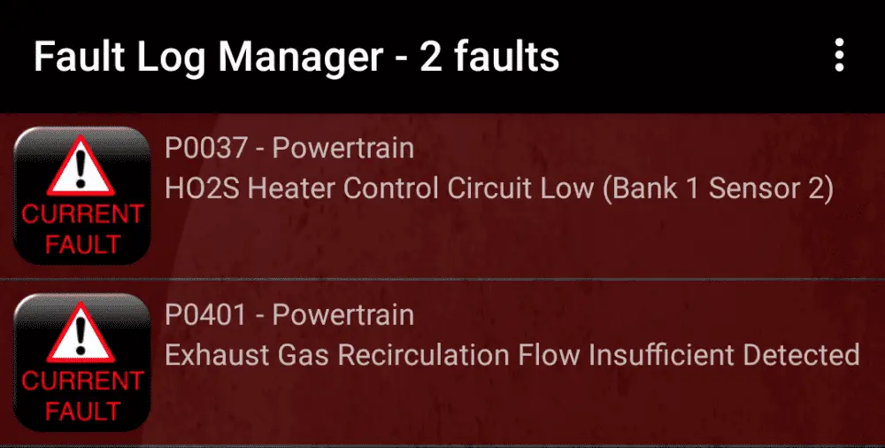

Still need to replace the rear O2 sensor, but now I have a P0401 for insufficient EGR flow. Just glad it's not a bad pre-cat. I've seen this code before and it never came back. I've heard bad things about working on the EGR for these engines. I wonder what will happen if I clear the code and just ignore it 😁
Your O2 sensor code should go away after you replace the sensor.
The EGR can be a PITA.
If your burning oil, you send unburt oil through the EGR valve where it condenses and makes the valve stick.
Some guys have to clean their valve every year.
If you do clean it, you'll need a stubby screwdriver (with a JIS screwdriver bit) or stubby 1/4" ratchet handle.
(I'm mixed up with the IAC?)
It's a b**** to do but once you've done it the first time, the next time is way faster and will be part of your yearly maintenance.

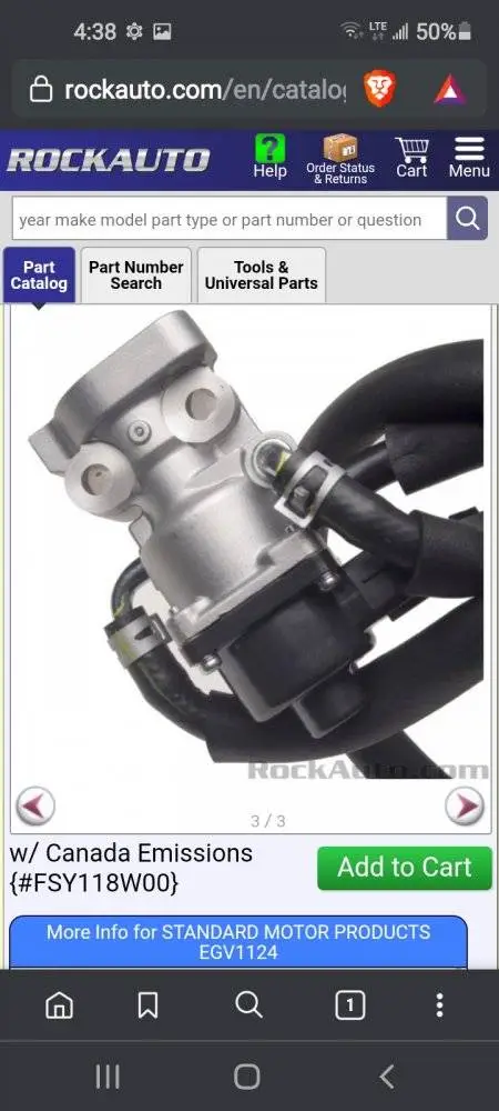

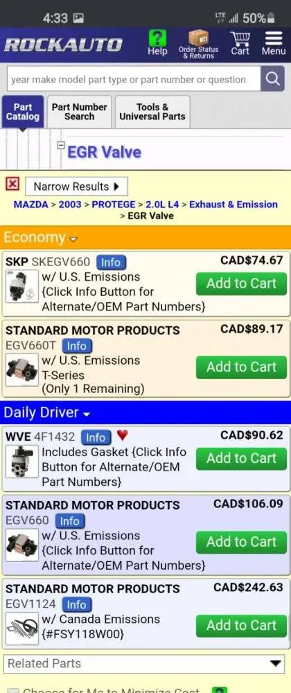

If you don't want to clean it yearly, there is the "Canadian" EGR valve available that will fix your problem for good.
(but it's a PITA to install.)
It's got coolant lines hooked up to it so it doesn't get fouled...
It's not just a Canadian problem, but we were first because it gets pretty chilly up here. Lol
You should be OK to clear the code and forget it, but it can end up getting so bad that your car will stall and won't resart.
PS...

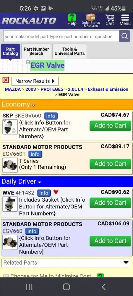

That EGR valve isn't listed for the protege5 at Rockauto.
It is only listed for the protege.
I talked to a mechanic who installed a few of them on P5's, and he said there was no problems.

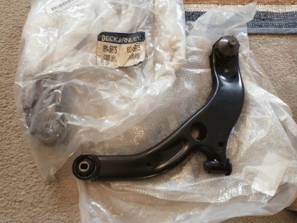

I replaced my LCA's with Beck Arnley LCA's.
They have been fine for years and come with a really heavy duty ball joint boot.
My problem was installing them.
There is a bolt that installs vertically through the one bushing, and I couldn't get it to line up without compressing the suspension by lifting it at the knuckle and loosening the bracket bolts a bit to give me some wobble room.
I put a pinch bar in between the LCA's and the knuckle, beside the ball joint and found movement in the ball joint, so I knew they had to be replaced.
The bushings were still in good enough shape. They are solid rubber (unlike the engine mounts) and didn't show and movement that I noticed.
I suppose the rubber bushings could weaken and get soft over time, but it was nothing that I could notice.
OK, done. I ordered the Beck Arnley LCAs and got them for a good price. The model numbers for the parts I got have been superseded by newer ones, so maybe these NOS parts have a better chance of being relabeled OEM since BA did that more in the past than now. (Hey, a guy can dream...) Picked up a four-piece pry bar set from Harbor Freight this weekend as I've always wanted some of those.

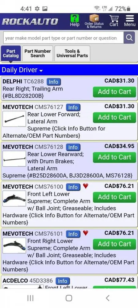

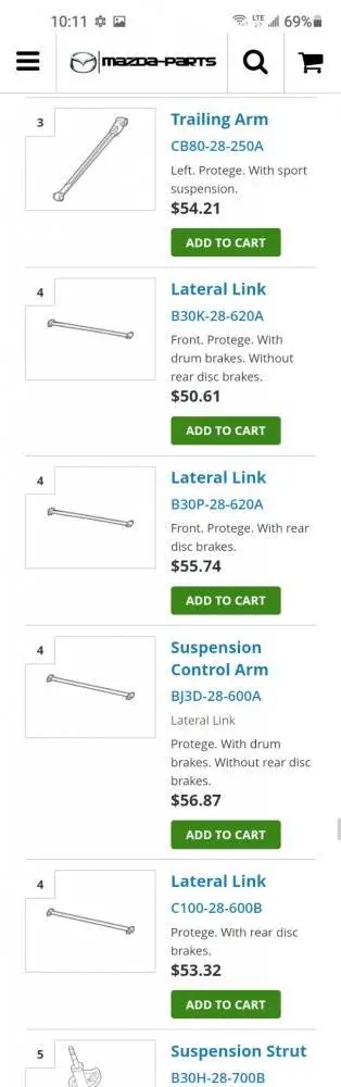

Just an FYI in case you replace your control arms...
The rear suspension components are kind of confusing.
These are some of the available parts for it.
All P5's came with sport suspension and disc brakes (at least in North America) and yet they are listing parts for regular suspension and drum brakes for the P5 ??
Rockauto was confusing too.
And I'm not sure if the regular Protege with the sport suspension option is exactly the same suspension as our P5's ?
I remember that there was all kinds of confusion about rear end links as well.
So make sure that you research your part numbers.
It looks a lot like the confusion about our engine mounts.

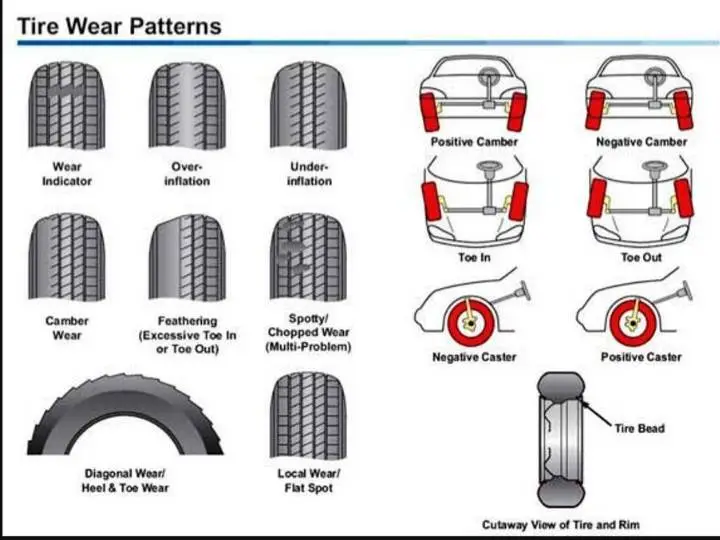

PS. Notice the car pulling to the right- will check the air pressure. Is there a way I can check if it's an alignment issue on my own and not bring it to the shop?
Thank you!
Take a close look at your tire tread and check for feathering and wear on the insides or outsides of the tread.
If the pulling to the right is a new issue, then it probably isn't an alignment problem because the alignment shouldn't have changed.
My toe-in was way off when I replaced my tie rod ends, but the car still tracked straight.
(but I was scrubbing off the insides of my tires. lol)
Caster and camber has more effect on pulling but on our car it shouldn't change because it's locked in by the strut placement.
If your toe in has been off for a long time, you could have scrubbed out enough of your inner or outer tread of one or both of your tires to get them to start pulling.
(They become tapered and don't want to roll straight anymore.)
If you have suspension wear, your wheels don't have any real alignment at all.
The wheels just float around and can pull to one side or the other.

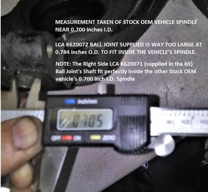

These boat anchors arrived from eBay and will need to install them at some point. Need to firm up my suspension for all the massive torque I'll be laying down with that new ECU... :D

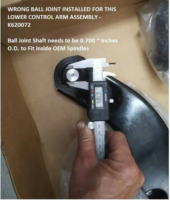

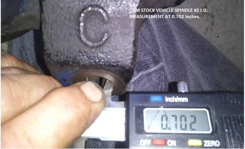

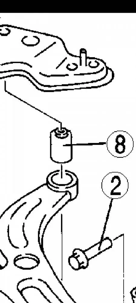

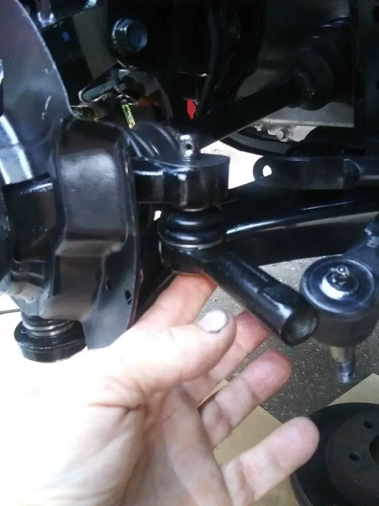

You might want to check Both LCAs Ball Joint's shaft Outside Diameters (O.D.) where it plugs into your spindles.
Also does your new LCAs have steel inserts or aluminum ones in the rubberized bushing that mounts to the underside of the body?
Just curious...

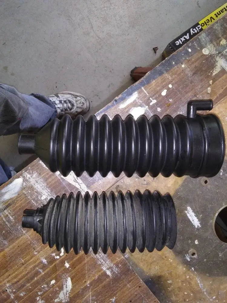

I received a LH LCA from an eBay seller whose company installed the wrong size ball joint into the LCA assembly.
Photos of what I sent them that I received vs my (and I assume yours and everyone else's) P5's ball joint spindle receiving holes are attached.
This is still unresolved (vendor name withheld) after another kit part discrepancy regarding rack and pinion boots wrong for out P5s in their 12 Piece Front Lower Control Arm and Suspension Kit for the P5s.
These two issues have (so far) wasted 3 weeks of time getting my son's car back together and resolution still in progress.
And to top that off, I just hit another parts snag yesterday evening on a LH steering knuckle that I bought as a paired set (from a different vendor) that I already got someone to press in new wheel bearings and hubs and didn't notice the problem until I went to install it.
That's another week or so now going to be lost rectifying that one... :(

  • eBay Order Steering Rack Boots Received Compared to Original- Boot Diameter and Length Too Big .webp
Just curious...

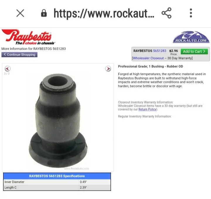

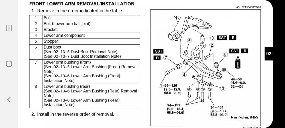

Just curious...
They seem to be steel if my my fridge magnets are to be believed.
I think they should aughta be steel.
They are holding the pressure of 68.8-93.3 foot pounds of torque.
Aluminum is a soft metal that will quickly compress/wear out and get sloppy.
Those metal sleeves need to be ridged spacers.
The problem with steel spacers, is that the bolt rusts solid inside the sleeve and seizes.
When you reef on the bolt to remove it, the spacer rips free from the rubber and starts spinning...
Then you have to use the angle grinder with a cutoff wheel, or a cutoff saw between the bracket and control arm to cut through the bolt to get them off...
I still prefer metal spacers.
I got my old control arms off and coated the bolts and sleeves with antiseize.
