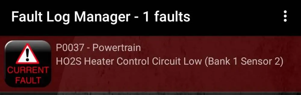

DANG IT! You guys jinxed me with your O2 sensor problems.
Saw the CEL this morning for P0037 and it hasn't come back since clearing it. I guess I'd better pay closer attention to the recent posts here if I'm going to need another O2 sensor.
Here's some more info about it.
It needs two drive cycles to pop the code again, if your O2 heater is actually burned out, and it's an intermittent monitor, so it may take a while.
