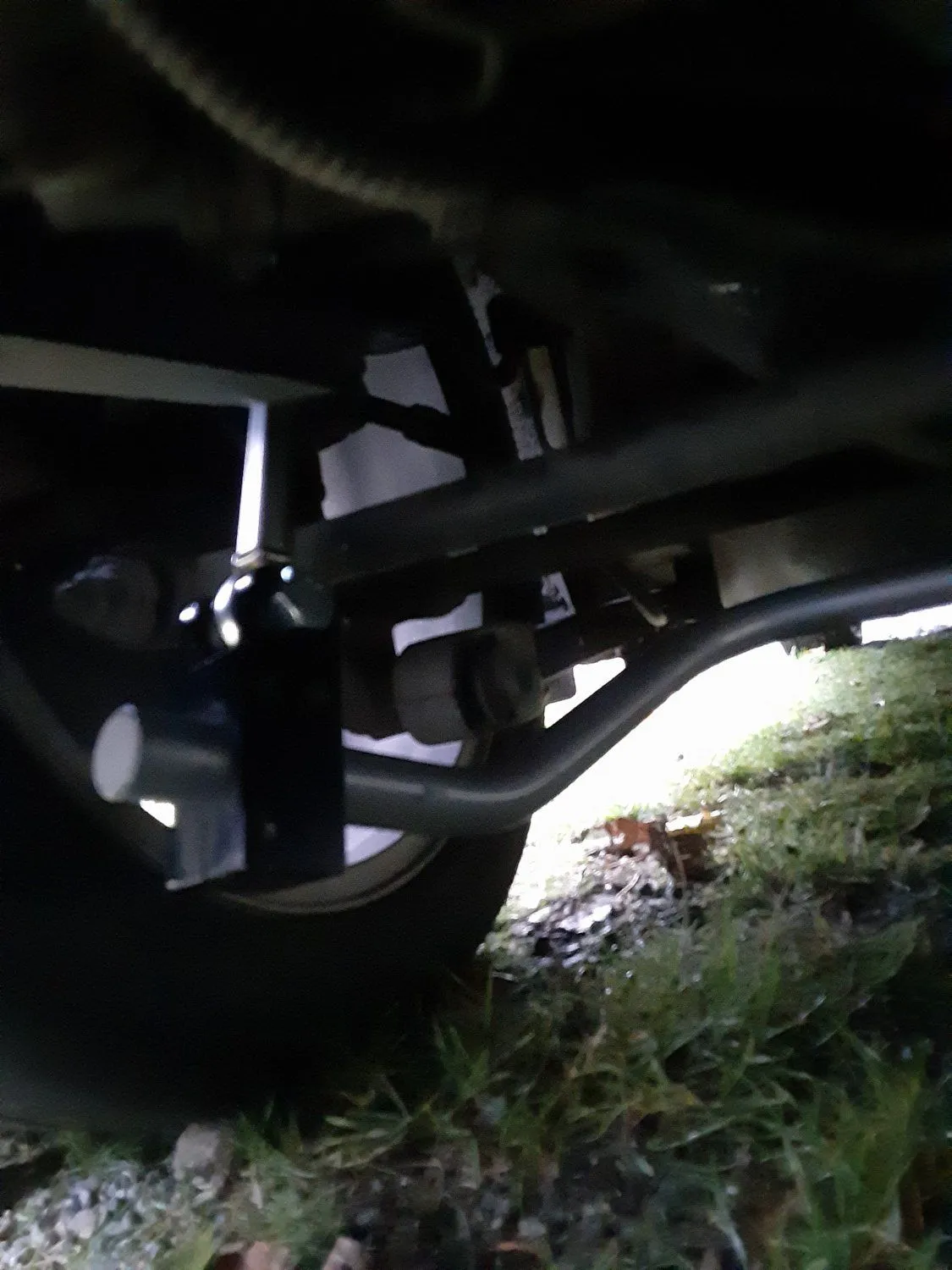

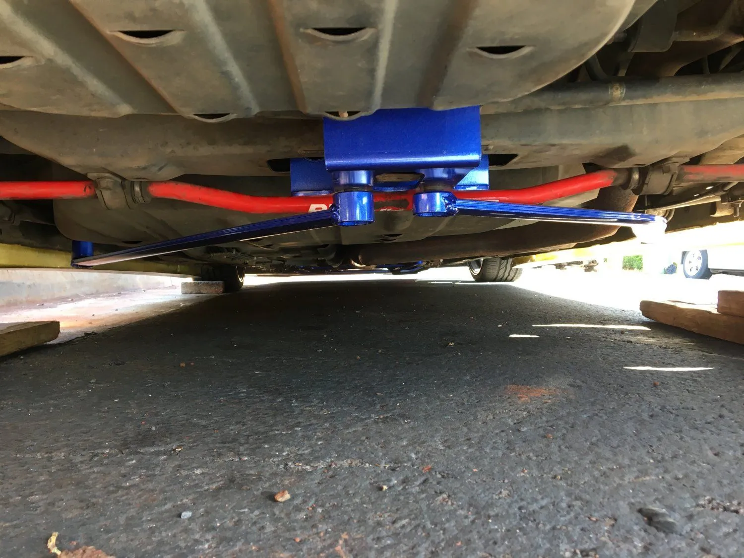

View attachment 226640Recently installed under braces
I see you had to use washers to space the bars for clearance too. I had to do same with GTSpec setup with Progress rr sway.
