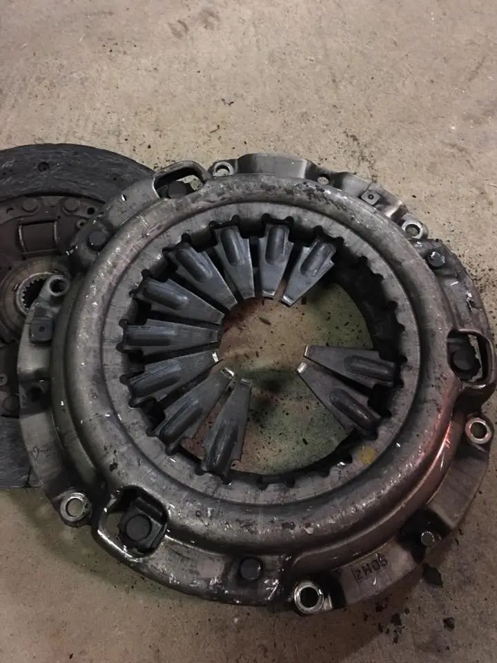

1552 has sat for over a month. After bleeding the clutch hydraulics, I had no improvement on the situation that lead to them being replaced. I finally ponied up this week and had the clutch replaced. Found my problem in the process.

So... That will be fixed by this afternoon. Also having the Yellowspeed coilovers removed and stock Tokico/RB springs reinstalled as well as the replacement of my final swaybar endlink. She should be back on the road by Friday if all goes as planned. yay.
well that looks like s*** lol.
i'll say you had a problem.
