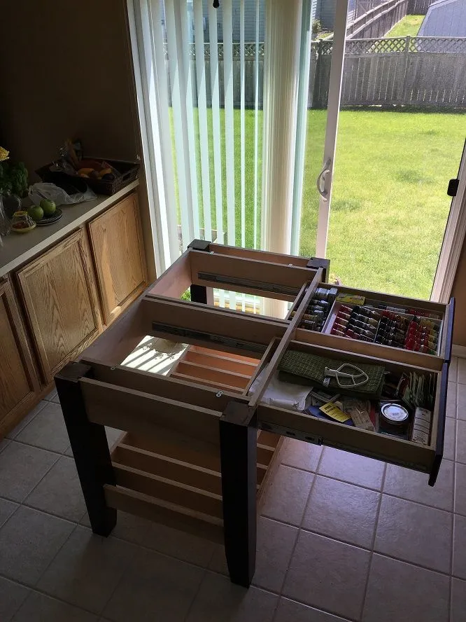

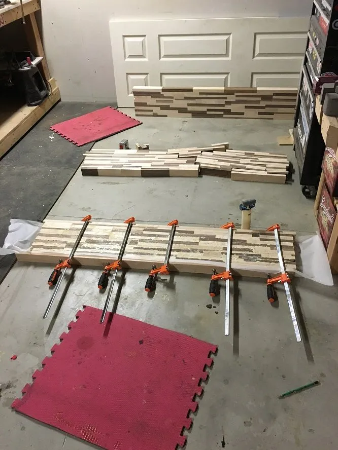

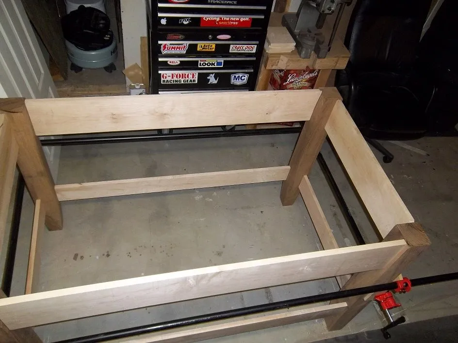

made this for the kitchen
attachment.php
All tong and groove, solid wood. No pocket screws or cheating.
attachment.php
Had to make the draws twice before I got the size right.
attachment.php
And made each and every top piece to the exact thickness so there was no gaps at all, then glued them to 10-12" sections so they would fit through the planer.

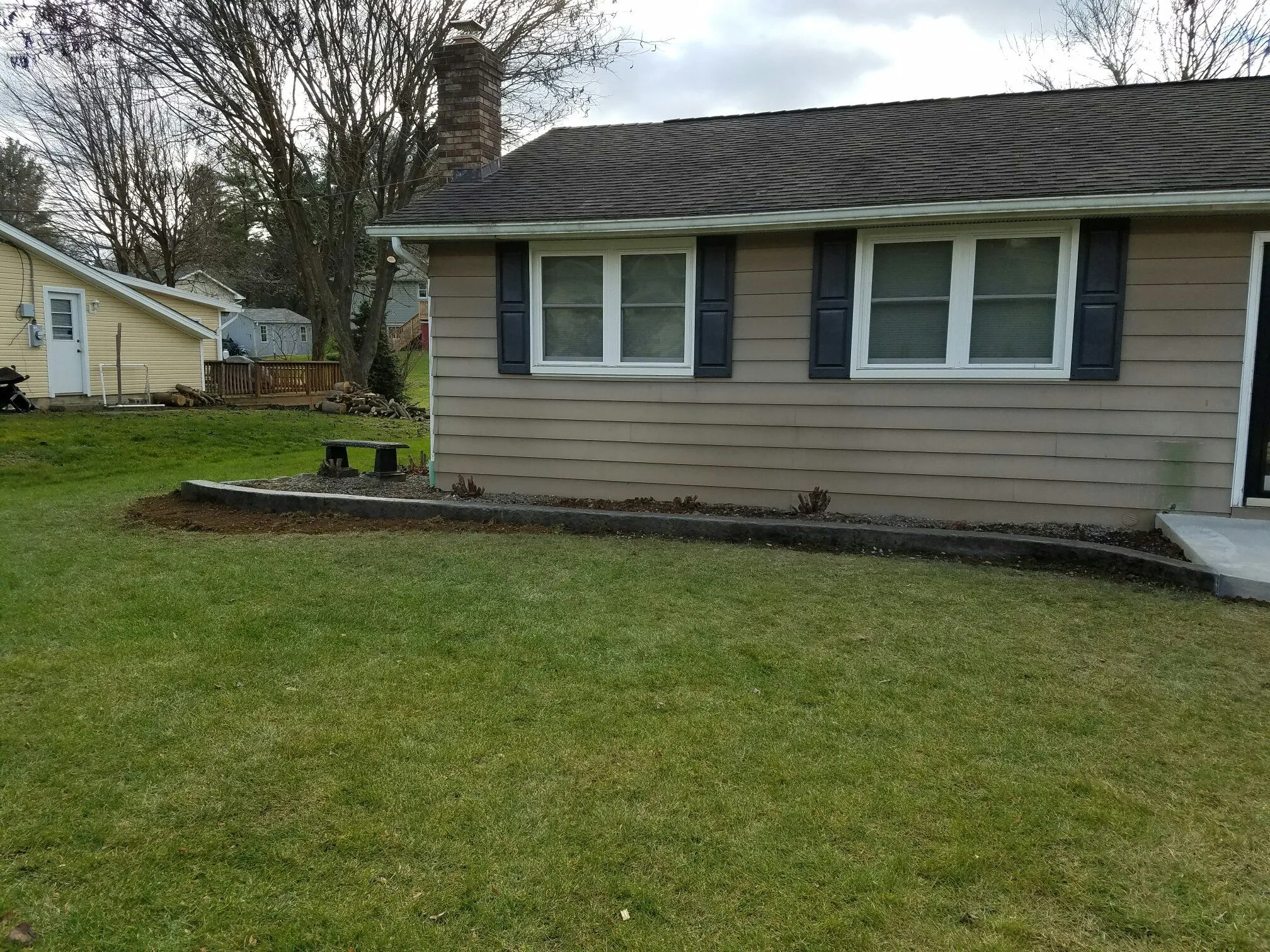

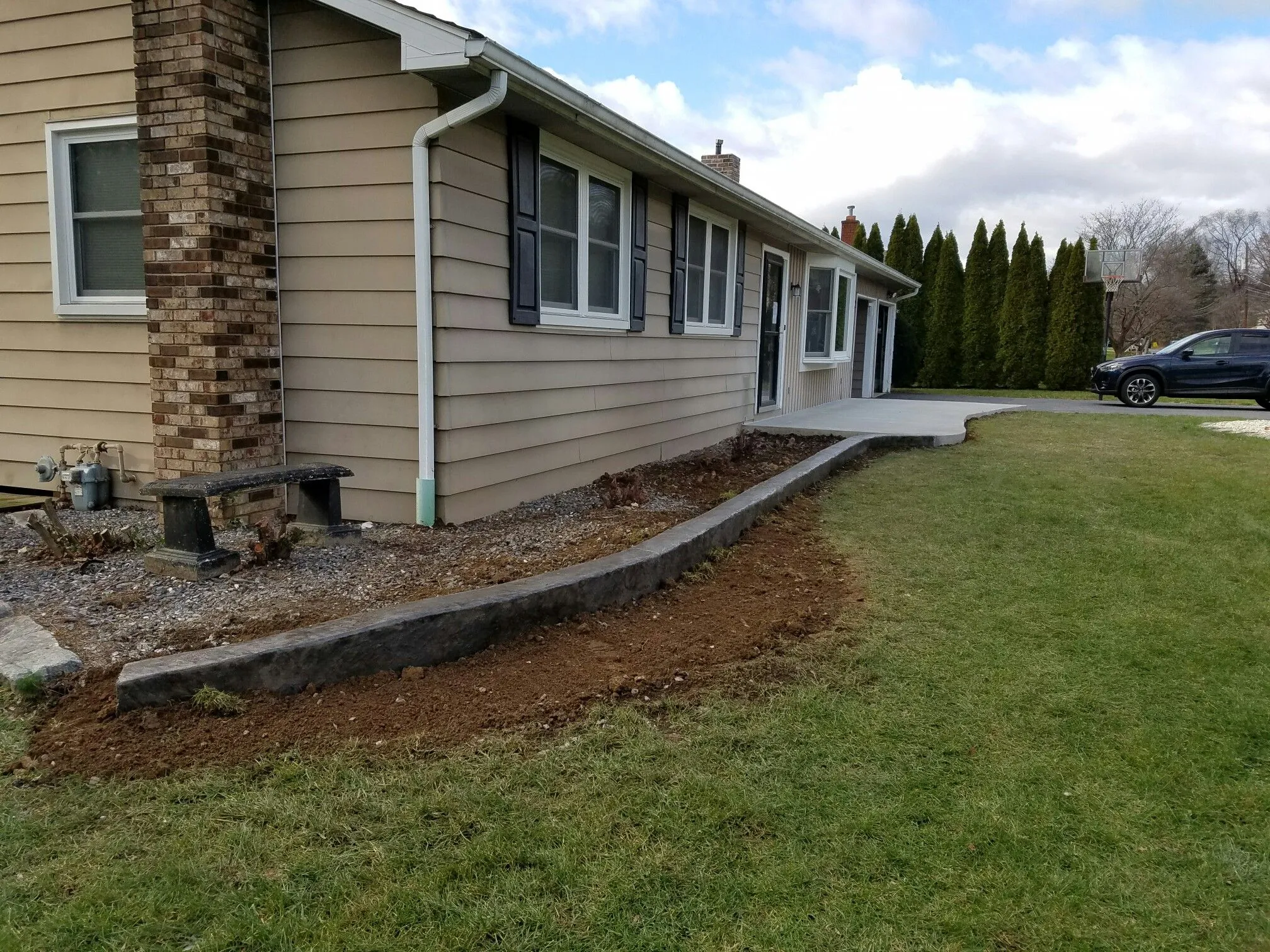

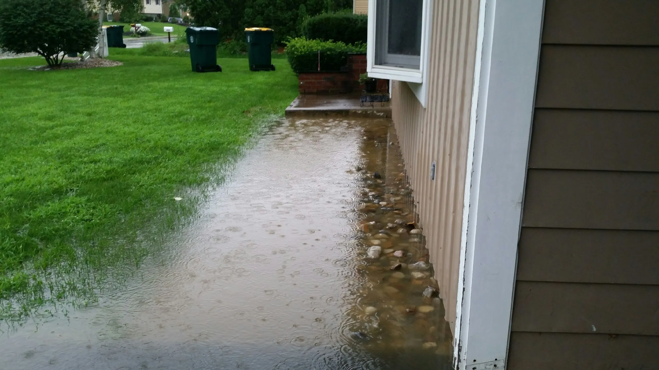

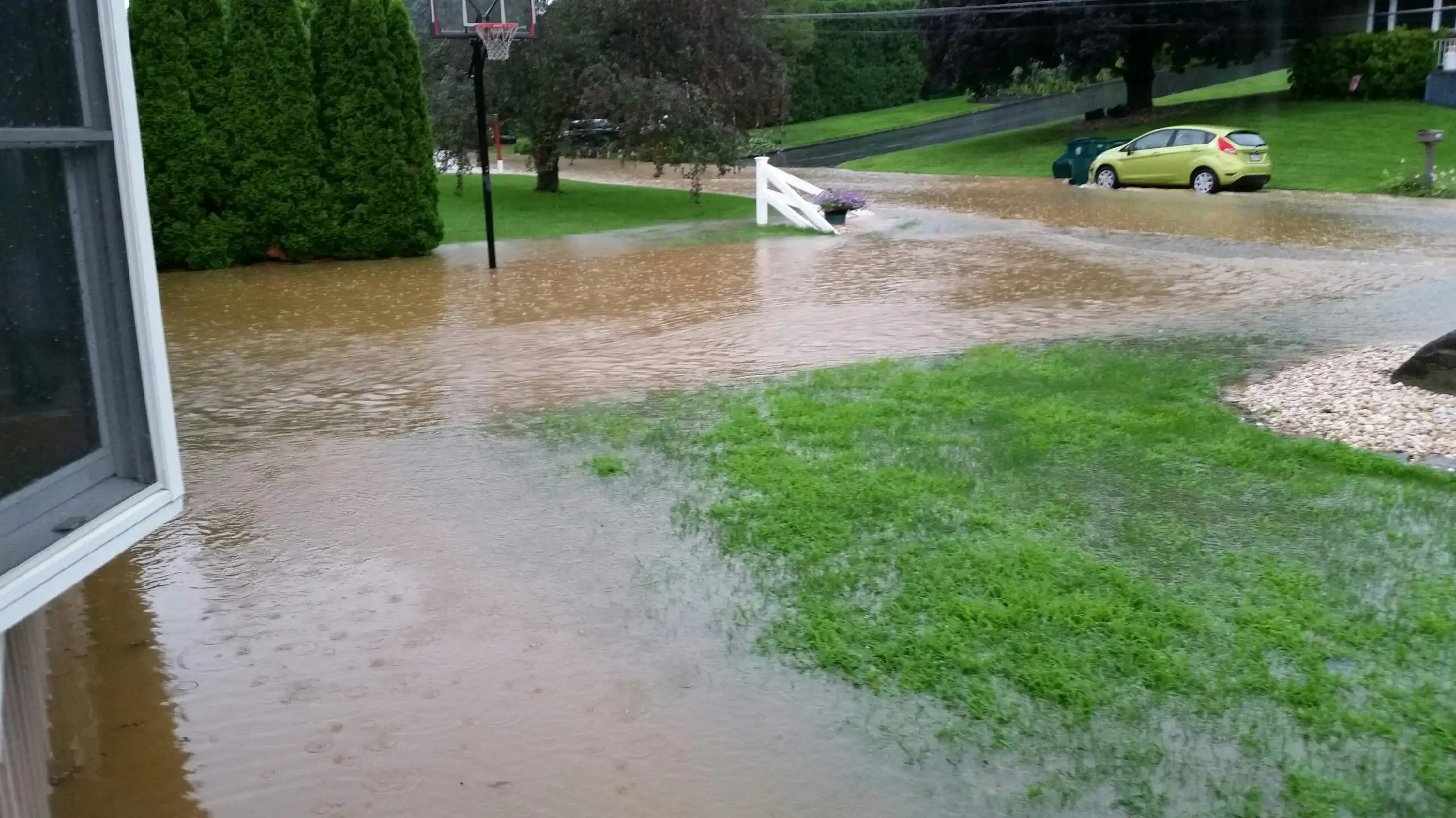

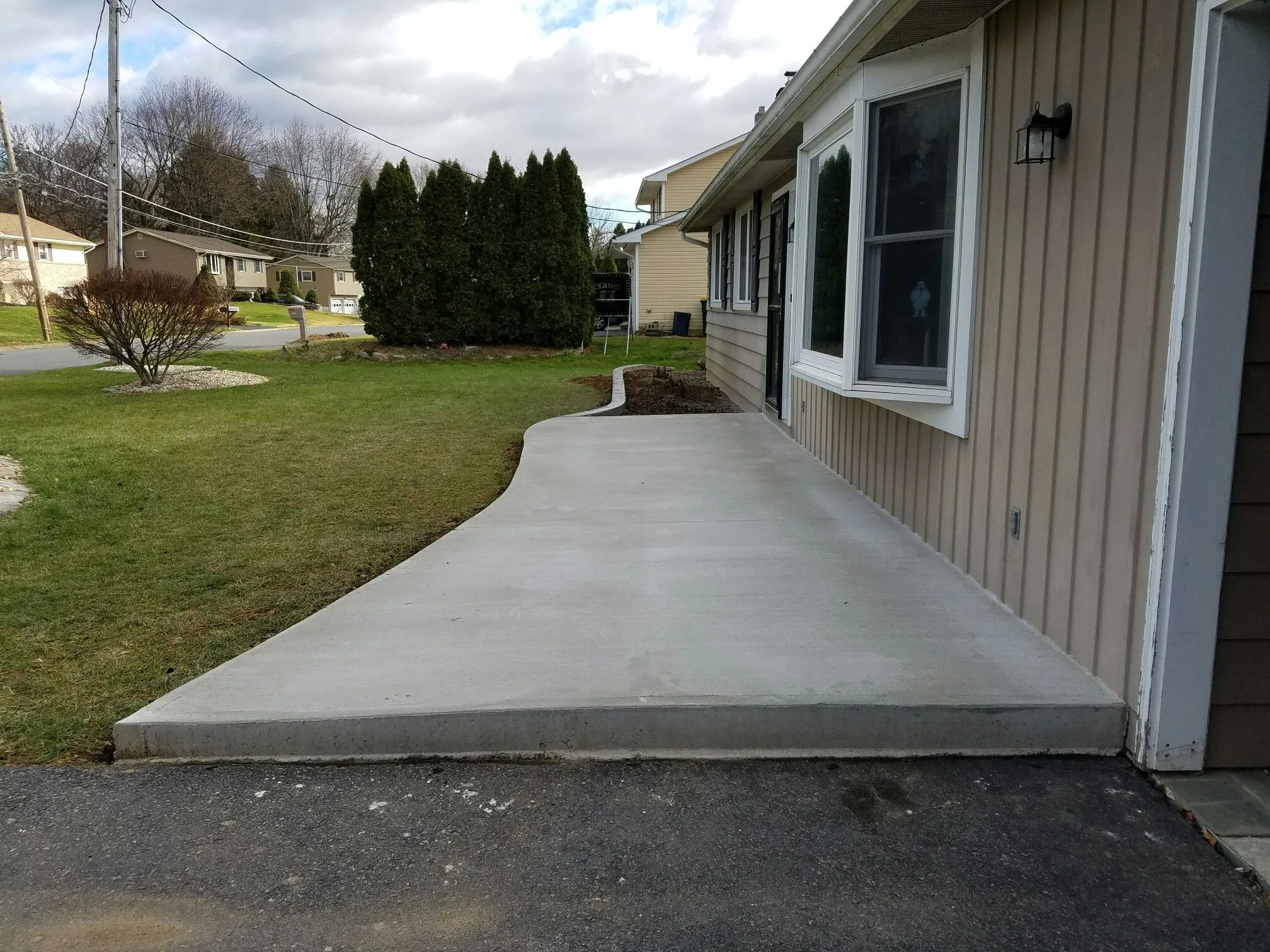

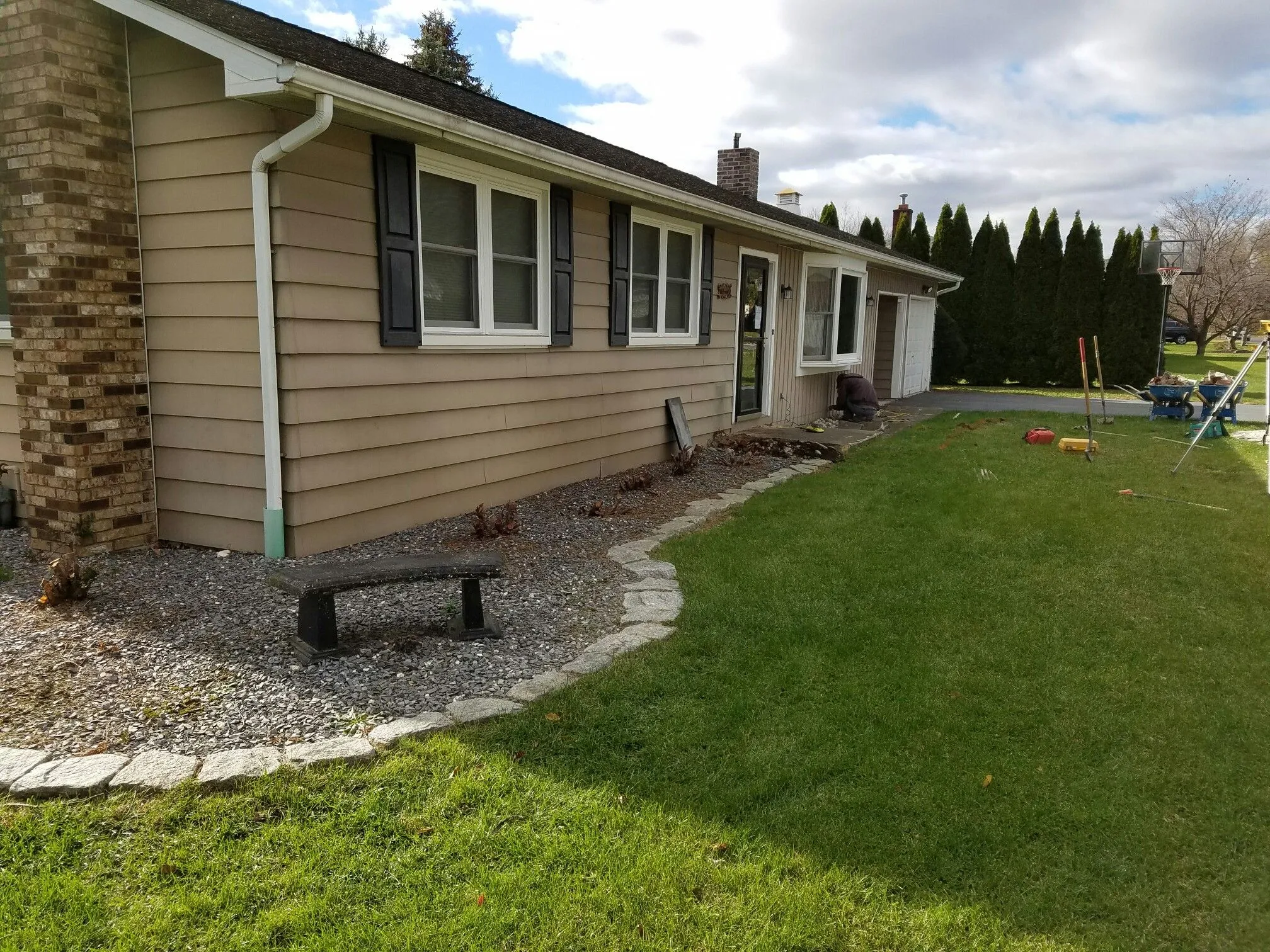

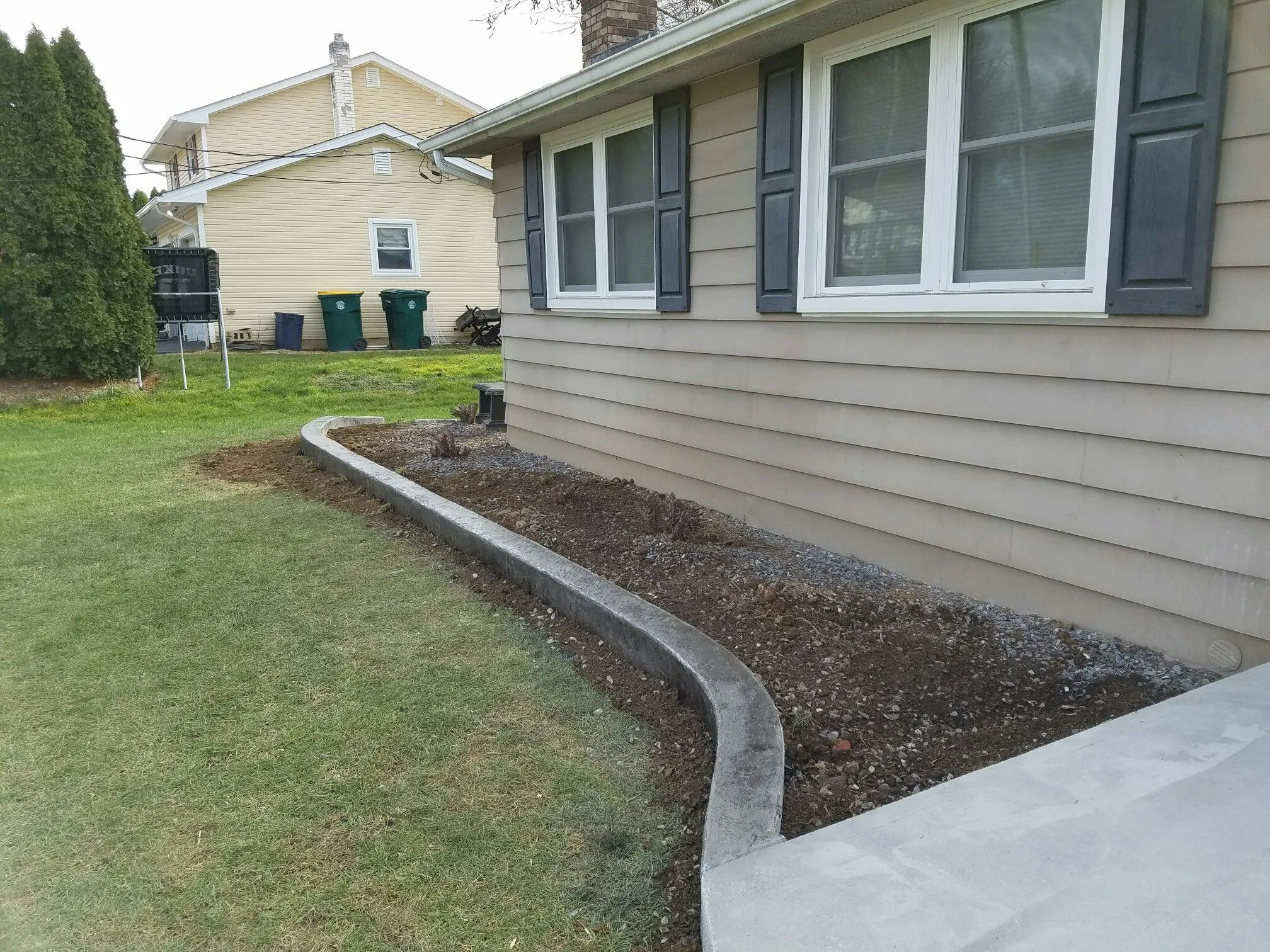

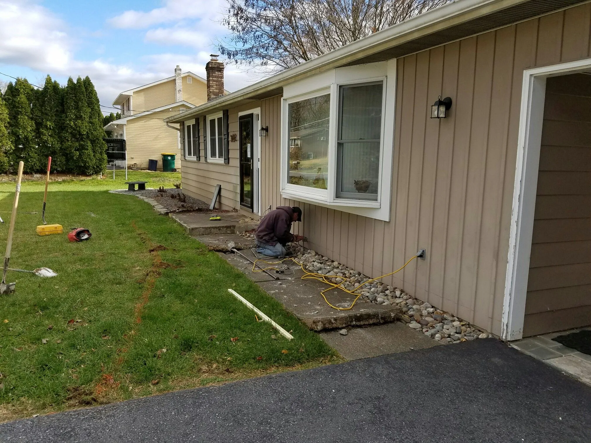

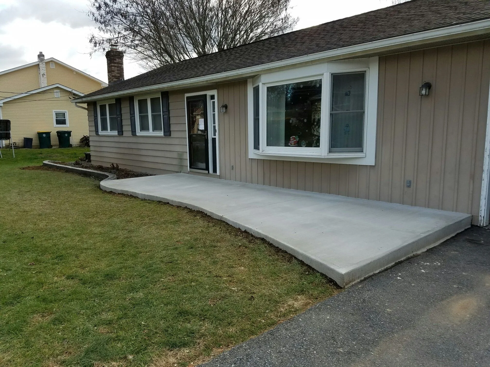

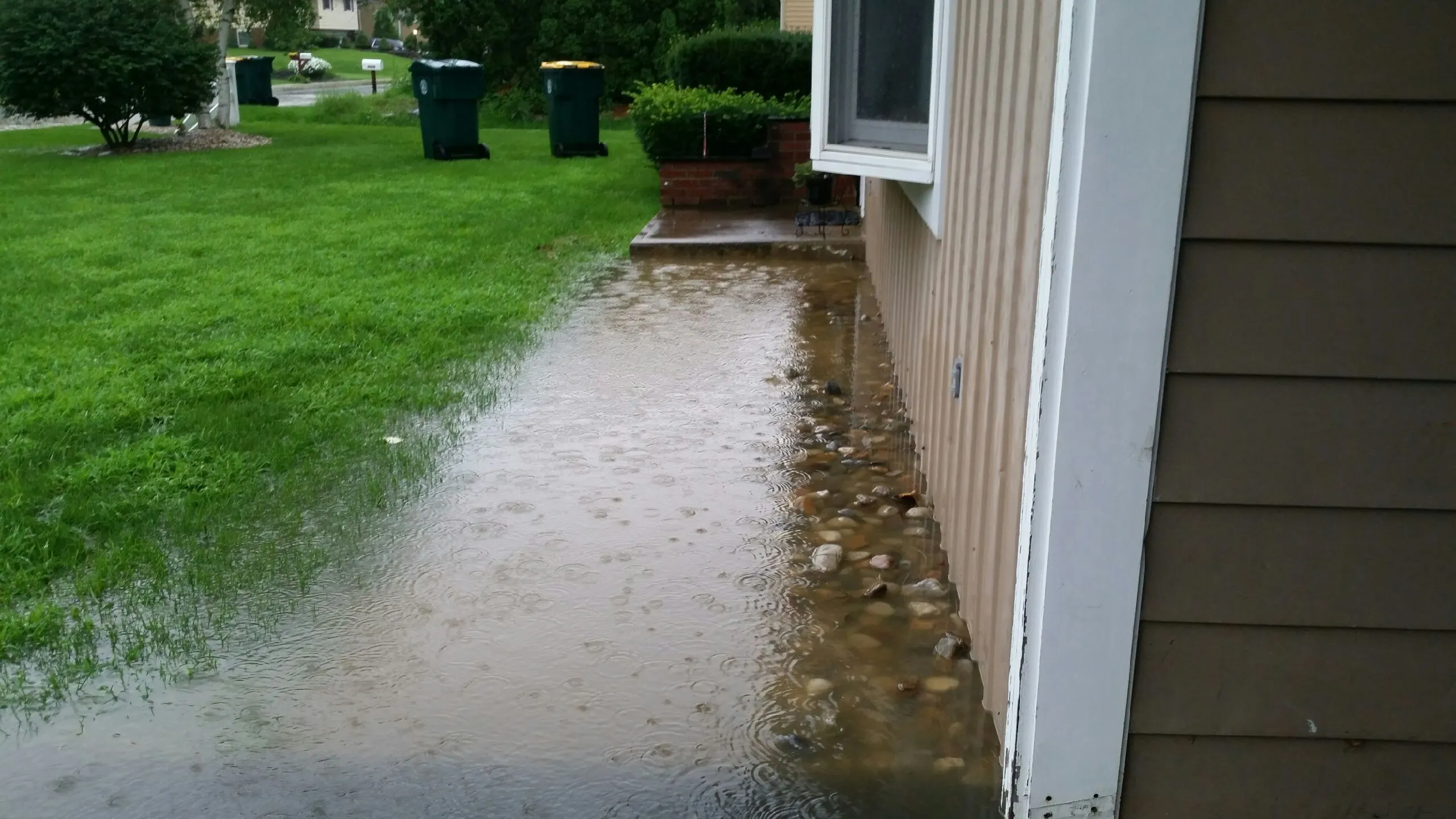

We just had a front patio and curbing poured in the front to help divert water when we get flash flooding. Six months after moving into the house we awoke to 4" of water in the basement and had a french drain system installed. Since then, we have had no water in the basement but with flash flooding the water runs down the driveway right to the house and if it gets high enough it will actually pour in over top of the foundation. The front wall of the basement looks like a waterfall. Thankfully the water runs right into the drainage system. The water never reached the top of our old stoop, which was 7" above ground. Our thinking is not only does it look good but it will keep the water away from the foundation. Should the water level rise above 7", well we have bigger things to worry about then. Over the Winter we are going to come up with a plan for landscaping and lighting.
Before:

After:
attachment.php
attachment.php
attachment.php

Some more after:
attachment.php
attachment.php
What we want to prevent (this was last July due to garbage cans clogging the drains at the end of the block - it took 15 minutes for this to happen and after the blockage was cleared about 10 minutes for it to dissipate):
attachment.php
attachment.php

Wow - CTt3P5, that looks like an absolute nightmare! I hope the new patio solves the problem; looks nice, too!
Thanks! TBH though, I'd prefer to never find out if it solves the problem. lol It is money well spent though because the wife and I will be able to breathe a little easier during Hurricane season. That alone is worth the cost.
