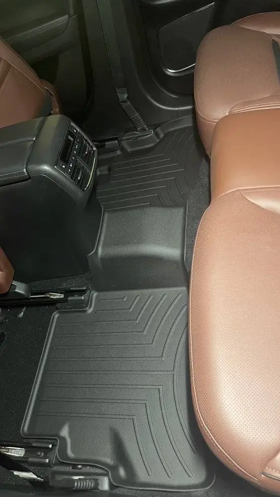

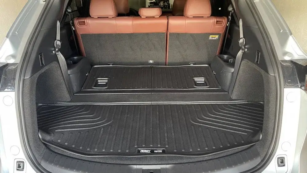

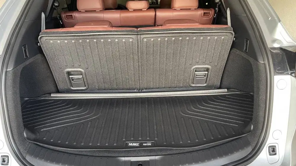

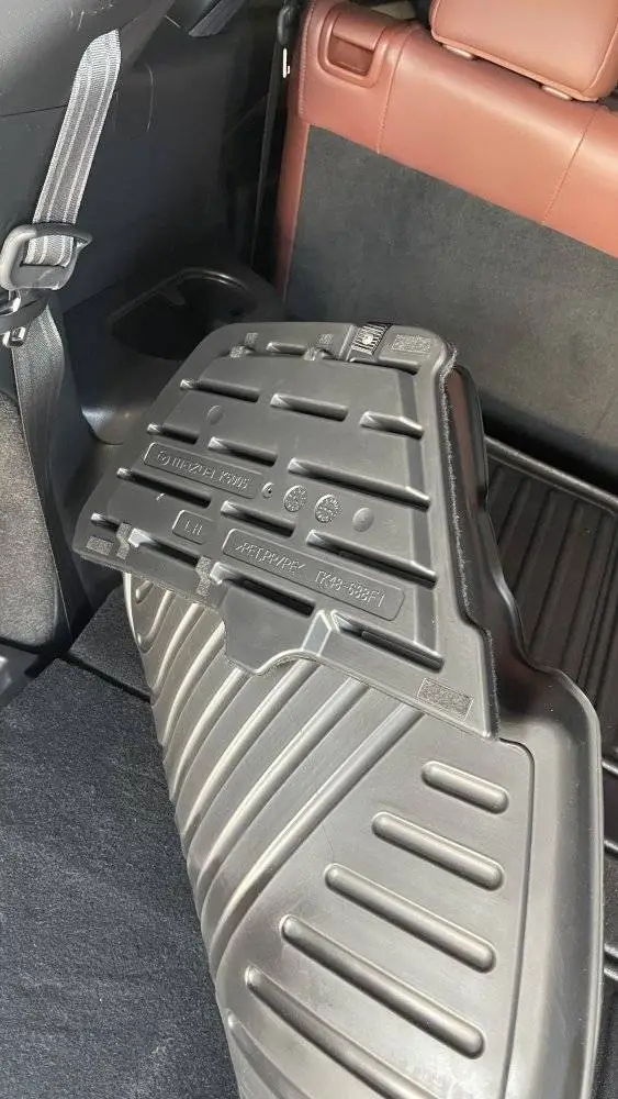

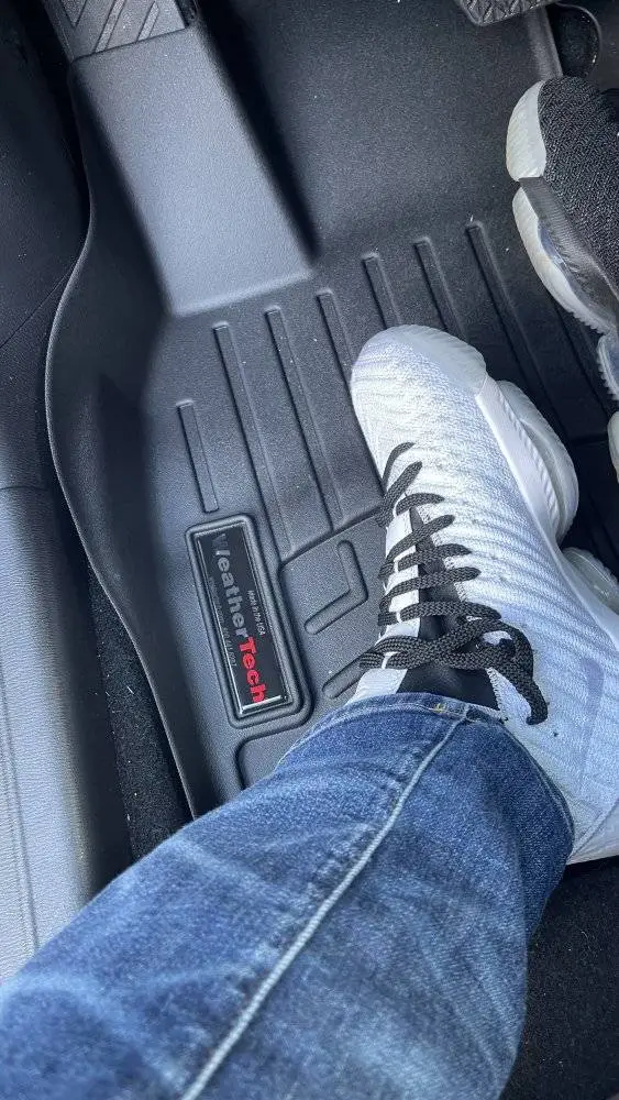

Got my WeatherTechs in for all 3 rows. Still waiting on my Husky trunk tray. Didn’t realize there was 4,000 little floor mats in the 2nd/3rd row. Left the ones on the side of the 2nd row because reasons.

Any chance for more pics of the 2nd and 3rd row? Ive had troubles finding these as they all mostly LHD while im RHD so found some 3dmaxpider??? From aus but no stock. Waiting...

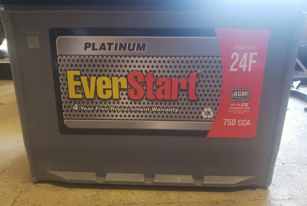

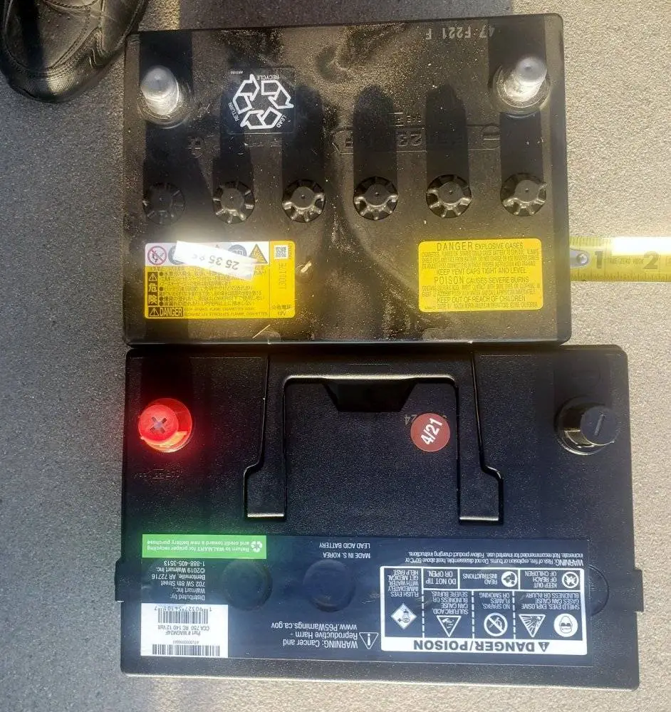

Also did the AGM battery upgrade that cycle guy posted in the resources section. Group 24F Battery Installation My battery was still going but was turning over slower. Did not want it going out while away from the house. I had not read cycle guys post, but had the same thought of installing the best battery I could find. I got the AGM 24F from Wallyworld for $149. It has 750 CCA compaired to the OE Panasonic at 540, a big improvement. I used my dremel to take out the 4 tabs to allow the fitment of the
the slightly longer group 24F AGM. Very pleased with the results.

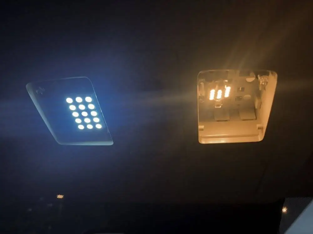

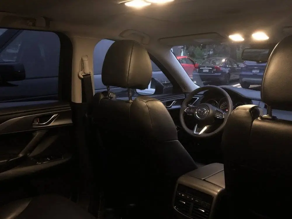

Changed interior to warm white LEDs. Used to be a big fan of daylight whites, but was getting bothered by them lately lol.

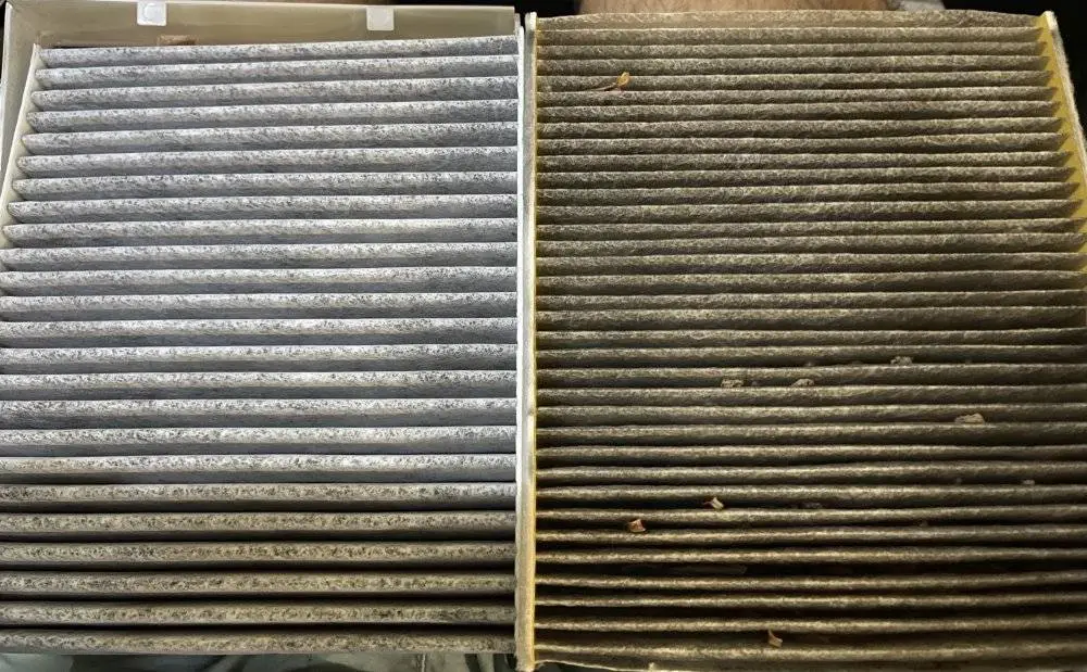

Changed the cabin filter for the upcoming summer road trip season.
February 2020 (when leased from dealer) to July 2021. Old one on the right, new one on the left. A little different than Mazda’s but a perfect fitment and much better price via Amazon.

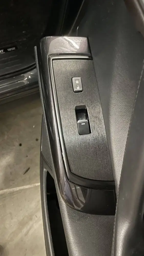

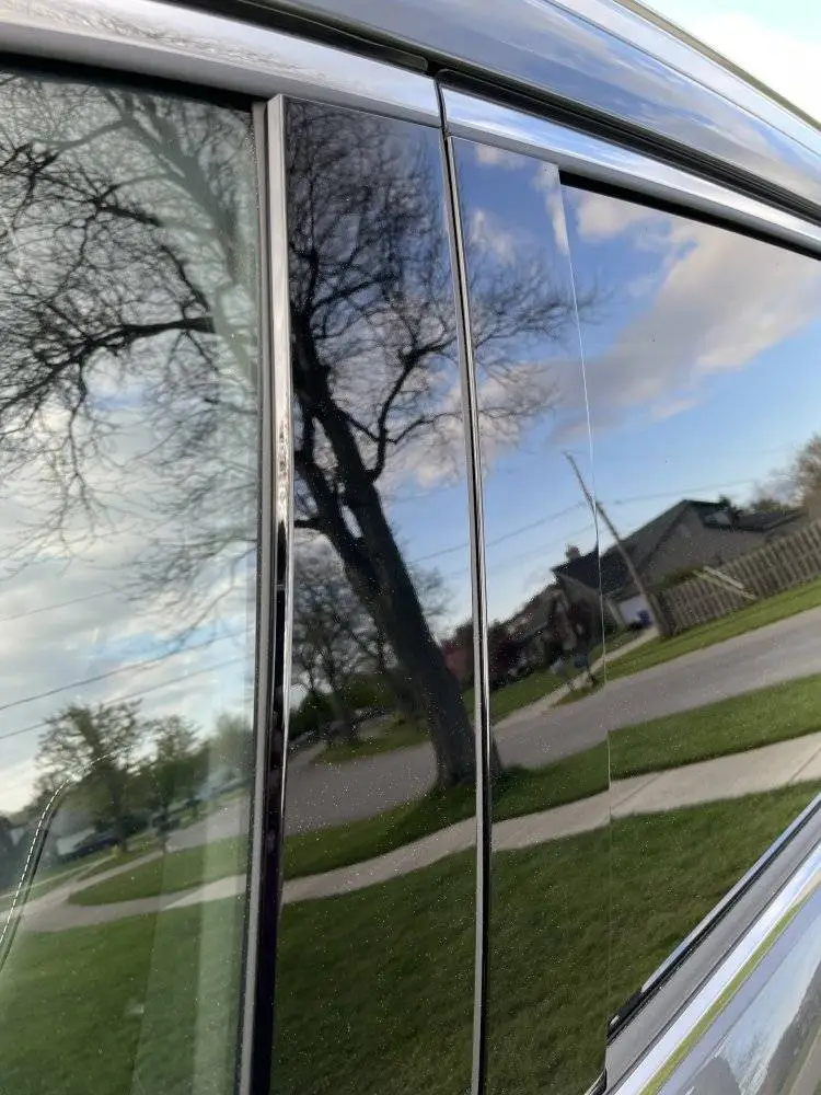

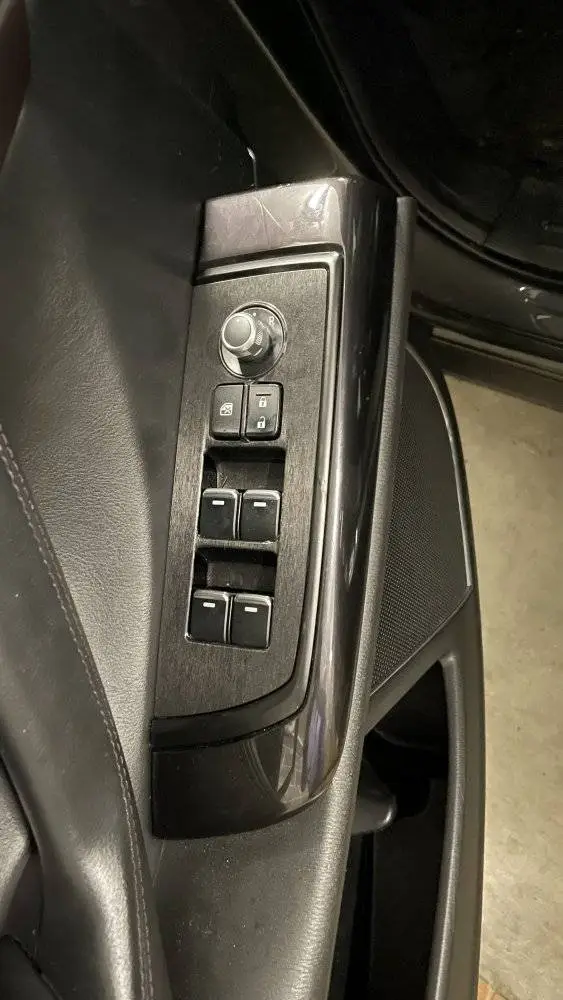

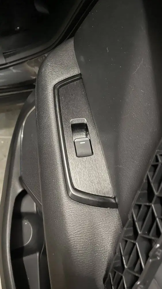

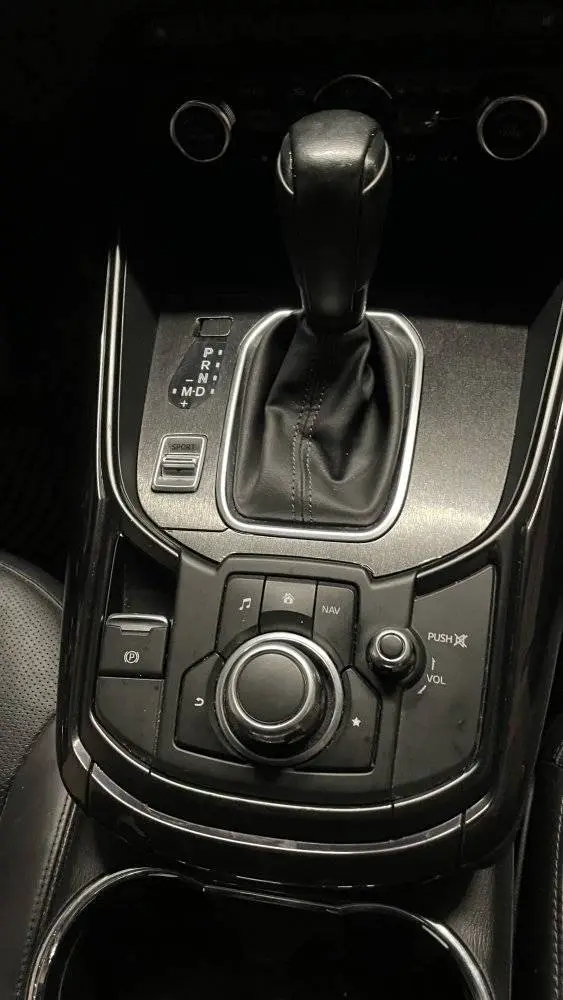

Got Xpel PPF put on the B and C pillars, I also got it for the center console but I don’t have a picture of that. The piano black was just scratching way too easily, when I got the car new it already had a few. So far I’m very happy with how it looks with the film.

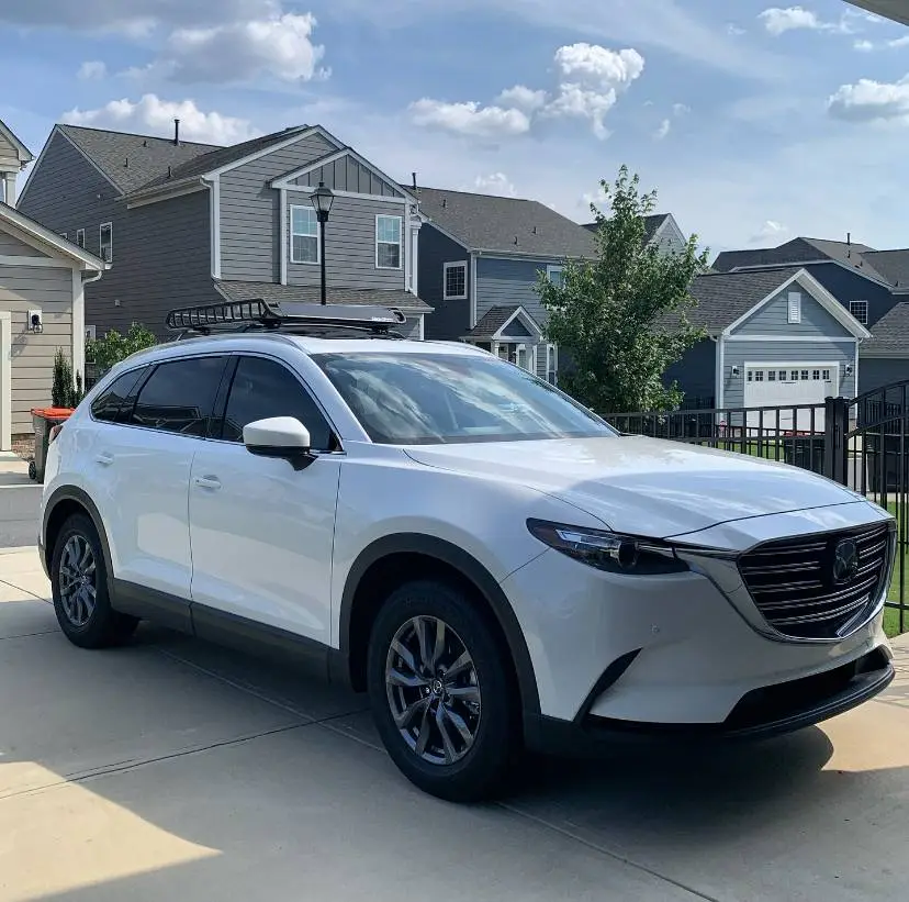

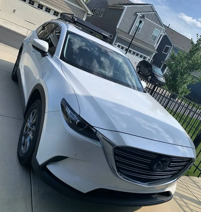

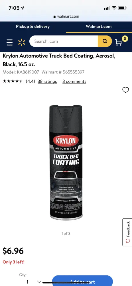

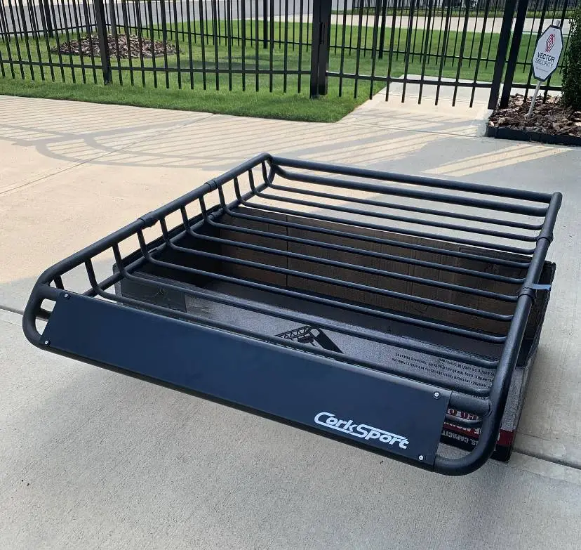

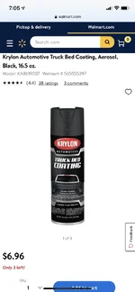

Going to need some extra storage soon, decided to go with a roof carrier basket. Modded the carrier to “fingers crossed” prevent rusting. Caulked all the joints, applied loctite to all the screws and applied 4 coats of krylon truck bed spray. Overall I'm pretty satisfied how it came out and I like the textured look and feel which is almost identical to the OEM crossbars.
