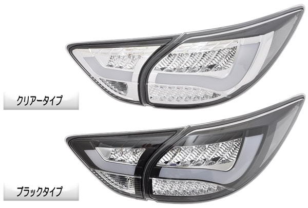

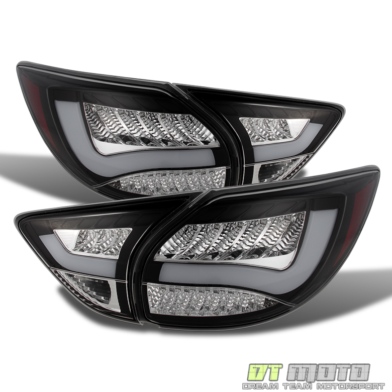

Noticed there are some crystal eye jp look alike son ebay now, http://stores.ebay.com/dtmotosport?_trksid=p2047675.l2563 (search "cx-5" In that store). They are about half the price of the crystal eye + shipping lights. They look a lot alike, but they are slightly different. Originally I wanted the clear from crystal eye but that's about $600 after shipping, pretty steep. It's probably just a variation sold by the OEM because some of the styles seem to be "exclusive" to crystal eye (and thus command a higher price). wouldn't touch the "smoked" styles because of ticket risk.
crystal eye
crystal eye, clear top, black bottom
comparable to the crystal eye black. this one is half price but red on the side, also the reverse light seems to be yellow instead of white.

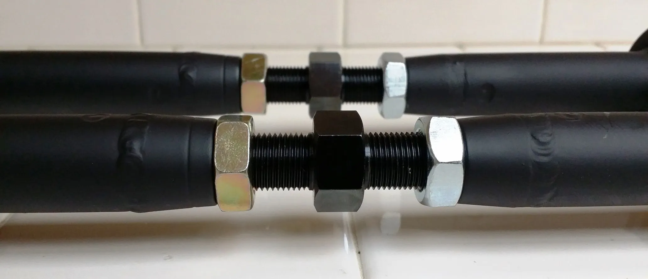

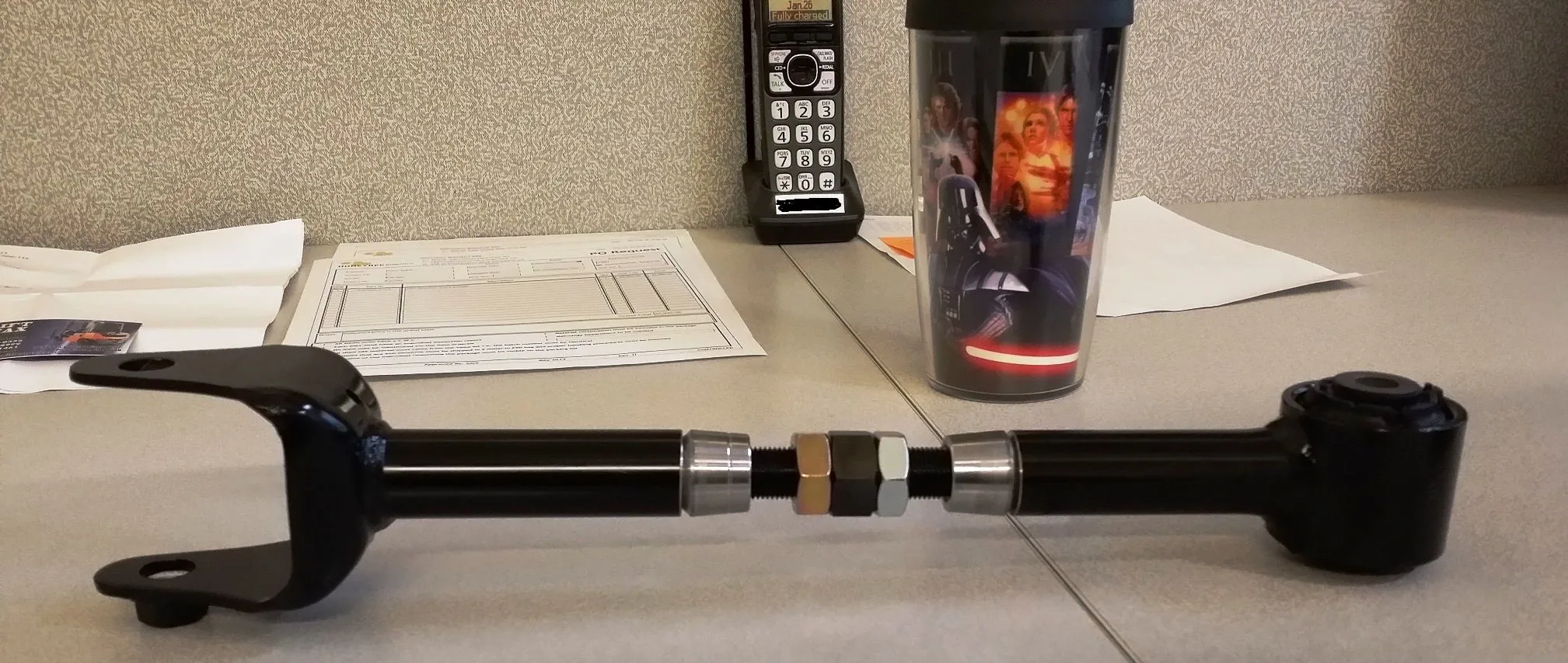

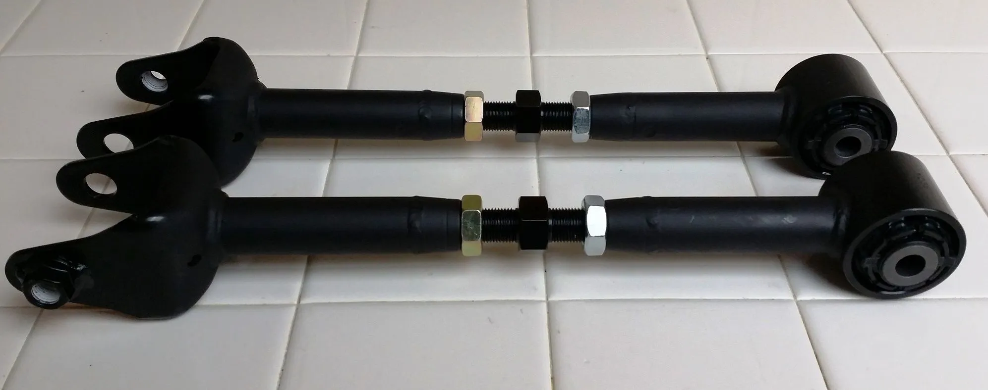

I have cut to the right length(same as original) and put together all the parts for the lateral link.
I will have to drill some holes through the pipe, where the "nut" are, to be able to weld it through those holes as well, for more strength.
Need to grind some chamfers, for the welding and they are off to the welder.
I'm leaving 2 x 1/2" threaded area for adjustment. Hopefully, it will be good enough. Anything less than 2 degrees, it should be better.

I have to see how it works first. IT's very easy to make.
I have listed the parts, that I have used.
I have cut out 1.85" from each end, after cutting in half the lateral link(7" from the bushing's top).
Ground a 45 degree end for welding and drilled through a 1/4" hole at each end of the tubes.
So, it will be welded around, where the nut will meet the tube and where I have drilled the hole also will be welded, almost as a spot weld, for added strength.
I have dropped them off today. Tomorrow, they should be done for $20(!).
I will paint them and they are done.
Need to fix, a deep scratch on one of the wheels and I'm thinking of painting the edge machined part red.
Then, I will drop the car and get some tires.
Looks good tibimakai [emoji106]. Some questions- where is the parts list? What is the inner silver area, a machined part of the arm? What's the purpose of it? The threaded inner bolt- each side of the thread are going the opposite way, yes? It will need to be to lengthen or shorten the arm.
One side is left thread and the other is right thread, so by adjusting the center hex, the arm will shorten or extend.
In my case, I have to shorten it, since this arm is at the bottom.

I'm painting them as we speak.
The welder, worked for JPL in the past.
The welding, looks great and the price it was even better. $20 cash.
I'm guessing you are "N.B."? Thanks.

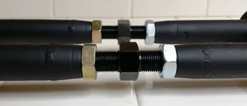

Here is the finished product.
I did not have glossy paint, so I had to do it with flat.
This answers my questions and your finished product looks good. Not sure how durable the paint will be being under the vehicle. Powder coating would be more suitable. Seems like you and your welder did a great job, though. Cant wait to see the results when you install it and get it aligned. [emoji106]

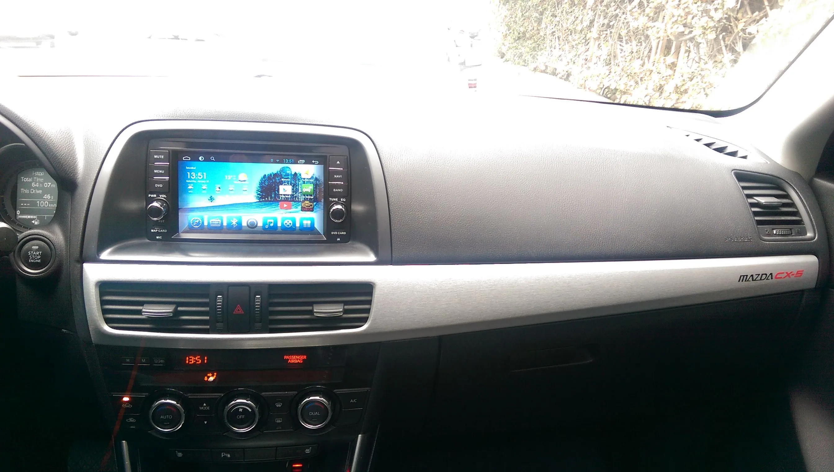

I have also purchased, a refurbished Kenwood DNN991HD. Next weekend, I will replace the existing DNX9990HD.
