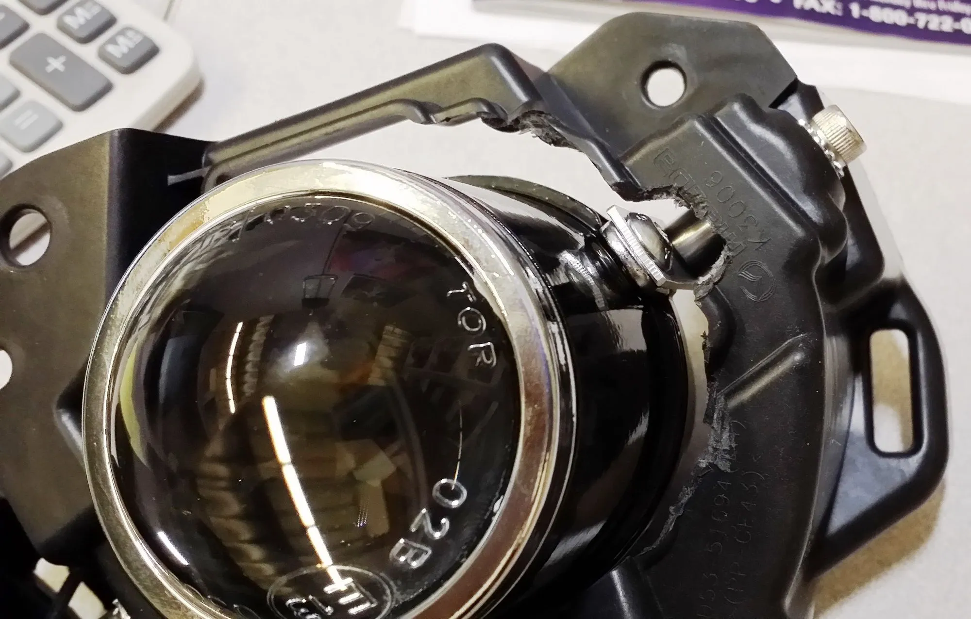

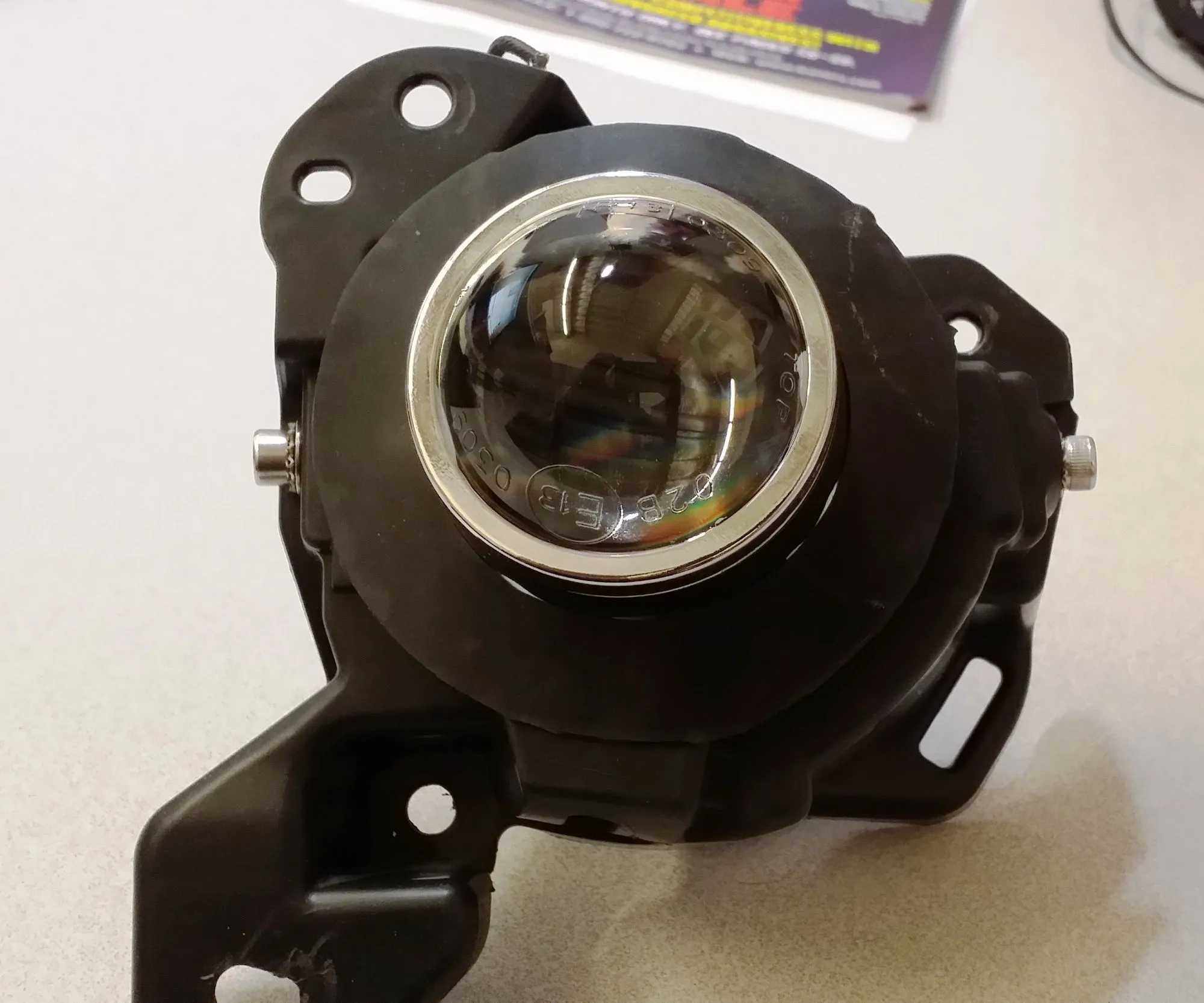

Replacing the fog lights with driving lights(projectors).

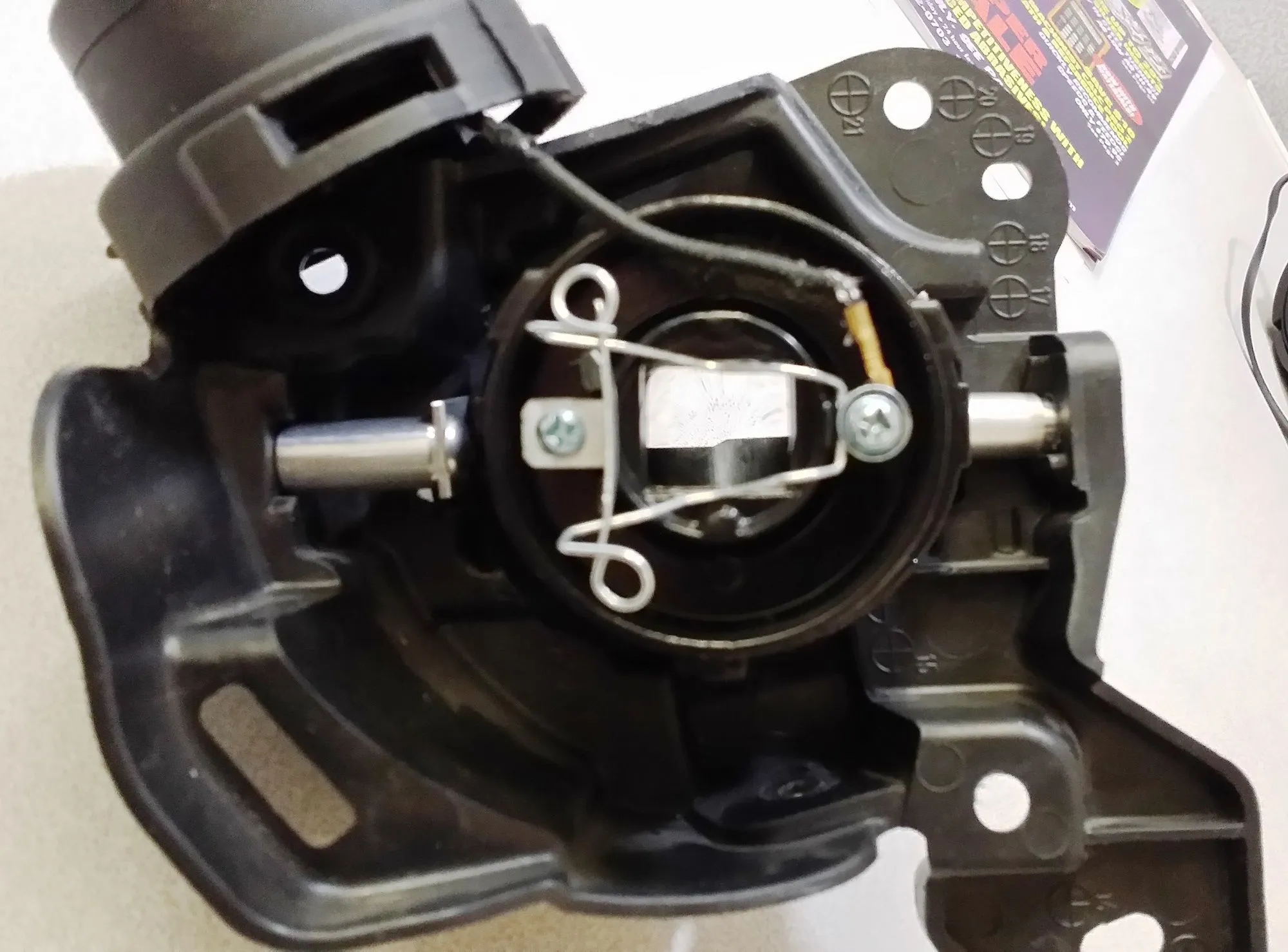

I had modified the factory bracket to fit this projector.

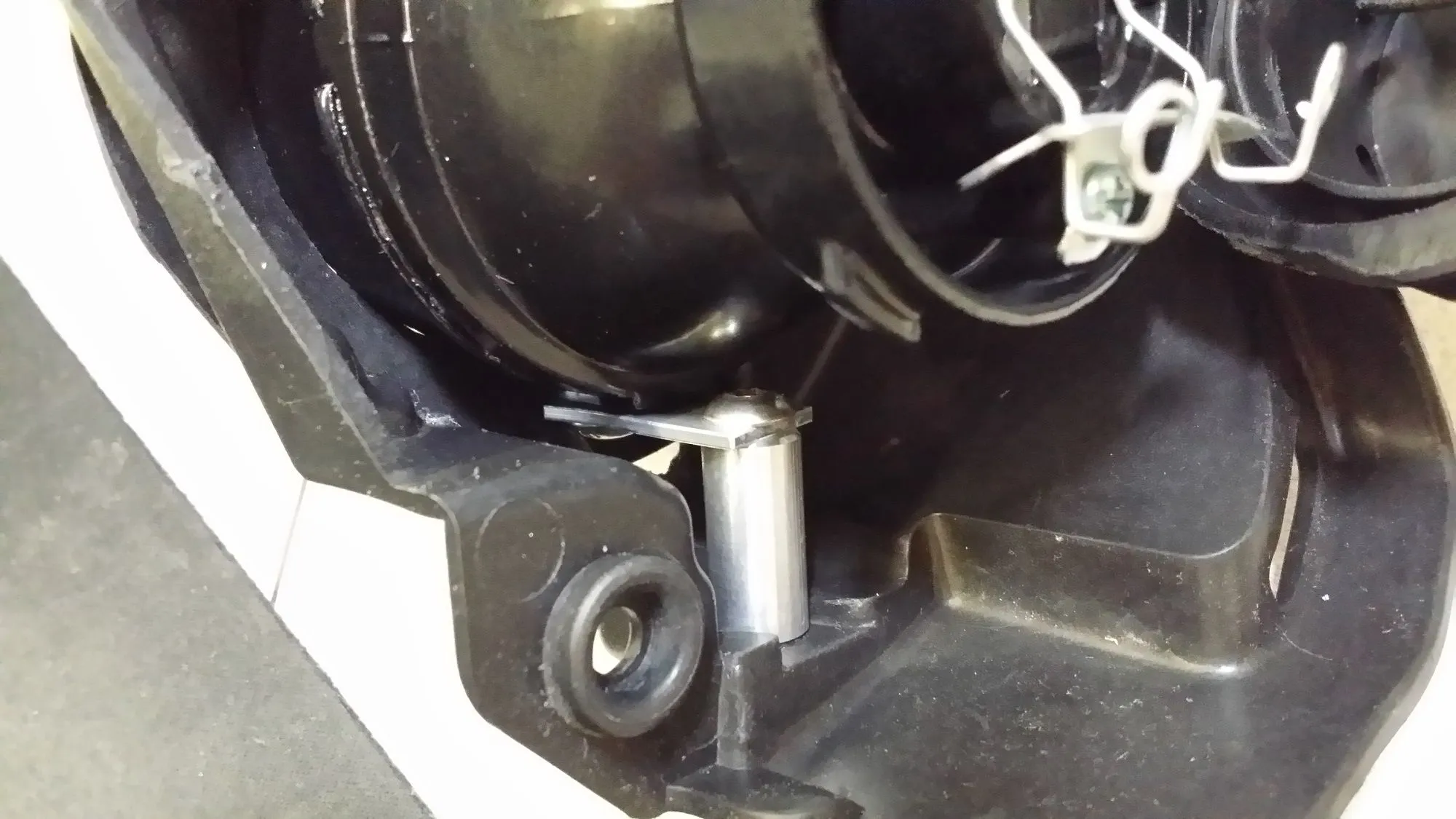

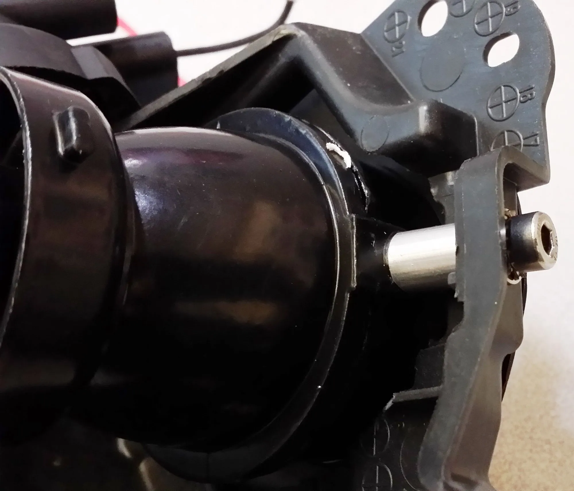

Made some spacers and a small bracket to have the factory orientation.

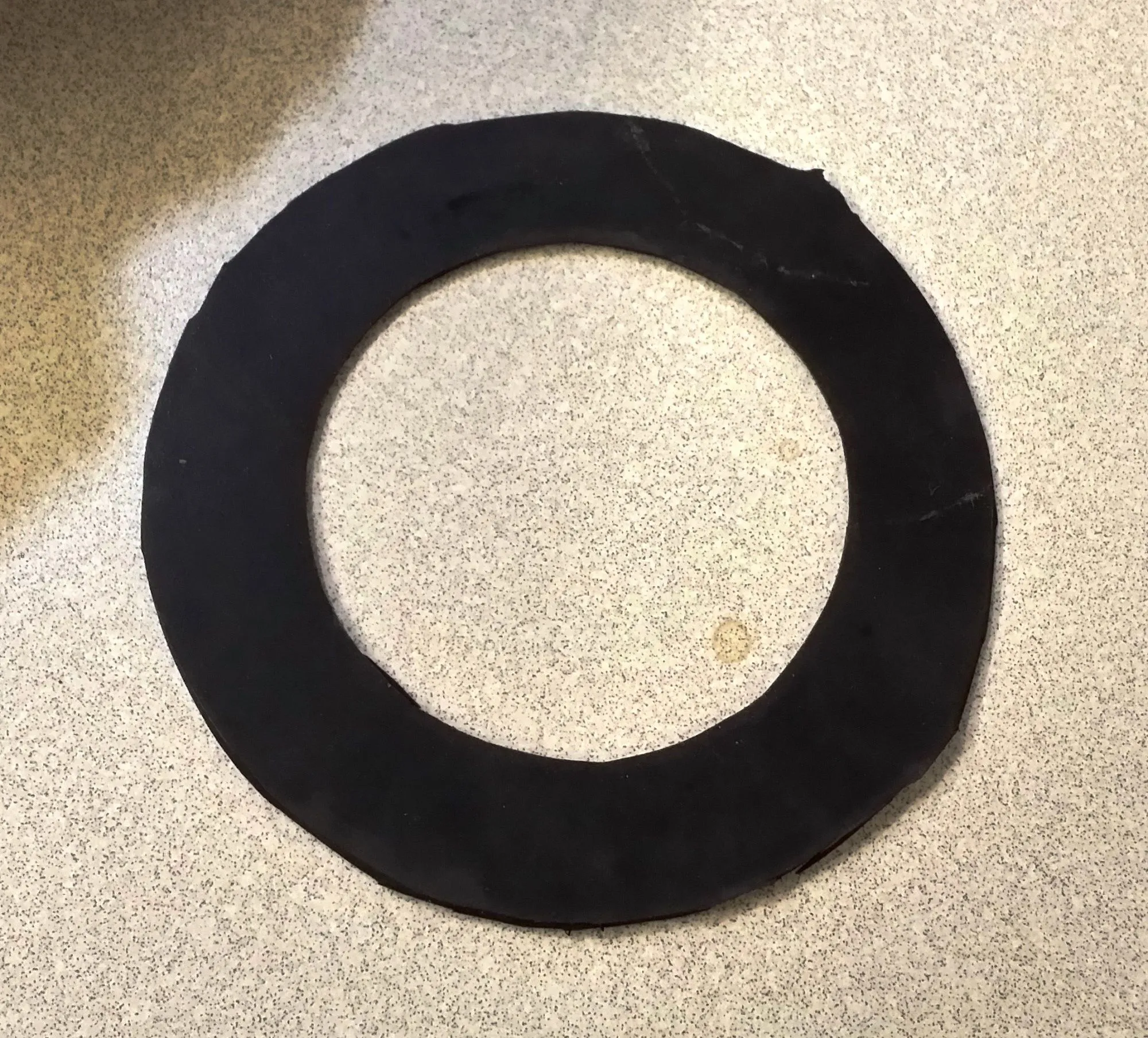

Placed a rubber gasket, to cover the diameter difference between the factory fog and the new projector.
Next, I need to find a place, to install the HID ballasts somewhere.
