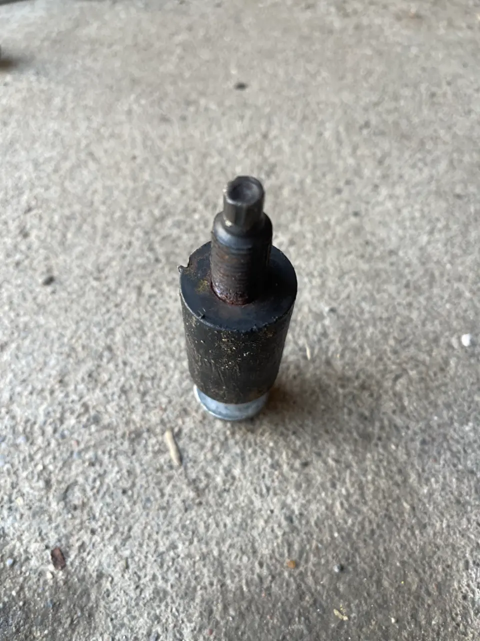

Rumble or roaring sound increased with speed. Originally considered it was on the right side since the sound would change with a left turn. When I checked it on jack stands I found the sound was actually on the left rear. It's a DIY but access to the four bolts is difficult and required heat and penetrating oil.
Yeh it seems stuck bolts and nuts is a common problem on DIY suspension work on the CX-5. So you could tell you had a bad bearing when you jacked up the wheel and turning with the noise? And did you replace only the bearing or the entire hub with bearing?

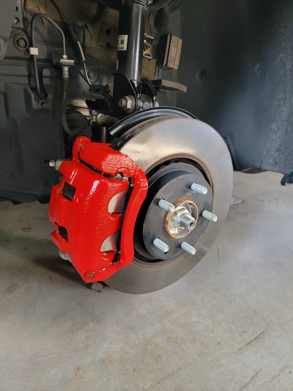

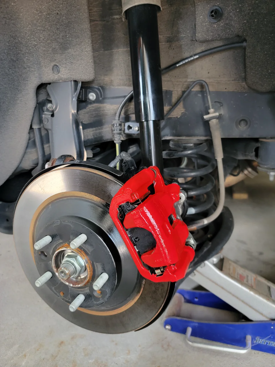

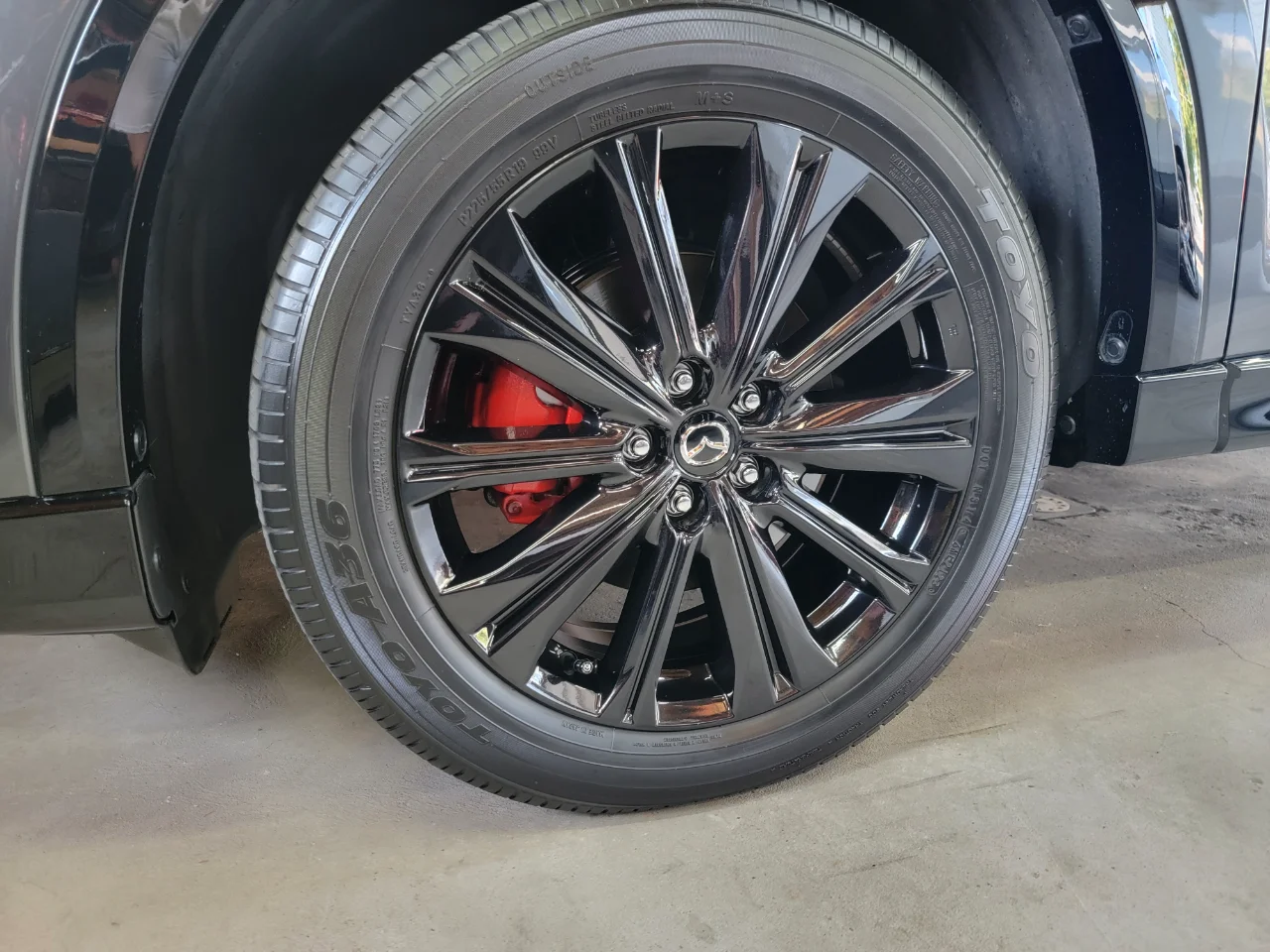

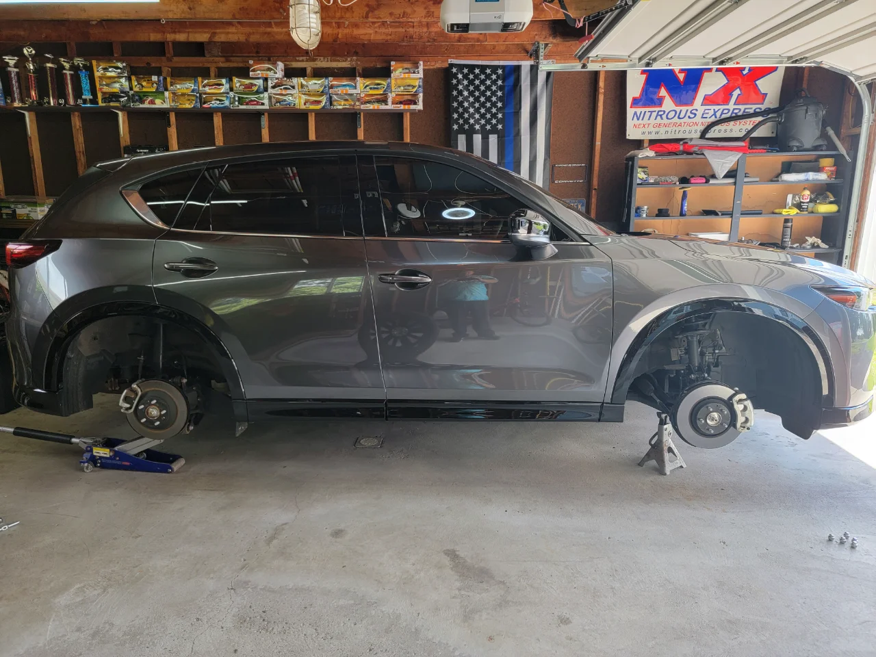

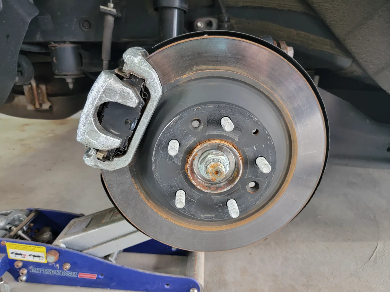

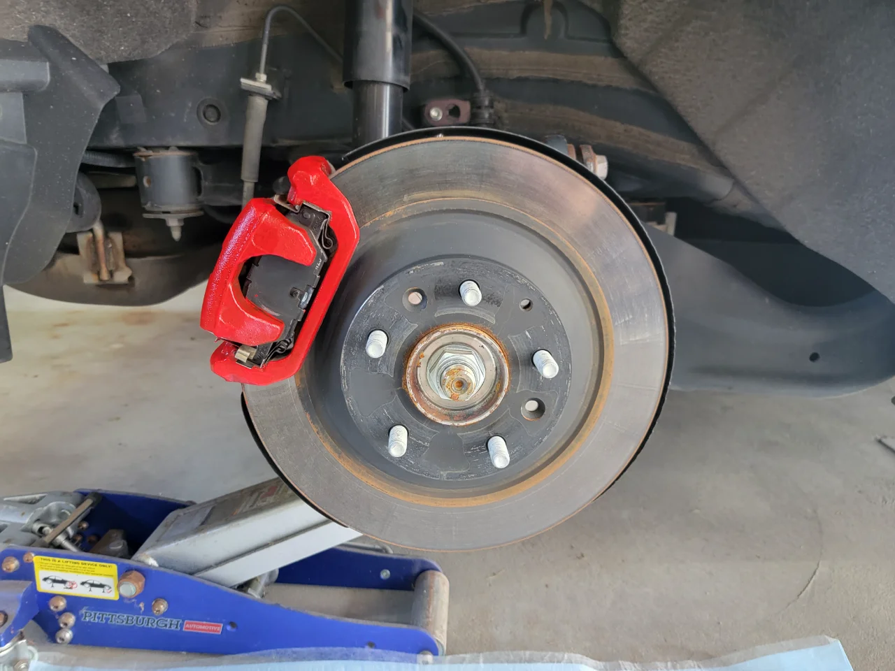

Painted my calipers, cleaned my rims and rotated tires while off. Changed oil/filter also. It was a long day.

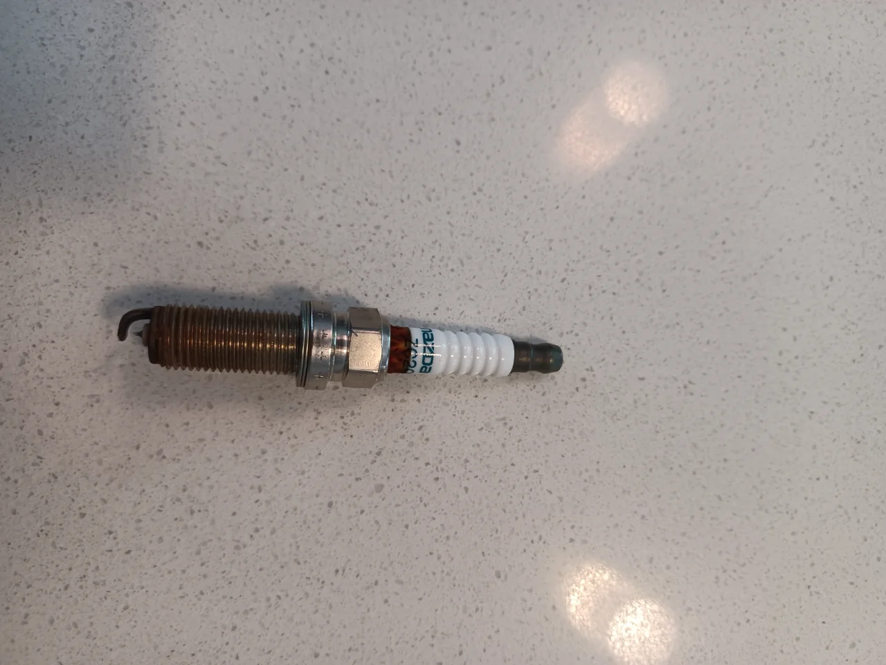

I attaching a picture of the old one. They all looked kind of the same so this one is a good representation of their condition. Interestingly it's got Mazda logo and is made in Japan but I am not sure about the brand. Maybe someone can advise.

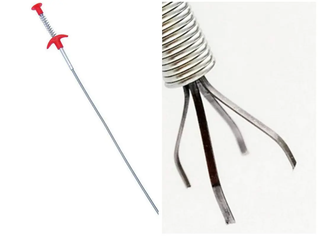

I use a deep socket only to break the plugs loose and to torque the new plug to spec but for removal and installation, I use one of those flex "grabber" tool with a grapple on the end.
I like this method because the grapple has enough tension to spin the plug out/in but not enough to risk cross threading. Also, it gives you very fine touch/control/feel of the plug engaging the head so you don't risk inadvertently altering the gap during install. You can easily see the plug going down into position. 👍

What was your cleaning process for the calipers? And did you leave them on the car?
I use to just use sandpaper but awhile back knowing I would do this I ordered wire brush wheels that attach to my drill. Such a difference, just got to manipulate the drill and different size wire wheels to get different angles. I'll post some pics later of the clean up using the wheels. After that and a lil sandpaper I just wiped it all down with a clean rag and water. Let it dry while I did other things around house/garage. I did not remove any of the calipers. Used 3 different size brushes and did multiple coats of red then sprayed on multiple coats of clear.
I painted my calipers with plastidip. "Anthracite Grey HyperDip". It works great. I've been doing this for years. It's easy to peel off, and it protects the calipers from rust. i use to use regular paint, and learned what a pain it is to remove.

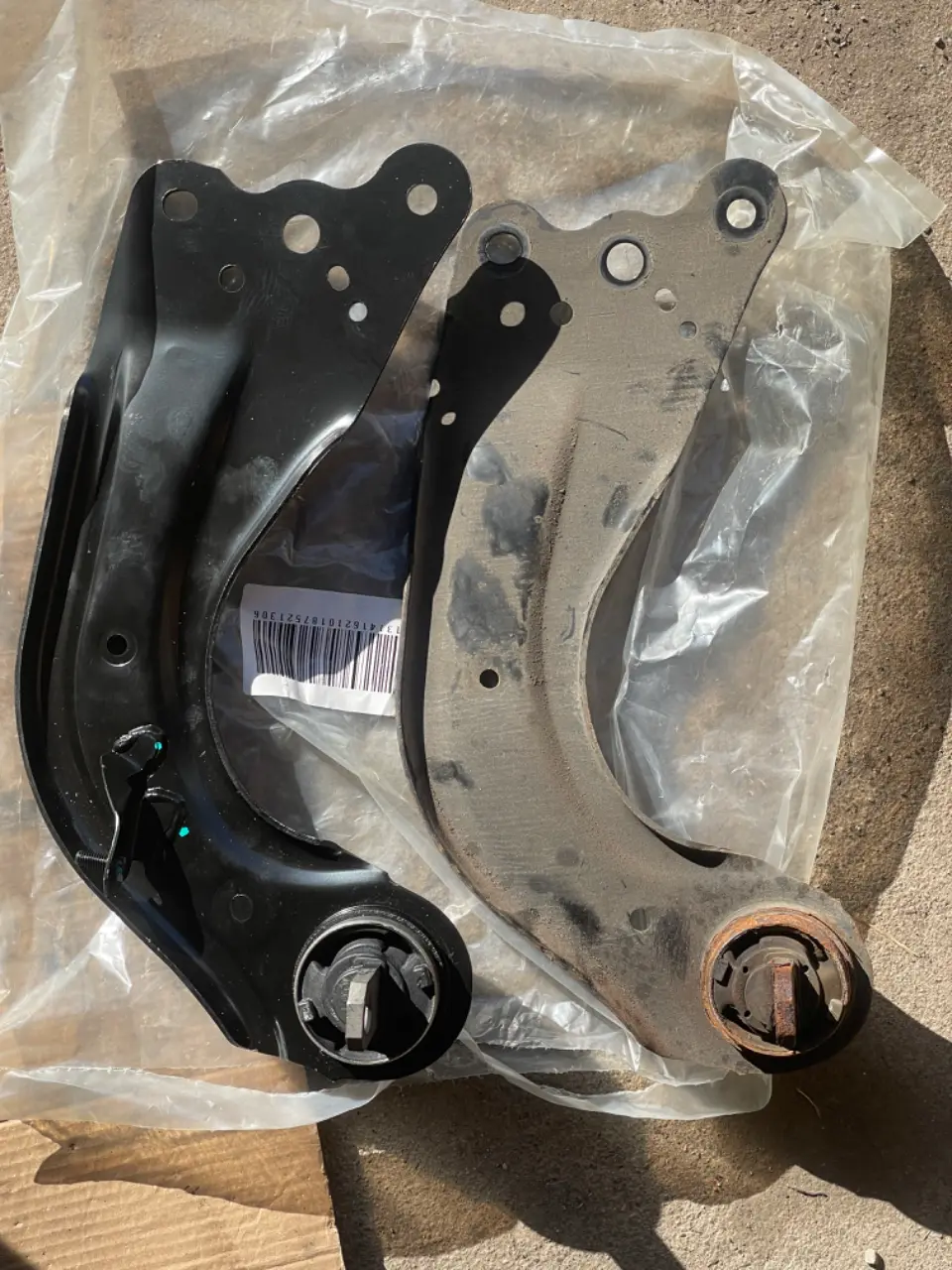

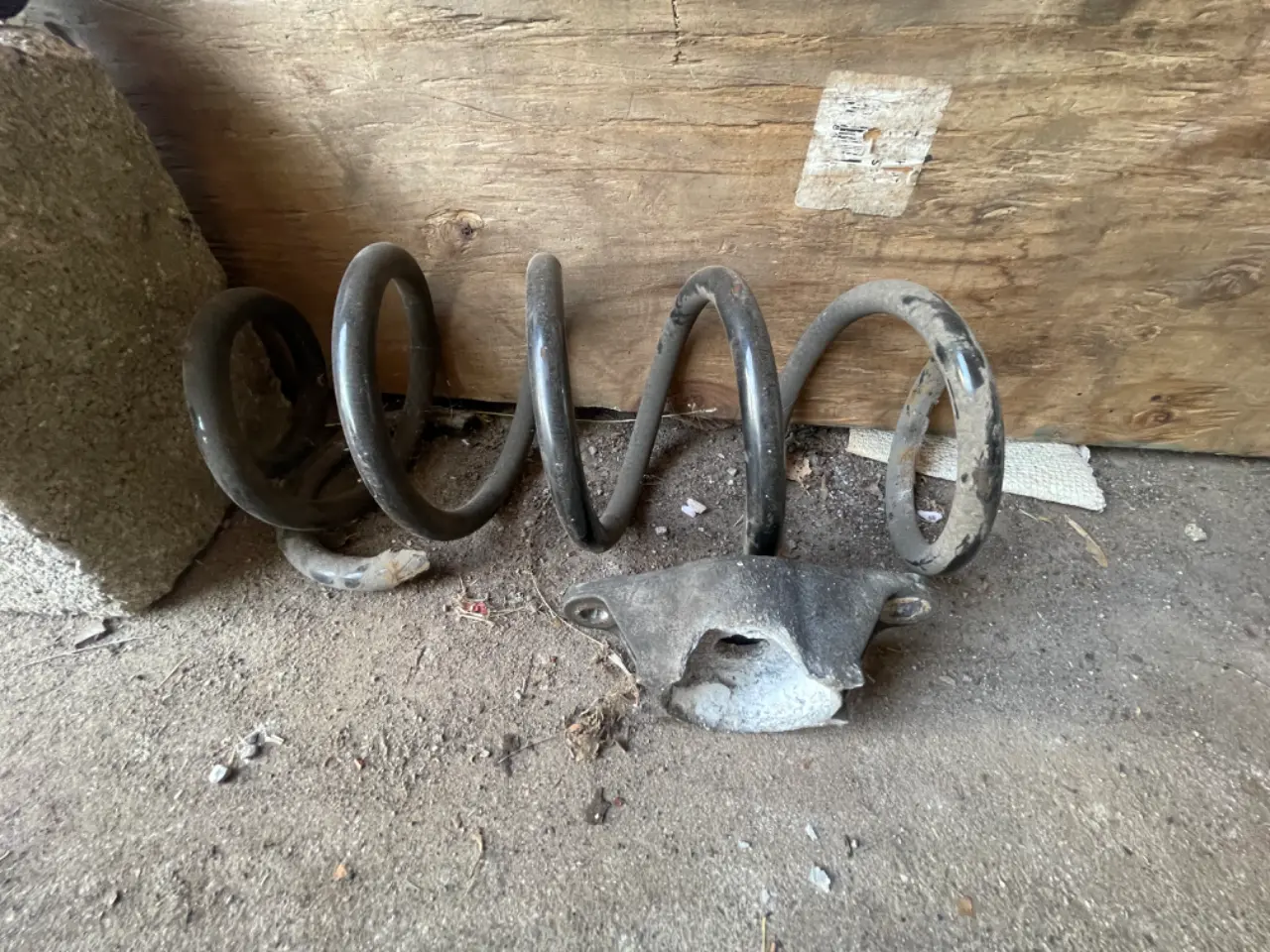

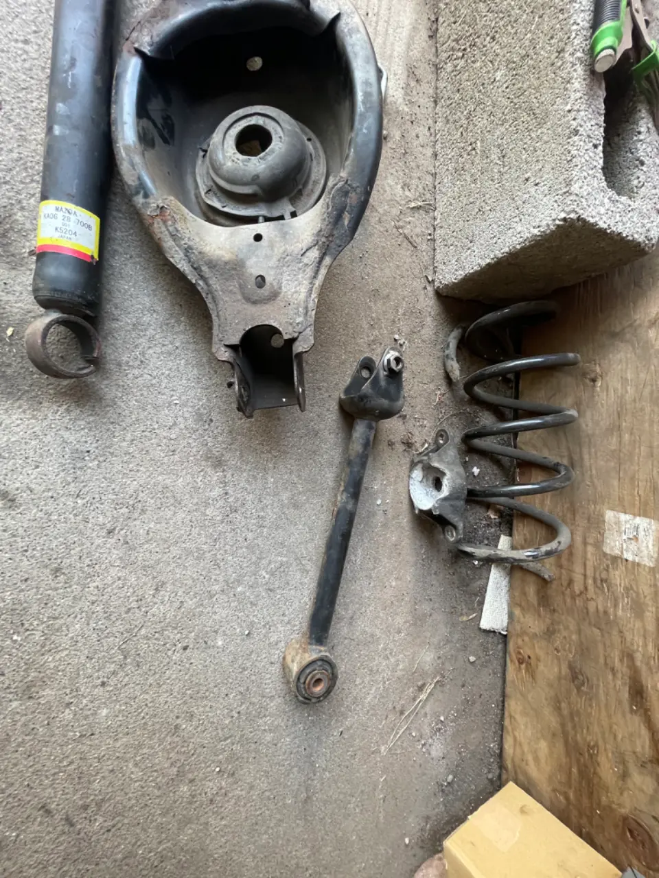

Replaced some parts on rear driver side:
- rear trailing arm + new hardware
- rear lateral arm + new hardware
- rear lower control arm + new camber kit + new hardware
- rear link kit
- rear spring
- rear shock + mounting plate + new hardware

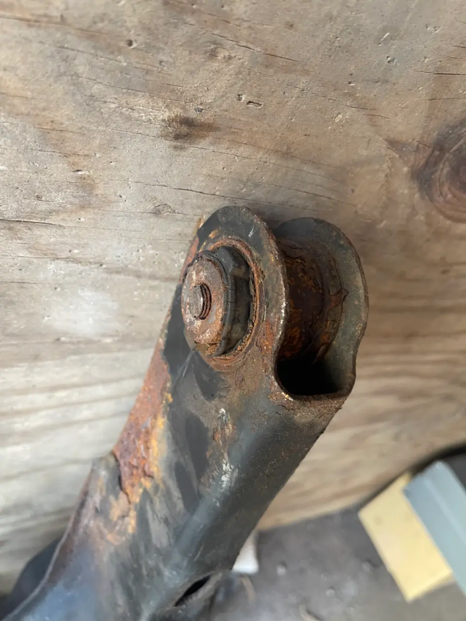

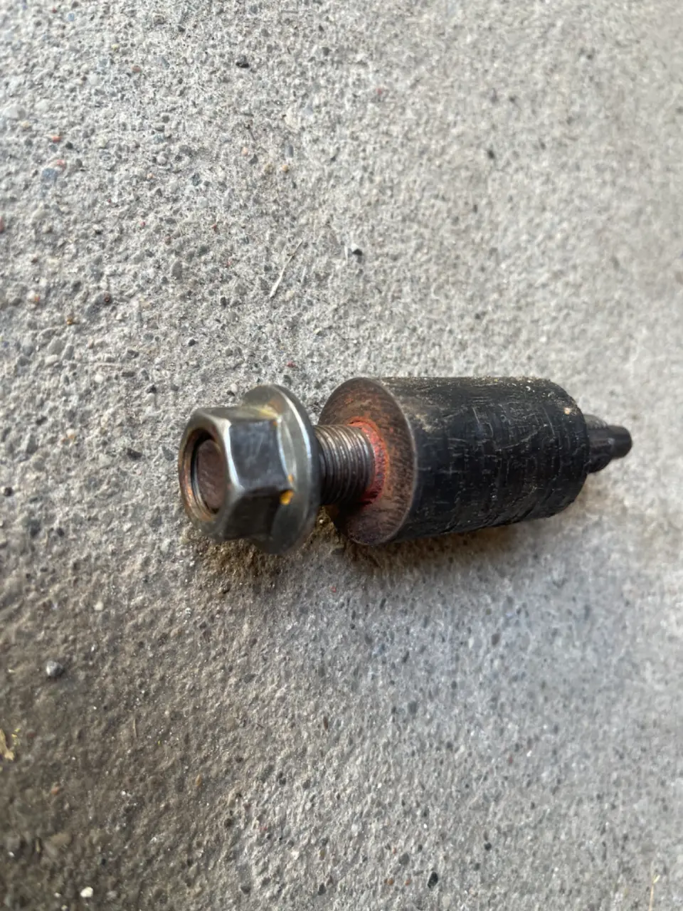

Camber bolt was seized in bushing so had to sawzall it.
Spring was broken off near bottom.

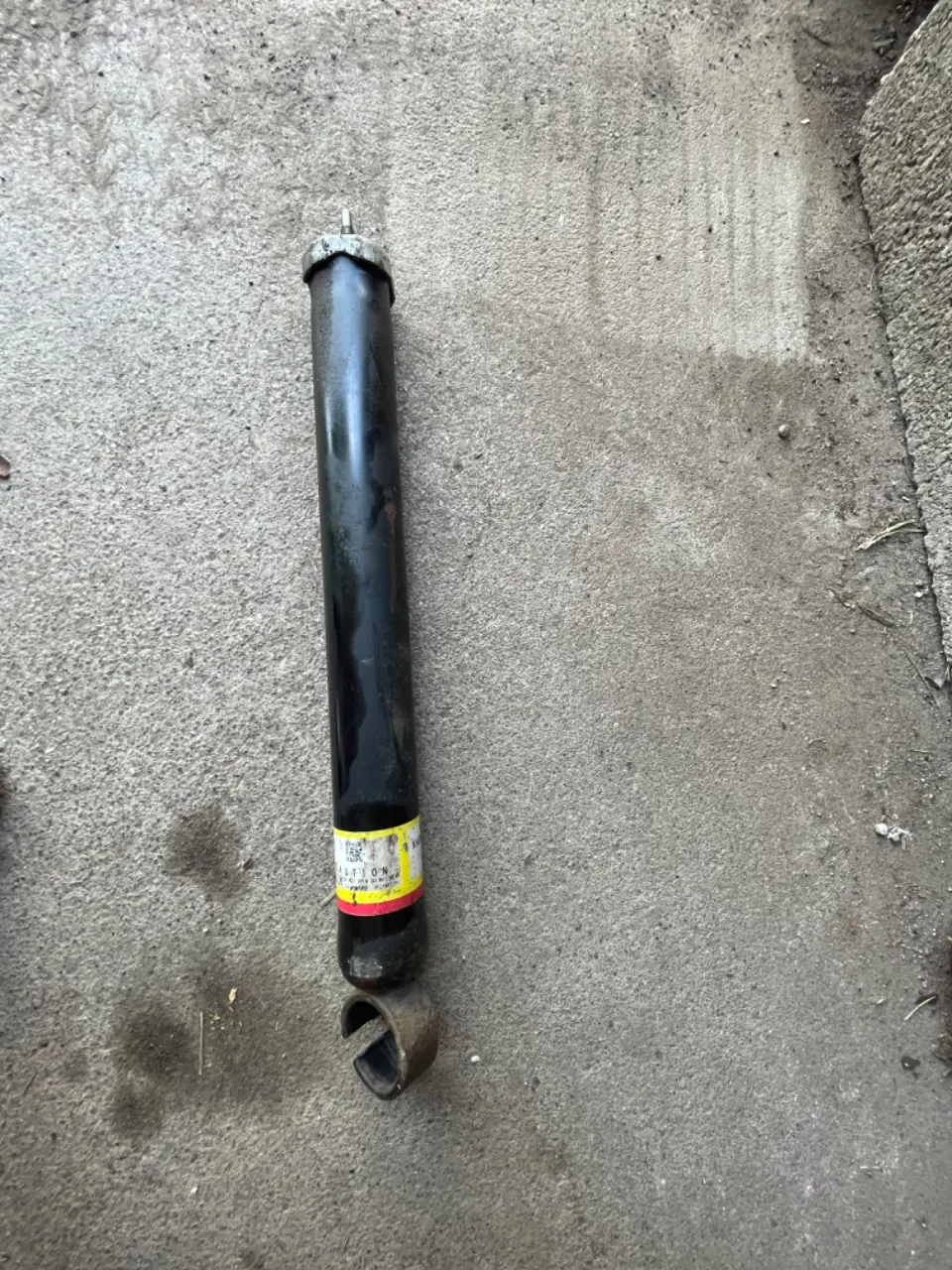

Shock bolt was seized in bushing - had to angle grind the shock and take it off the bushing, remove the rubber and take it off with lots of heat and time. Not fun at all.
Was surprised to find KA0G28700B shock — can’t find this part number online to cross reference ?
Just about 250k km / 155k mi
Passenger side is next.
