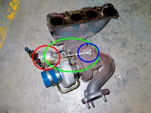

Here's a picture that could help give you a better idea. I'm not sure it's your actuator though...could be the internal wastegate that is stuck....better wait for the experts to reply.

stuck open perhaps.. but as soon as you disconnect the clip you should be able to determine by trying to rotate the little arm that moves the wastegate valve by hand.
