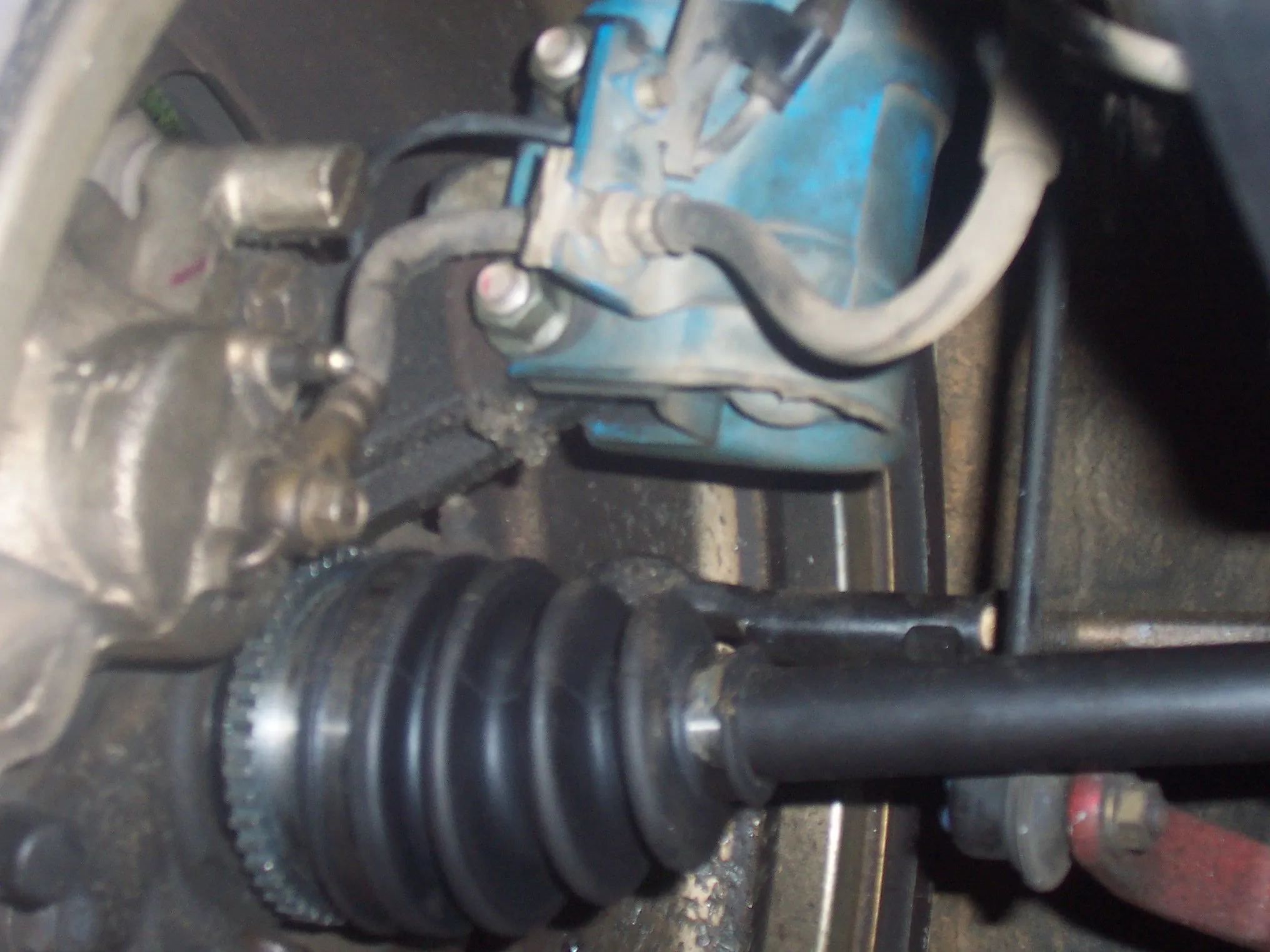

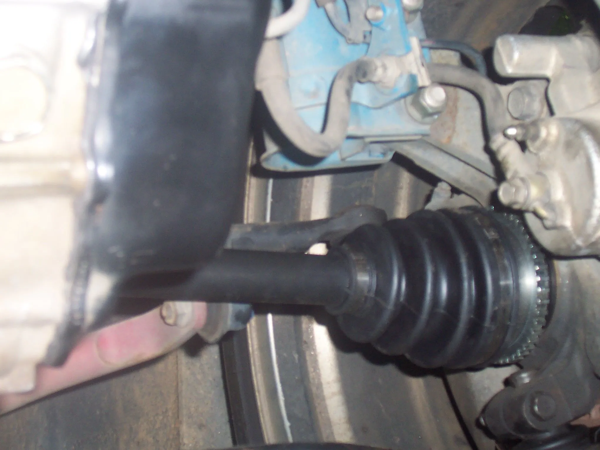

So anywayz, I got my car back yesterday. New tranny, and new driver's side CV Axle. Going slow the car is fine, but going normal speed it will vibrate the hell out of you. Full body vibration crap. It's not my motor mounts (I was thinking, since they are 95 dur), because they've been on for a while. Any ideas?
Possibly, I'll go out and take a photo of it.
New one on the left, passenger side on the right.

I mean the input shaft more so than the external color. I had it happen to me and it ruined the transaxle in another car. Not saying that is the case and I hope for your sake it isn't. Just that it could be. The vibration got worse with speed. Wrong part from supplier. I learned my lesson which is why I will have the MSPs units rebuilt when its time.
I'll call them tomorrow and make sure. One year warranty. I remember them saying it took so long to finish my car because the people sent them the wrong CV axle three times. The vibration is just like that, makes you vibrate all over the place and riding in it is not comfortable like it used to be, and it increases with speed.

Just looking at the pics that is the wrong axle. OEM Mazda only part!
