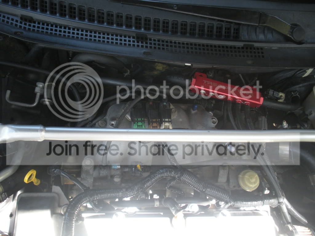

if anyone has pics of where you installed your vacumm block i would really like to see it. im going to be putting one in and would like some insight on where i should mount it.
On the brake booster vacuum line on the passenger (engine) side of the check valve inside that line.
What 3 do you have running off your block? I have the wastegate, and the bypass valve.
